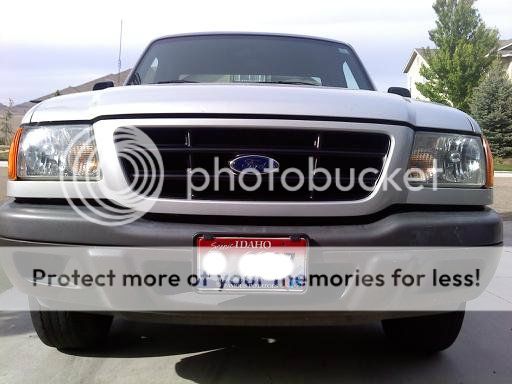

Ill paint the center grille insert black, and i am still up in the air with whether i will paint the bumper black or color match it.
here's a better list of plans I have for it:
repaint the grille black and bumpers either black or color match (opinions?)

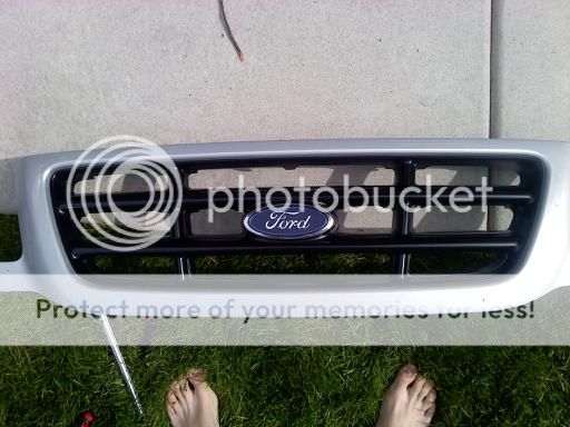

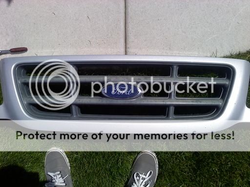

Well i finished respraying the grille, and poilished the center caps while I was at it.
Before:
after:

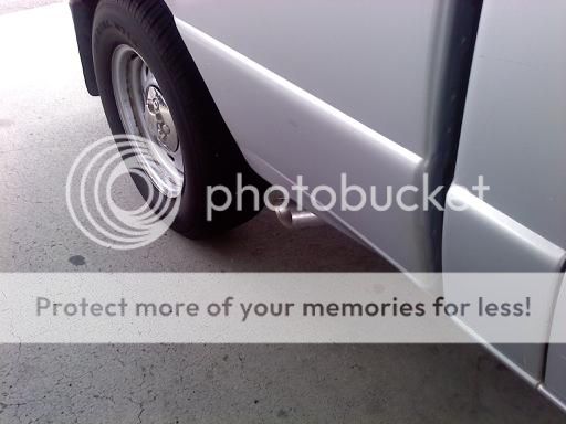

It's been a while since i've posted, i've just been busy with work and gearing up for college. Anyways About 3 weeks ago I got my exhaust done. It's basically a catback 2.5 inch flowmaster super44 with a side exit. Sounds pretty good for a 4 cyl, and it sounds nothing like a little honda haha. I also grabbed some new tires for the front to last me till the new rims/tires combo. nothin fancy.
Next I'm saving for the DJM 4/5 drop kit. I'll pair that with some nitro slammer drop shocks. Most likely I'll have to get a bolt in c-notch for the rear because the axle will be 1.5 inches from the frame with the bumpstops cut in half.
