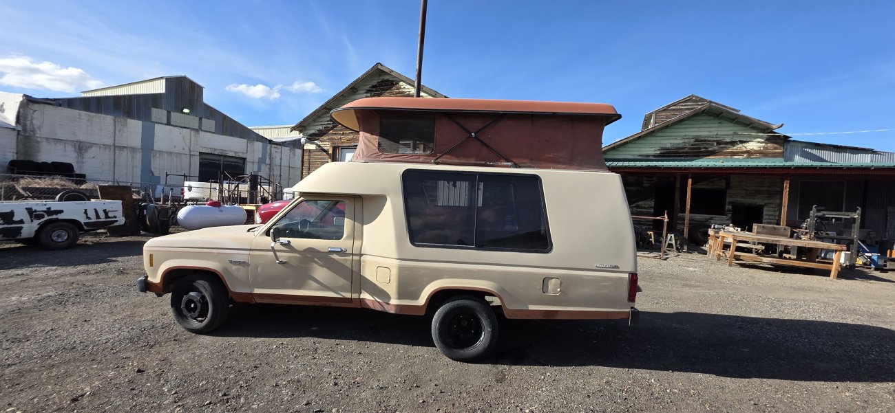

I bought this 84 roll along from another member and Im excited to get it going. Currently there are two issues that keep me from fully enjoying it.
1. Its 2x4 and needs to be a 4x4.
2. Its very underpowered.
I think im going to swap the body onto a 93-97 automatic 4x4 4.0 frame with a manual transfer case. I know automatics are hated but the cab is tight and I hate shifting when launching my Kayak on a boat ramp.
Anyone have any thoughts?
Edit: I'm swapping the cab and bed.
Im currently looking for a good donor in Eastern Oregon or Idaho if any one has a lead.

I don't really know how this thing is put together, it may be a very rare instance where it may be easier to weld the 4wd crossmember into the original frame than deal with the cut up pickup cab that is super glued to the camper body

Hello, I've never seen this set up before and would love to see some pics inside the back; is the cab a pass through to the rear?
I thought it was just a frame swap but either way I am with you, do a crossmember swap if the intention is to keep it TTB.
Dana 35 w/ 5x5.5 conversion and a full width rear axle & single tires in the rear would be pretty cool. I don't think there is truly a need for a dual wheel rear here.
This thing is just begging for a V8 swap or a small diesel... TDI and a GM automatic would be tits...
A concern of mine with my Skamper... I bet they have the stability of a wounded drunken water buffalo if a rear tire blows out.
