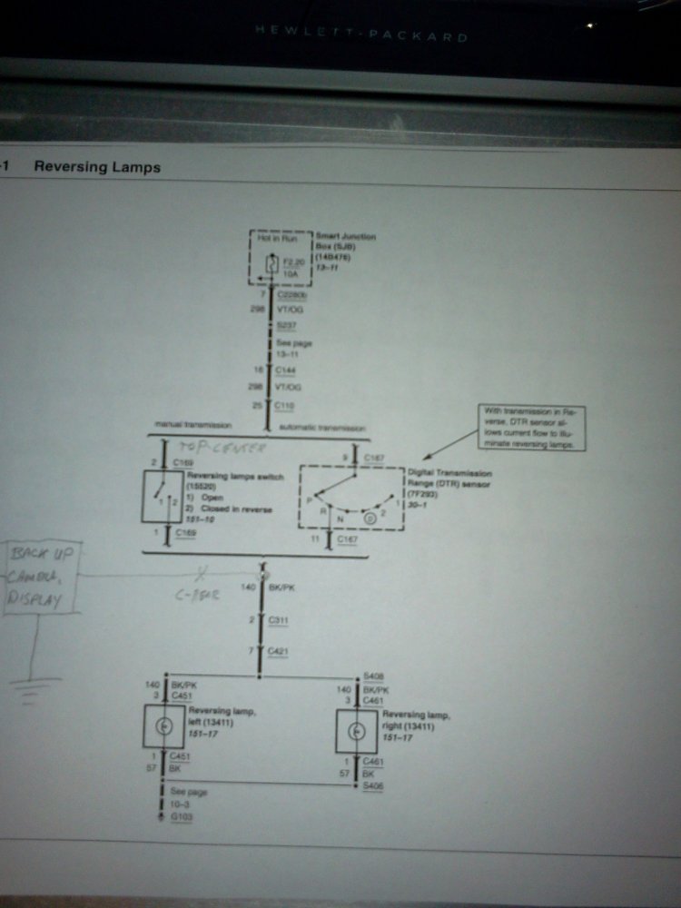

my Chiltons has the same info as yours, however, my 2005 factory manual
shows VT/OG feeding power to the reversing switch on the transmission from fuse F2.20
from the switch to the lamps is the BK/PK wire
connector C311 is a big square under the cab.
EDIT: c311 is an 8 pin round connector, attached to the frame on mine.
I'm also installing a BU camera.
EDIT: any BK/PK wire in the cab is a different circuit. the BK/PK for the backup lights exists only under the truck.
it goes from the switch directly to the lights.
can you post a pic of the BK/PK wire near the fuse panel?
if you remove the backup bulbs the circuit should be open from the BK/PK to ground.
with the connector removed from the transmission, on the BK/PK wire
you should show the resistance of the bulbs when installed, and infinite when bulbs are removed.
the other wire should be 12v to ground with key on, bulbs or no bulbs.

I think what's going on is the switch at the transmission is a ground switch.
Power from the fuse box to the light then from the light to the switch which grounds the circuit when put in reverse,
If that's the case, I have no idea of how to activate the camera by using the backup lights.
Although the schematic in post #5 shows a positive-switching circuit, if it is a ground-switching circuit in your truck you can add a relay to reverse the polarity to switch the camera on.

by the way, that black/pink wire STARTS at the switch on the tranny and goes along the frame and directly to the rear.
it is not in the cab.
only the power feed to the switch is in the cab, and it's always hot when the key is ON. book shows it's VT/OG
which matches the feed at my switch.
