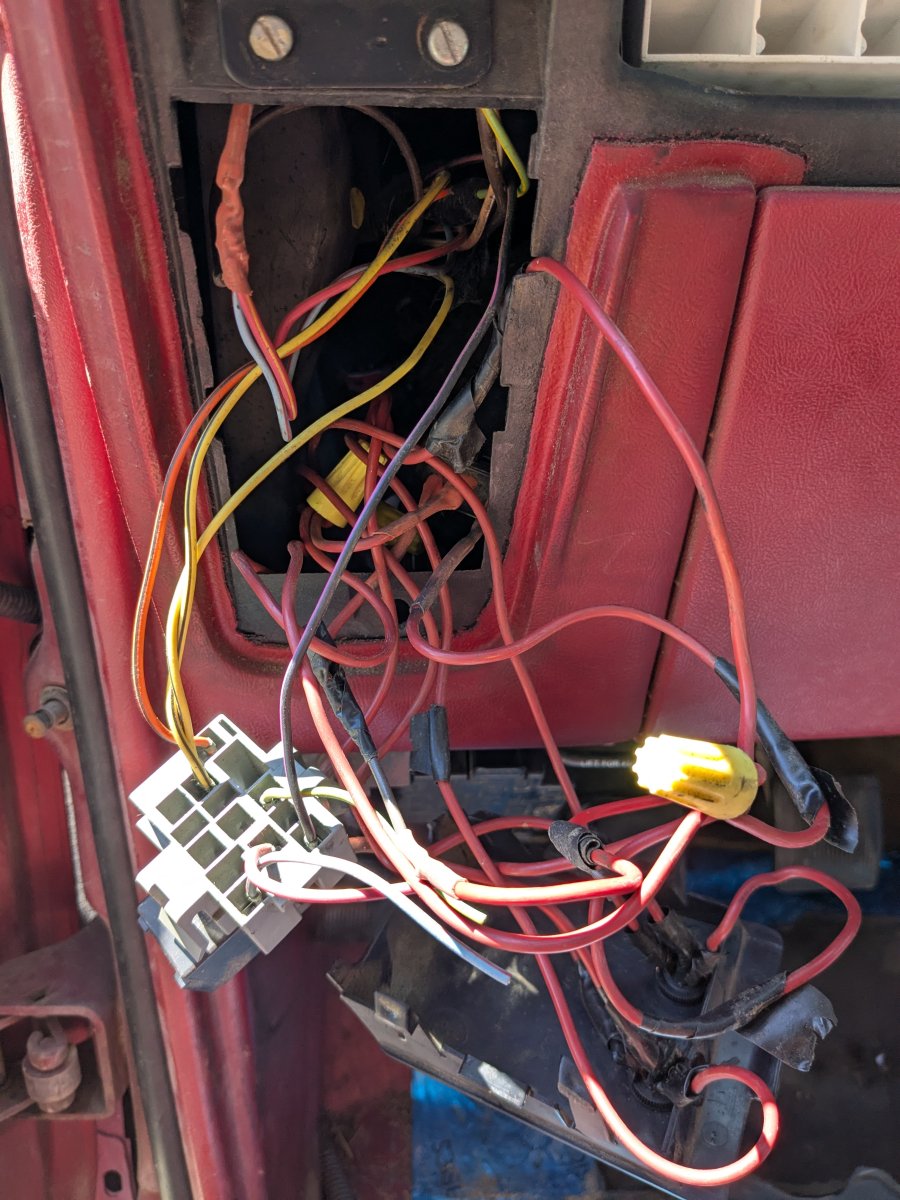

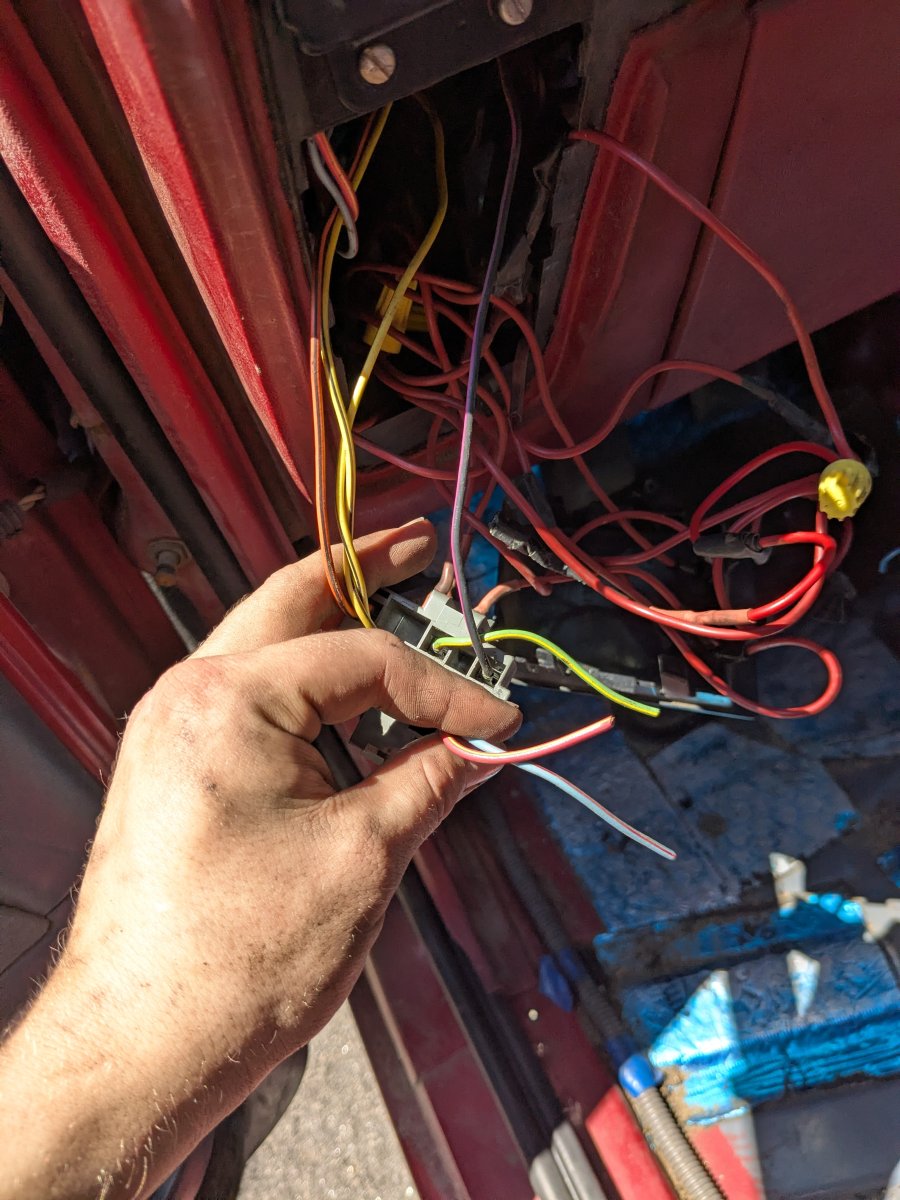

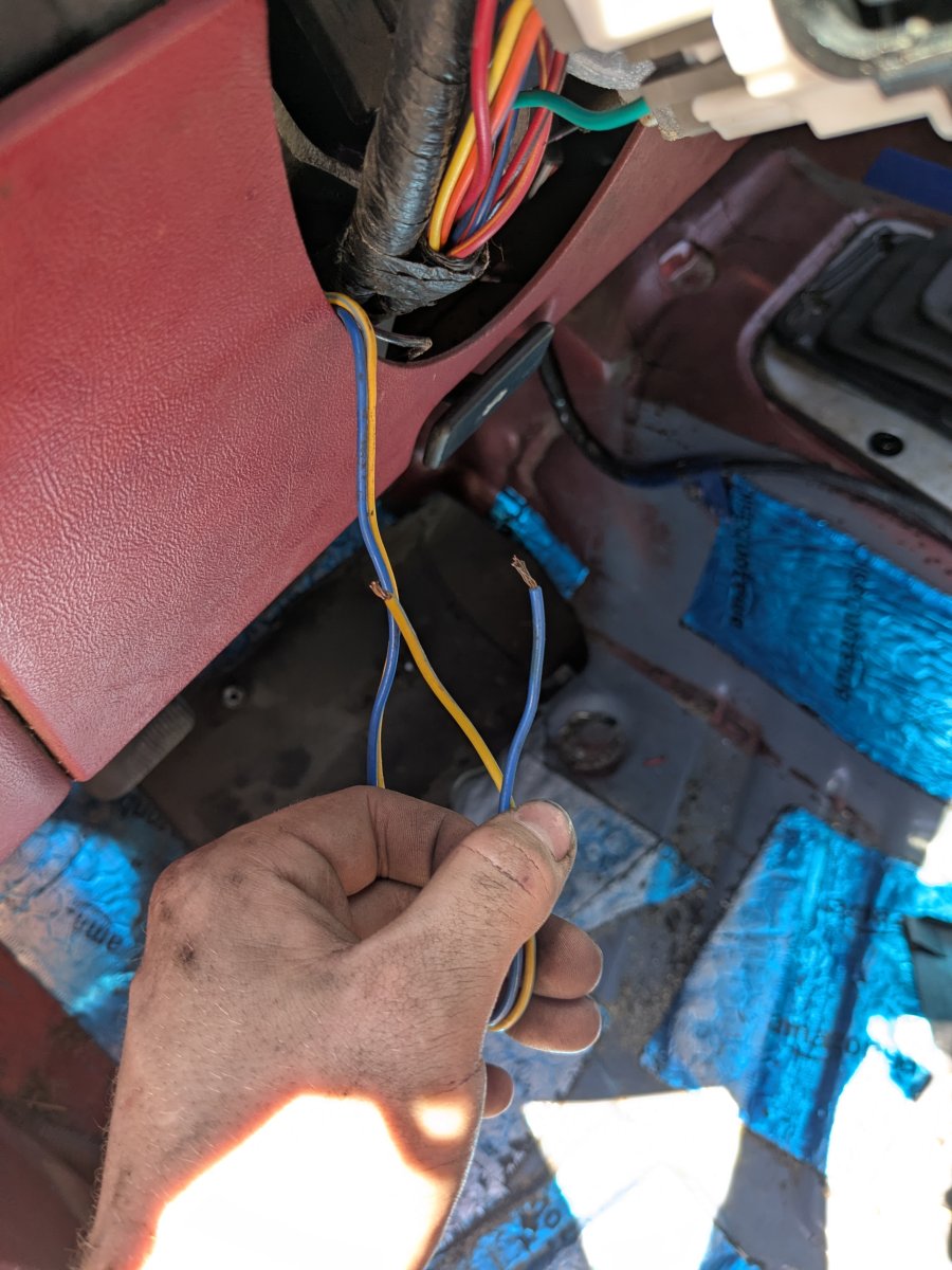

I agree. Get connectors with as much wire length as possible from the Junk yard. That makes it easier to splice things back without being too short. The wiring diagrams in our tech library should be close enough to get you through this.I'm usually very chill about crazy wiring, but this makes go WTF?
At least being lights it'll be easier to know when you've got it right.
I'd be looking at a U-pull yard to get replacement sockets and a switch with as much wiring as possible still attached from a VERY similar year model. With a little luck all the colors would still match.
