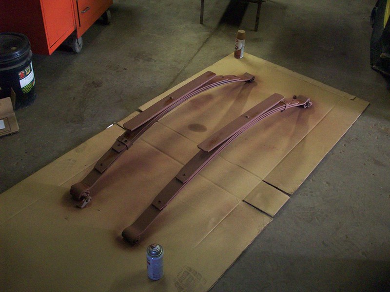

Rockauto shows a RB237 for a the rear forward on a '96 Explorer (what my springs are out of)
I need to measure them yet, the fronts are quite a bit bigger than the rears though.
Yup, looks like mine will take a RB237 and RB131
Brown springs!?!?!
Figures, they'd have different bushings in 2nd gens. The struggle is real.
