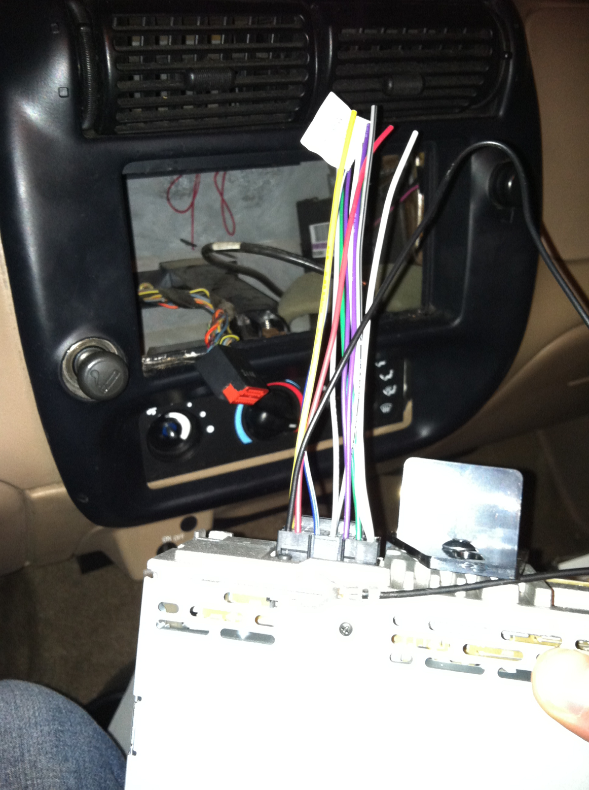

Is the wiring harness really necessary when upgrading my ranger's car stereo ?
Replacing car stereo
I don't see why I couldn't cut off the connector at the end coming out of my ranger and crimp the wires with the wires coming out of my new stereo
does anybody have a ranger car audio wiring diagram so i know which wire is what, there is one for my stereo in the box

you guys are right i went ahead and bought the wiring harness and got all the wires crimped, but now my stereo won't turn on when i turn on the car, any ideas what to look for ??
No power has to come down to fuse, ground, constant 12v, or ignition 12v. I'd check the fuse, then double check your connections. Both to make sure everything is where it belongs and also to make sure the crimp connectors are right. I personally only use bell style crimps or wire nuts on my stereos.

i'm sure all the connections are right except for the ground.. there was a black wire (the ground) coming from the wiring harness i purchased, the ground coming from my stereo had a little metal "U" on the end of it, I chopped it off and crimped it to the same black wire on the wiring harness, that could be my first problem but doesn't seem easily fixable now that I've chopped it off
If it's not that it has to be the fuse right ? How do I check those ?
Easiest way is with a test light. Ground the light to your car and then turn on the ignition. Touch the tip of the light to the small flat metal pieces protruding through the top of the fuse. If the light lights up when you touch both metal pieces the fuse is good if it only lights on one the fuse is bad.
You can also pull the fuse out and look at it. If the arch in side the plastic is broken the fuse is bad.
