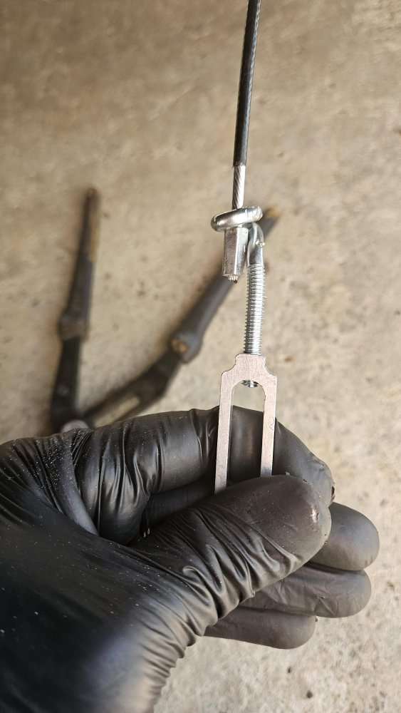

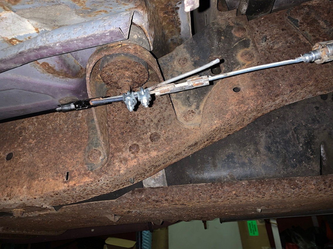

Old thread but right now i'm changing the 2 main rear cables of my parking break and is a pain . I buy the cables at "A1 parts.com" they warrantee exact fitment.Before install the cables i measure the old with the new ones and appear the same size ., i installed both cables in the drums ,easy to me but when i try to attach the cable barrel is falling short of meeting the front cable barrel there are about 3 inches of distance between cables.
...So this is the next thing to do.A friend in other forums do this.

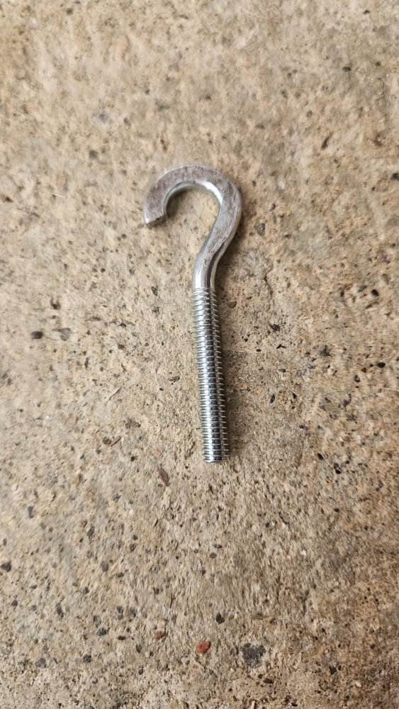

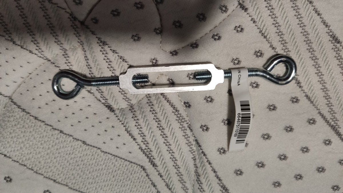

Ok, "Parking Brake adjuster", the dent wheel in the drums? yes is adjusted as the lowest possible. ..the picture i posted was by another member in other forum that use this method i'm thinking using this tool i found (Look at the picture)i think that i will use it is there's no another way.
  • Replacing all three parking brake cables
I'm a bit torn between that and one with a closed center. I'm not sure which would be better. The open one is less likely to trap moisture and freeze (and possibly split) but the threads are exposed to the elements and splash from the tire in front of it. Given that it really shouldn't need to be messed with once it's adjusted, it's probably six of one, half dozen of the other. All the adjustment, once it is set, should be with the automatic adjusters in the parking brake mechanism.
Both techniques are inexpensive you can use the one that best suits you.

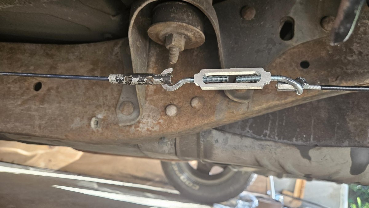

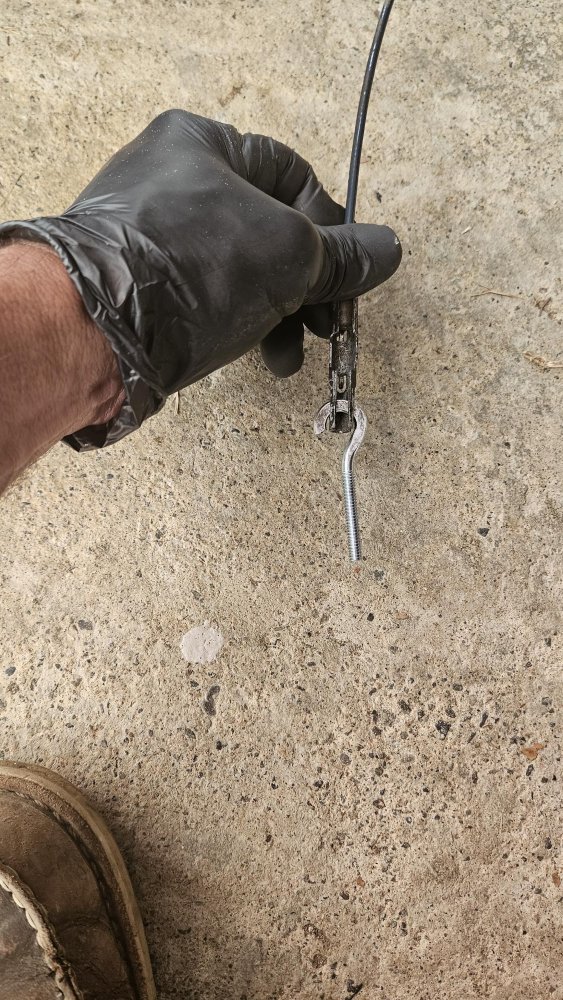

This is my final work but still needs more adjustment.
