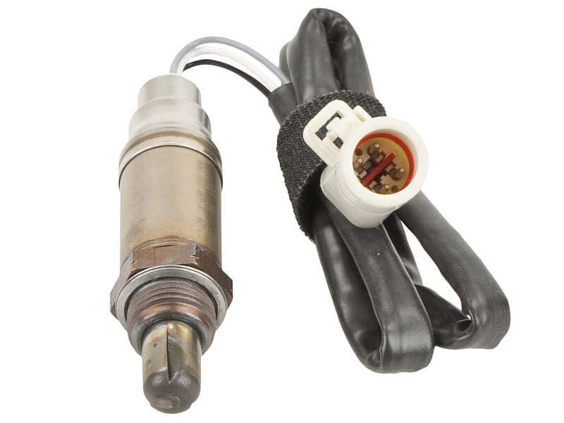

A Bosch 15719 with 24i00 0m610 Long Cable+Plug is good to replace any Ford 4WireNarrowBand OxSensor.
