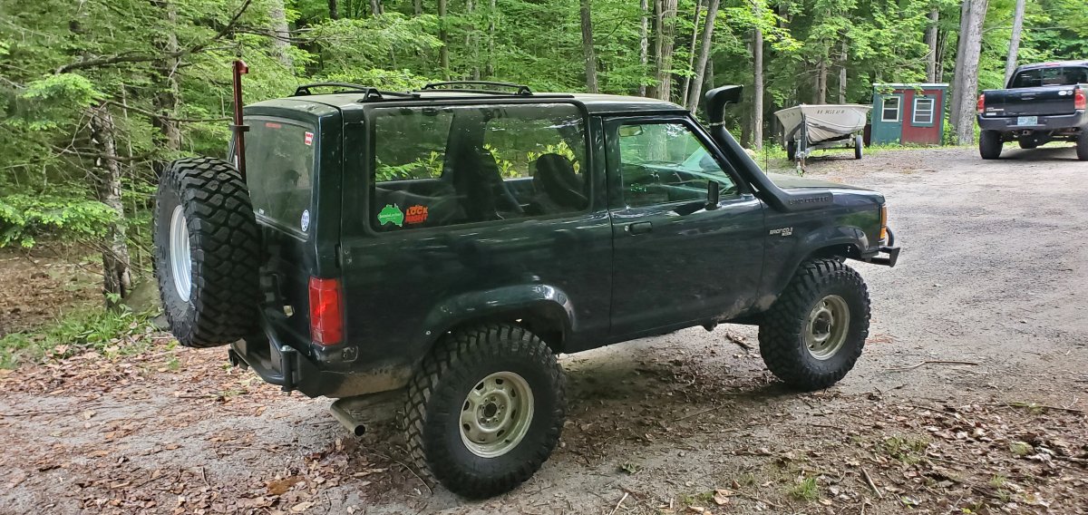

I installed a snorkel, now that is cold air lol. Shameless truck pic below...
