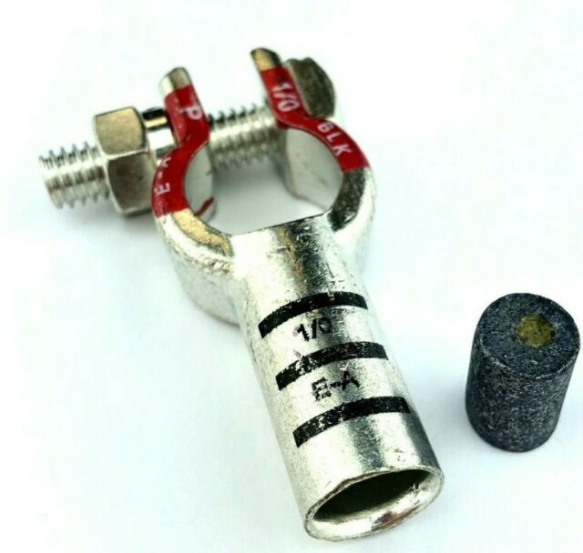

I use to make a bunch of battery cables for a fleet of dump trucks/loaders/wood chippers... and even custom cables at my dune buggies shop.
I always used the solder on lugs and would buy welding cable. It wasn't cheap years ago... probably even more now. Here is a very similar end an solder nugget to what we used.
72701
Then of course you need heat shrink... but they were great cables.

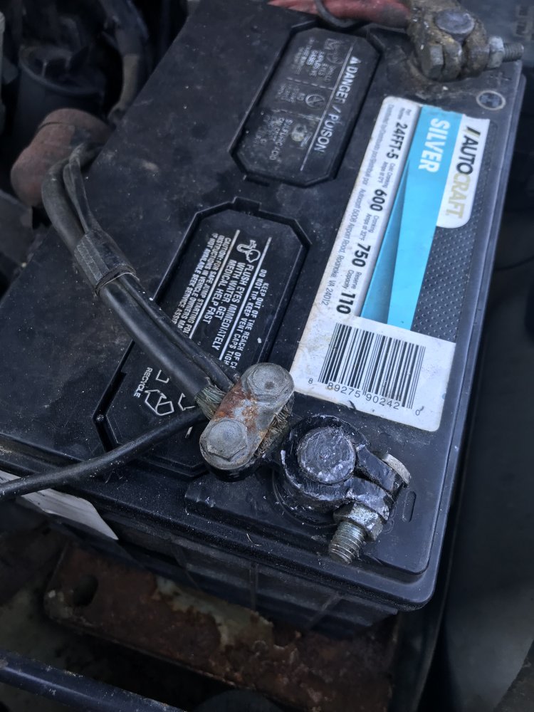

I’m a half way decent solderer. I soldered a lug on a 4awg wire twice (for an amp) and it indeed was a pita. Will have to do some research if I end up dying big solders. A torch comes to mind.
Idon’t really think I have problems past the lug (see pic). I’m just thinking that I’ll lose too much slack to get to good wire.
If you look at the cable before it goes into the clamp, you can see that it is corroded. You can see a slight bulge in the insulation, about 1/2"-3/4" long on the cable. This tells you that corrosion goes back at least that far. You would need to cut the cable, I would suggest about 1" past that, then strip and verify that there is no more corrosion on the cable. Both ends of the cable would need to be inspected.
Any corrosion on the cable degrades its ability to allow the flow of voltage/amps and raises resistance. The older the cable is the further the corrosion will travel through the cable.

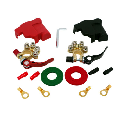

I am going to use only the finest Chinese made quick disconnect terminals on both trucks:
2Pcs Car Battery Terminal Connector Clamp Quick Release Adjust Disconnect Tool
I use Duracell marine deep cycle batteries and hook up my winch directly to the battery posts, so, I am not worried about over powering the cheap terminals. Unlike the guy on Amazon that gave them a 1 star rating because they melted when put into his big Dodge diesel (duh).
