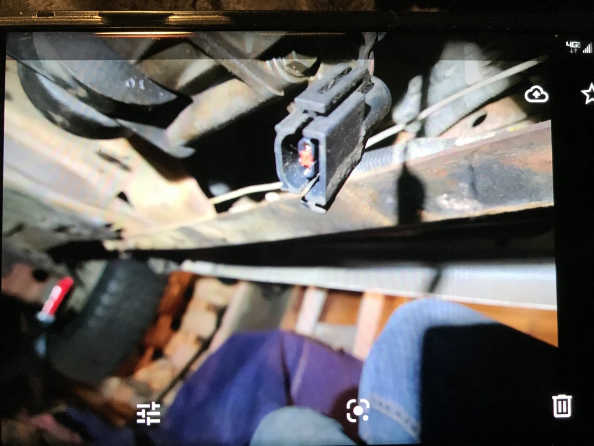

Got her started fine. Shifted into R and nothing happened. Shifted into D, still nothing happened. On the dash the O/D light is flashing, as well as the ABS light. It’s not giving me any codes, but I’ve had the battery disconnected for awhile now.
The shift cable is connected... is there a way to connect it incorrectly? I also have an extra plug that I can’t find anything to plug into. Its the very last plug on the harness. I will attach a pic of the plug.

Wow....the......shit I take for granted.

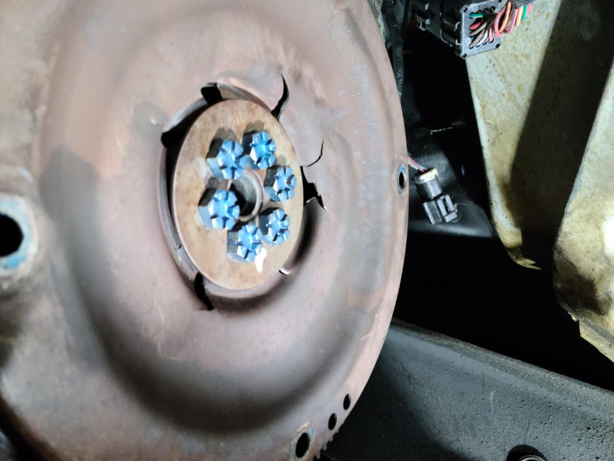

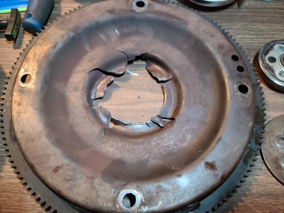

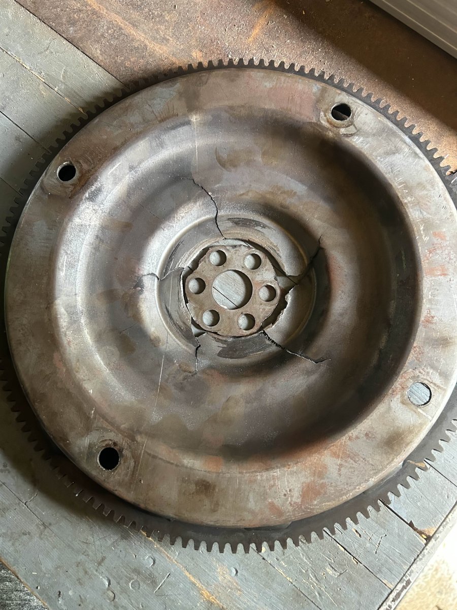

If the flex plate is broken around the crankshaft bolts, there is no need to remove the torque converter bolts.
Pic for an example.

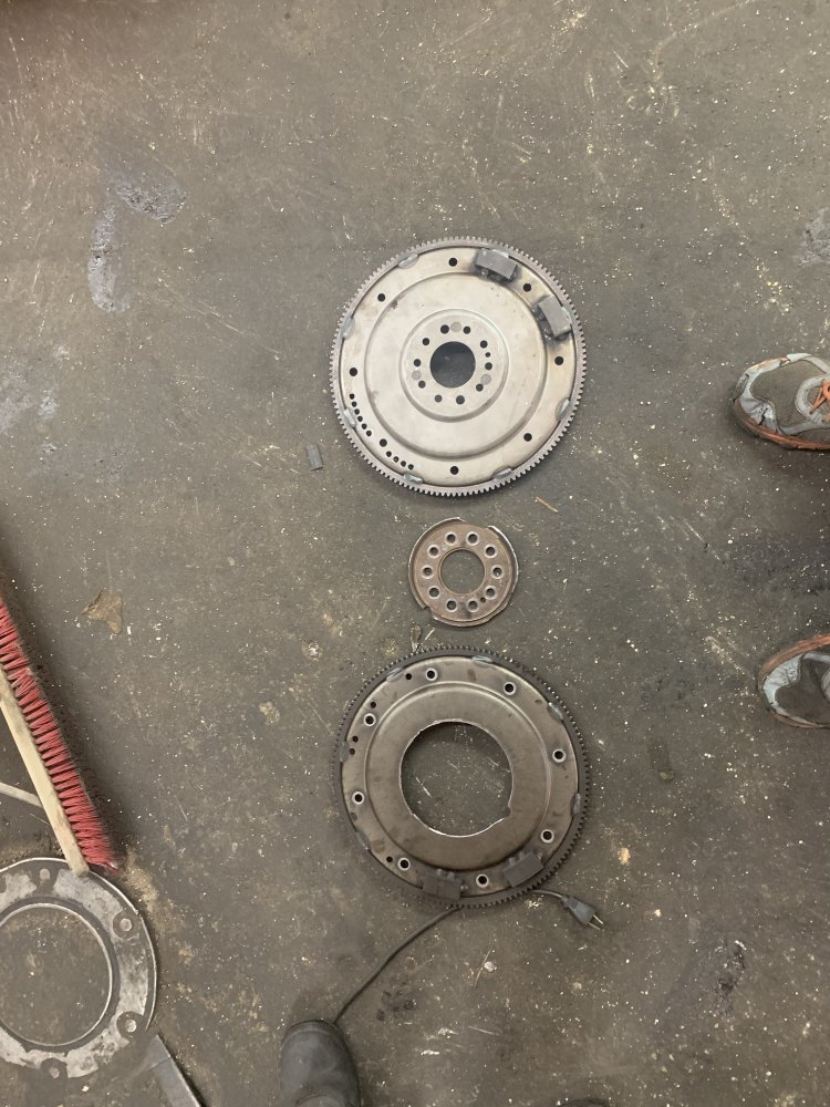

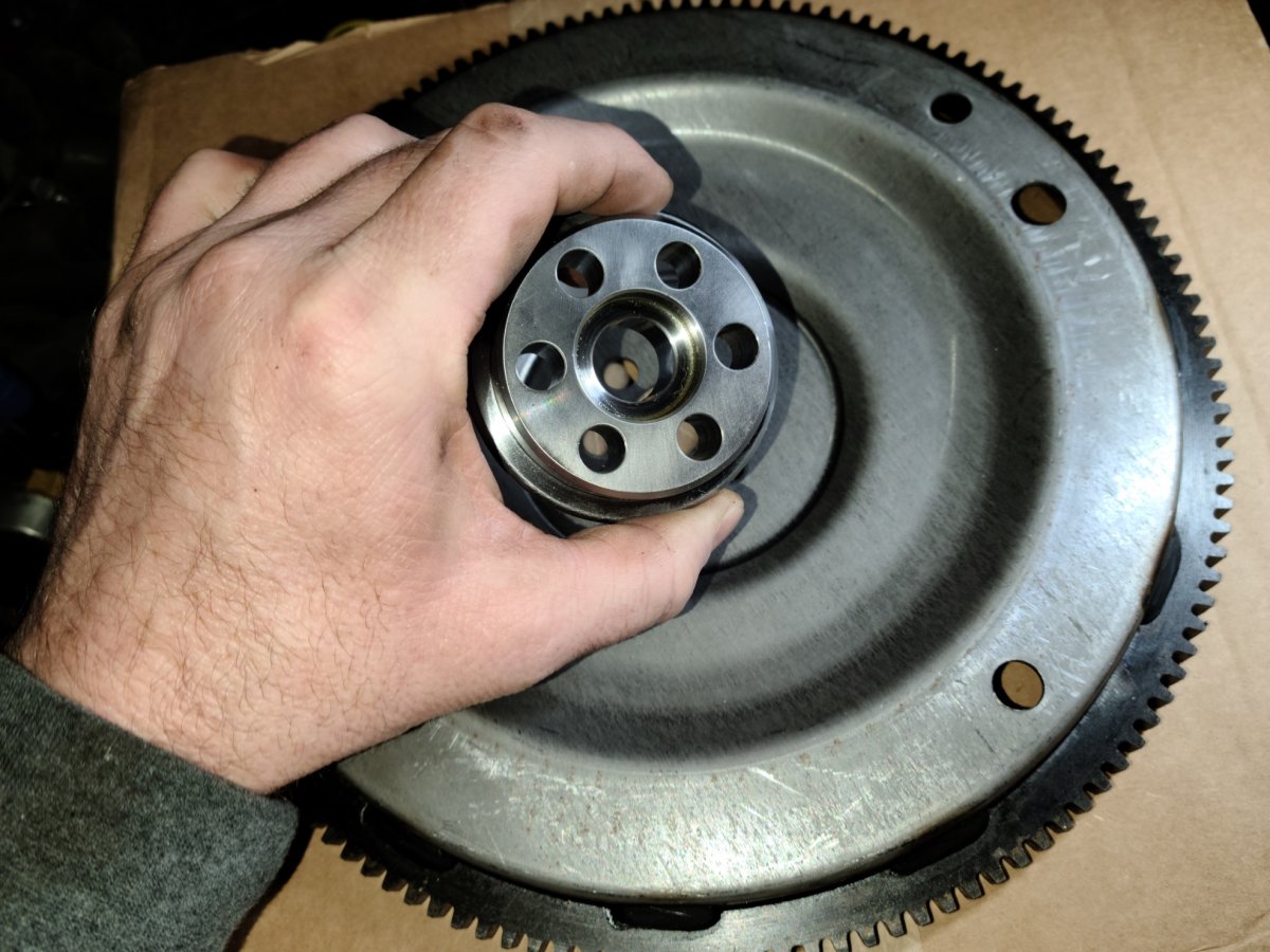

I did as you suggested and bought a new spacer when I bought the flexplate... only $16 from Amazon, Rockauto didn't have that part listed anywhere. I went ahead and bought a new exhaust manifold and Y pipe set, since I ended up cutting the old crap to get it out.

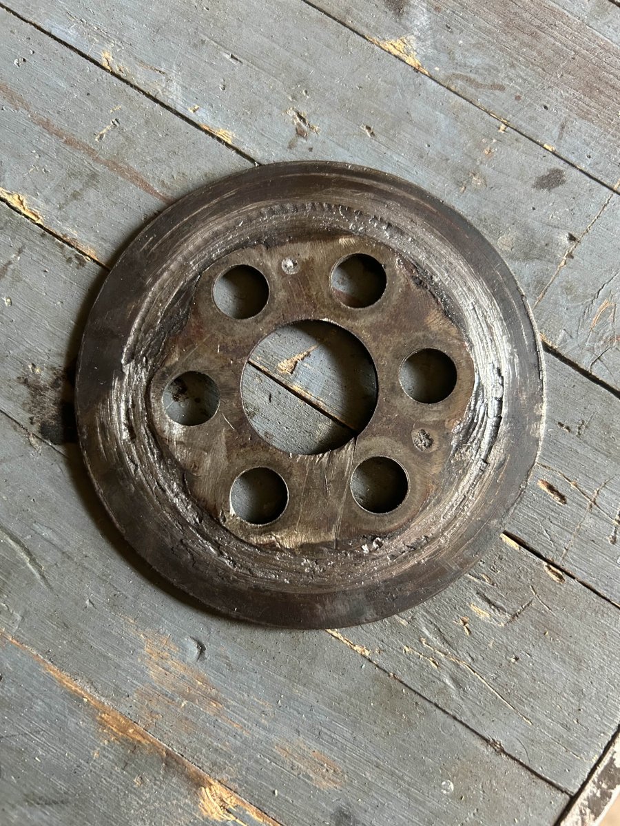

I'm in a very similar position. Sadly i didn't find that $16 spacer on amazon but, it did make me curious, did you reuse the old plate/spacer that was on the outside of the flexplate or buy a new one? The one that came off my old flexplate is too worn to reuse.
Yeah, that's probably the cheapest one I've seen, Thank you! I think I'll also need the little plate that sandwiches the flex plate and the spacer but that should be easy.
I changed flexplates like I changed my socks on one truck I had, before I gave up and converted it to manual.
Some flexplates had the washer you describe welded to the flexplate, other replacements did not have the washer reinforcement at all. From your pics, it looks like the failed plate had the welded washer. I'm not even sure that you can get just the washer, but if you find one, great.
When you reinstall the trans, make sure that the hollow dowels between the motor and trans are at the 3 o'clock and 9 o'clock bellhousing positions; these properly locate the trans to the motor.
