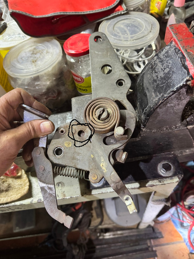

Just wanted to add that sometimes it's the mechanism itself that's the issue.
My new-to-me Bronco II seat-back gives when you put any pressure against it.
I was hoping it would be a broken bolt, but none were found.
When you press down on the lever, it disengages teeth that determine the position of the seat-back. The teeth are visible from one of the holes I've identified in the pic.
Found mine to have have significant wear, which prevents the mechanism from supporting the seat-back.
I thought about disassembling the mechanism, try to restore the teeth.
Decided against it...found a replacement pair online for cheap (will end up with a spare passenger side).
HTH
