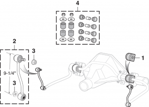

this is from LMC, it does not show the axle clamps very well.

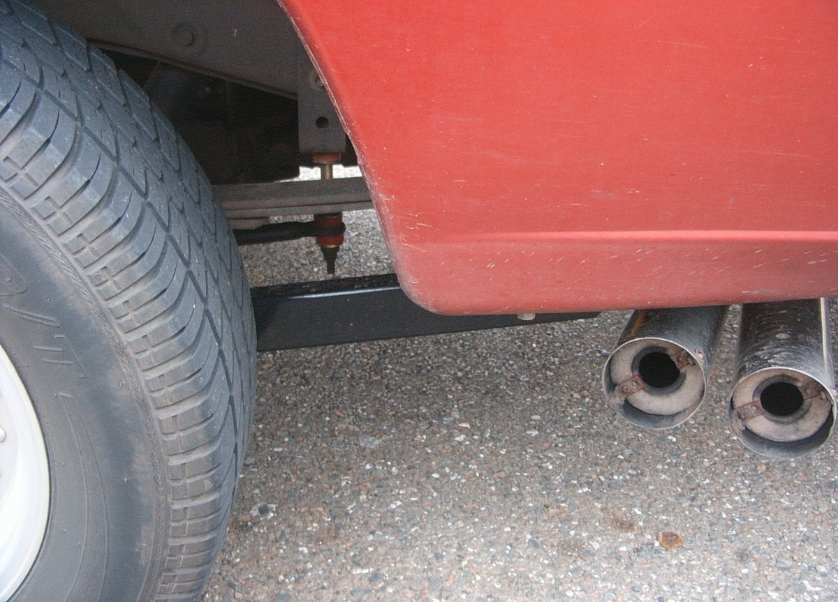

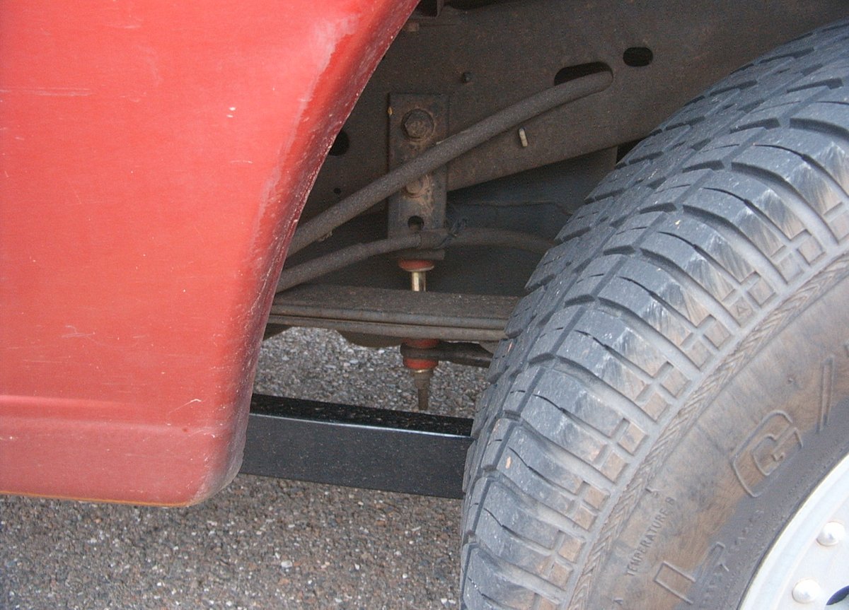

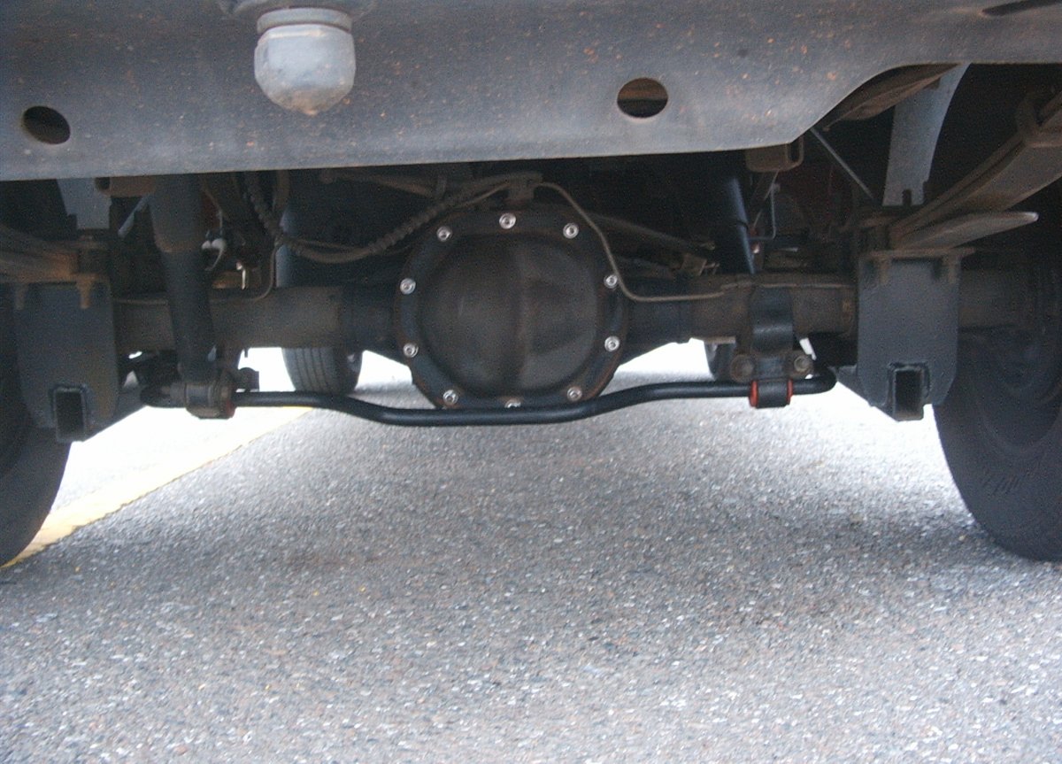

I have a Hellwig on the rear of my 98. It does not mount like the stock bar, and actually may be considerably easier. Yes, it uses pre-existing holes to mount. Also the Hellwig is thicker than the stock bar. Doesn't affect straight driving, since the bar just rolls in the axle mounts. But get going around corners, a thicker bar helps prevent body roll.
The side mounts pictured with the wheels, actually only use the upper bolt, which is pre-existing in the frame. I drilled and added the lower bolt. Probably not necessary and overkill, but that's the way I roll. The end links and the axle mounts are all Energy Suspension replacement parts. The originals were on the truck since 2002 and pretty badly deteriorated.
