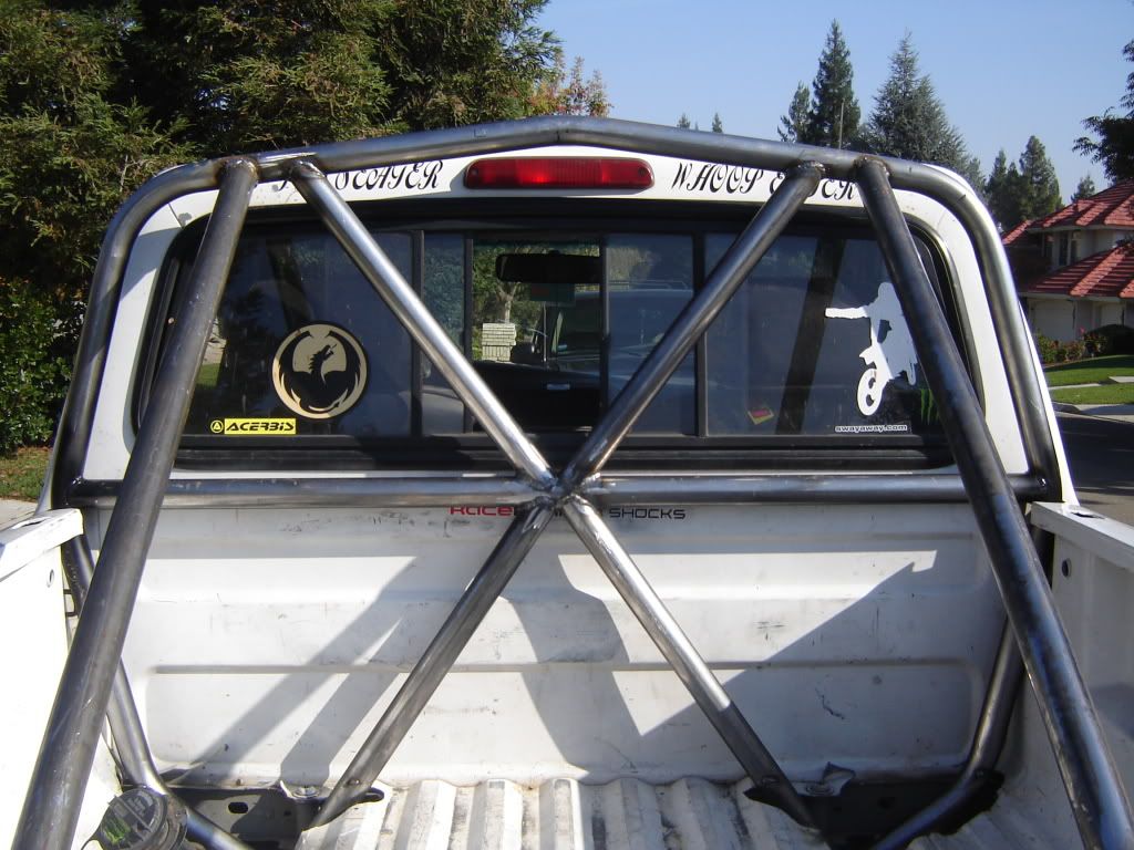

Rear long travel

your truck is pretty sick. can you take a pic of just the truck from afar.. want to see how level it is now with the new springs.. also your drive shaft looks like its at an extreme angle.. how necessary was it to move the springs forward and flip the rear hanger????
thanks man..ill snap a pic tomorrow of it sitting...moving the springs forward made it so i didn't have to drill new holes for the center pin. and fliping the shackle gave me alot more spring movement..i put shims under the leafs so the pinion angle isnt very bad anymore.
o could you get a picture of the shims too.. also how much lift did you get from this??

nice ride and nice build! waiting on pics of it leveled..
