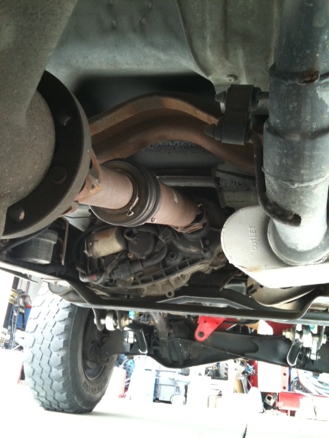

I have a 88 BII that had the CV type driveshaft. I installed a 2" block in the rear and the driveshaft blew out just taking it around the block. I went to the junk yard and pulled a driveshaft off a 85 or so bronco II along with the yoke off the transfercase and it bolted up with no problems.
i'm going to guess your driveshaft was on it's way out to begin with
Well the CV driveshaft held up but the boots are what went out causing a huge mess. Soon as I hit the first dip in the road I felt a pop and upon inspection the boots were torn from getting pinched. Being that it happend on the road I did not want to get stranded while out in the middle of nowhere so I went with a more common driveshaft just in case if I had to get parts from someone on the trail. I would rather change a u-joint than a CV boot.

With 4" of lift:
You have two double cardan joints on your shaft? Wouldn't that make it flop around like a wet pig?
Do the cheap shaft build from the link above. Its what I di after my CV busted, then my double carden fell apart.
With 4" of lift:
The shaft that you are using is not the same shaft used in the "cheap shaft build". The carden joint is completely removed and only 2 u-joints is needed, one on each end.
Try reading my post, not just look at the pretty pictures. The one on the left is the cv one. The one on the right is the double carden one I said went out on me. Thats why I built the cheapy rear shaft which is not pictured.
