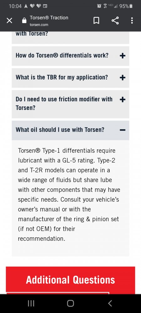

No it's not normal and it "WAS" designed for 80w90. Ford later changed their spec on ALL truck differentials past and present to use 75w140. Either fluid would work fine with a friction modifier. Check the fluid level immediately.
All of the torsen rear ends require 75W140. They will not last with 80W90. You need to be sure it has 75W140.

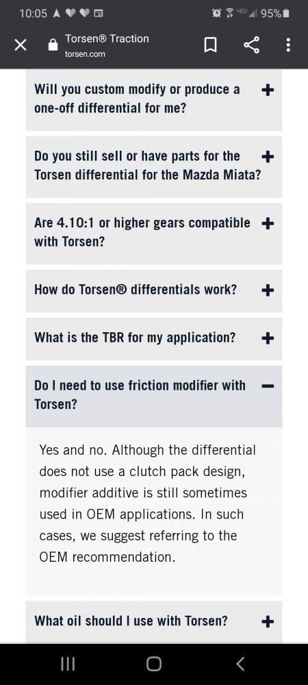

I don't know where you got this information but Ford uses 75w85 in the mustang, and Torsen themselves uses 80w90 at the factory.
It said in my manual and was confirmed by the Ford tech that the truck should get 75w-140. In both cases, the shop didn't add friction modifier. When brought up, they acted offended at the idea of using such a product
I don't believe a Torsen uses a friction modifier...

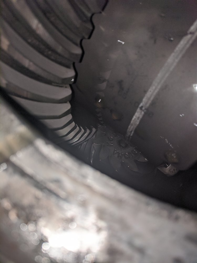

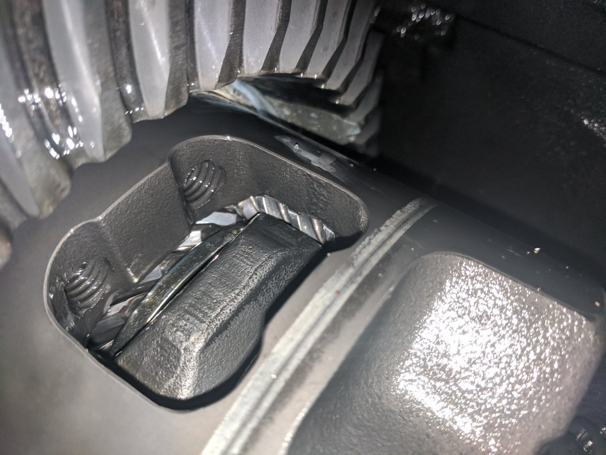

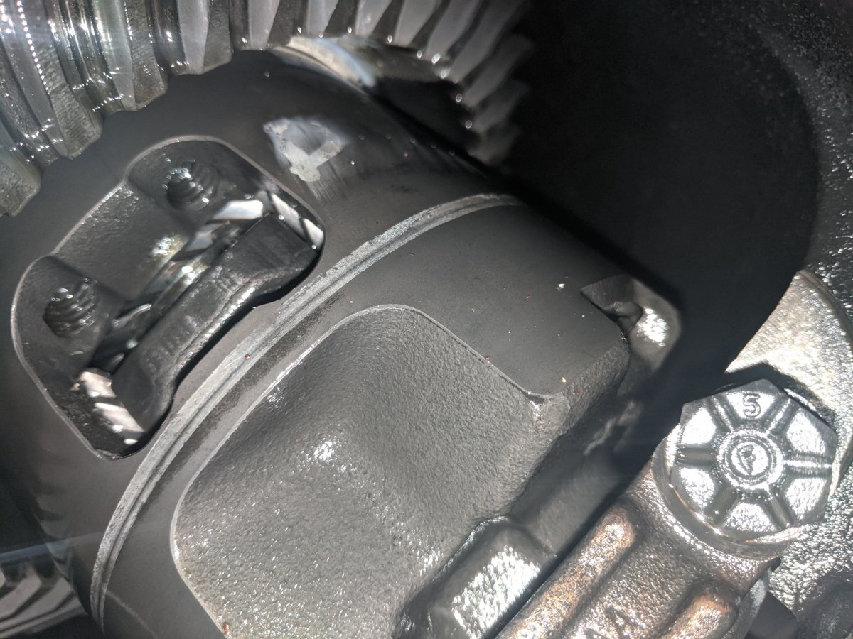

My issue has returned! The diff has become incredibly noisy over the last week. I pulled the cover to finding the oil to be very dark (moly perhaps?) Checking the magnet revealed quite a bit of black buildup. The cover was black except where the ring gear throws oil. I can say with certainty now, it's for sure the torsen differential. Not sure what to make of this wear pattern on the gears though. Of the teeth I felt, the was no scoring or apparent chipping
After much research, I've purchased some royal purple and the xl-3 (xl-3 had to be shipped) for the next 24 hours I'm just waiting for the rtv to cure. I plan on having a sample of the drained oil tested to find out just what it was they stuck in there.... Being that it started getting louder, I can only assume there's some damage
Looking at the second photo, there appears to me like some pretty serious pinion wear
