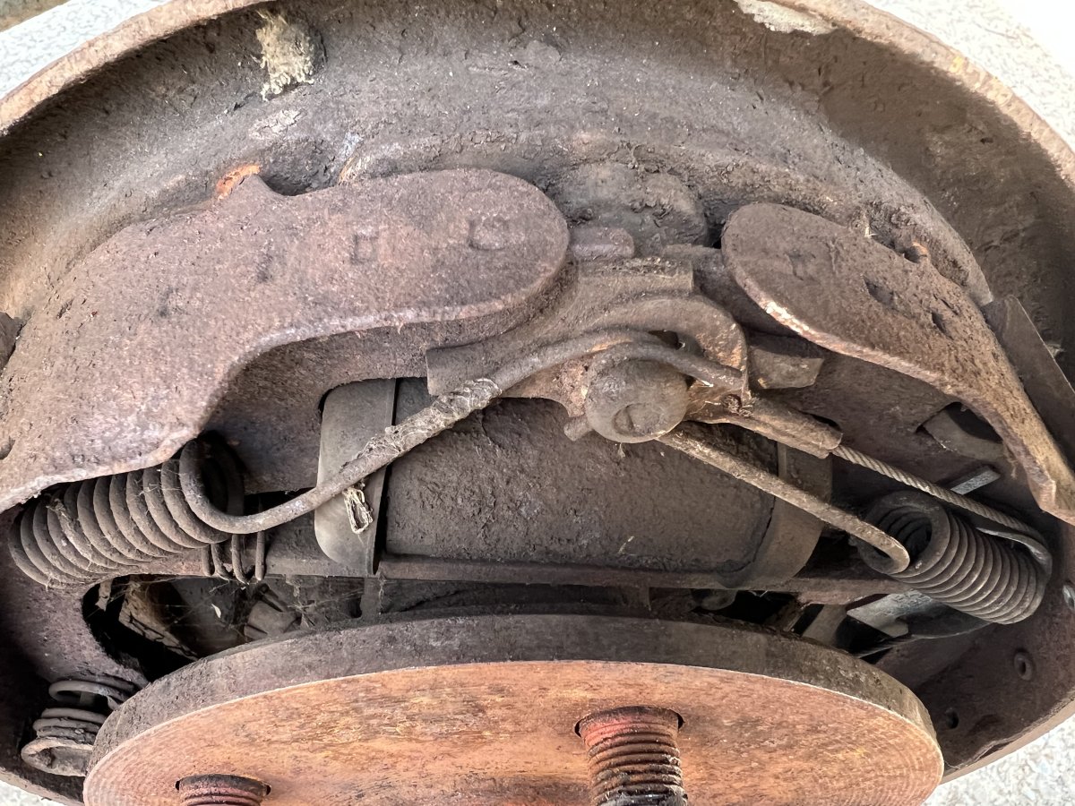

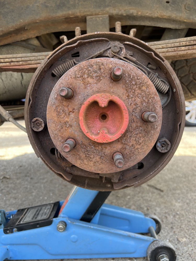

I’m sitting in the driveway working on my 86’s rear brakes and have a couple questions

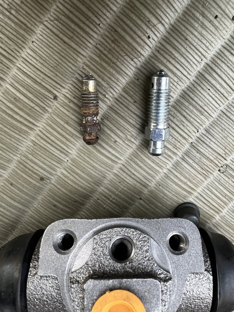

1. The bleeder is broken off and extractor is not getting it out. So bought another cylinder. The bleeder is substantially larger. Does this matter, side to side?
1b. Should I replace both sides?
2. Shoe placement. My son said he thought the larger shoe goes on the front (it’s not currently.) which is correct?
Thanks for all the help!

Theoretically you should replace both brake cylinders at the same time, same as you should replace both calipers. Brakes should always be done in pairs. That said, I, along with others, have done only one side a number of times for varying reasons usually revolving around time or money.

It was my plan to replace both but after the 1/2 day affair of replacing the first, I’m going to wait. The hard line was rusted to the fittings so I had spend an hour at autozone getting stuff to make a new line. And if that side was brutal the other will probably be equally as tough.

If you're replacing the cylinder and the line won't come out of it then it seems easiest, to just take the line out with the cylinder and get/make new line for the new cylinder.
