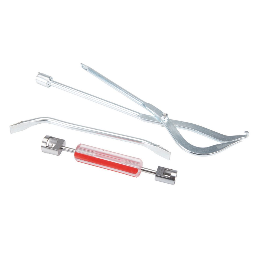

There is nothing really hard about doing rear brakes... I see some think brake tools are optional... they really aren't. Invest a few dollars in a couple drum brakes tools. They're money well spent. It can be done with a screw driver and a pair of pliers but it distorts the springs/hardware... mares the painted finish and the proper tools will save you a bunch of time and cuss words.
A set of brake spring pliers and a retainer tool will make it easier. I bought cheap KD brand tools out of a pile displayed at Napa in about 1972 and worked as a mechanic until 1982 and they still work fine. Snap On makes really nice ones if you have money burning a hole in your pocket. The ones below are $13.99 at Harbor Freight.
