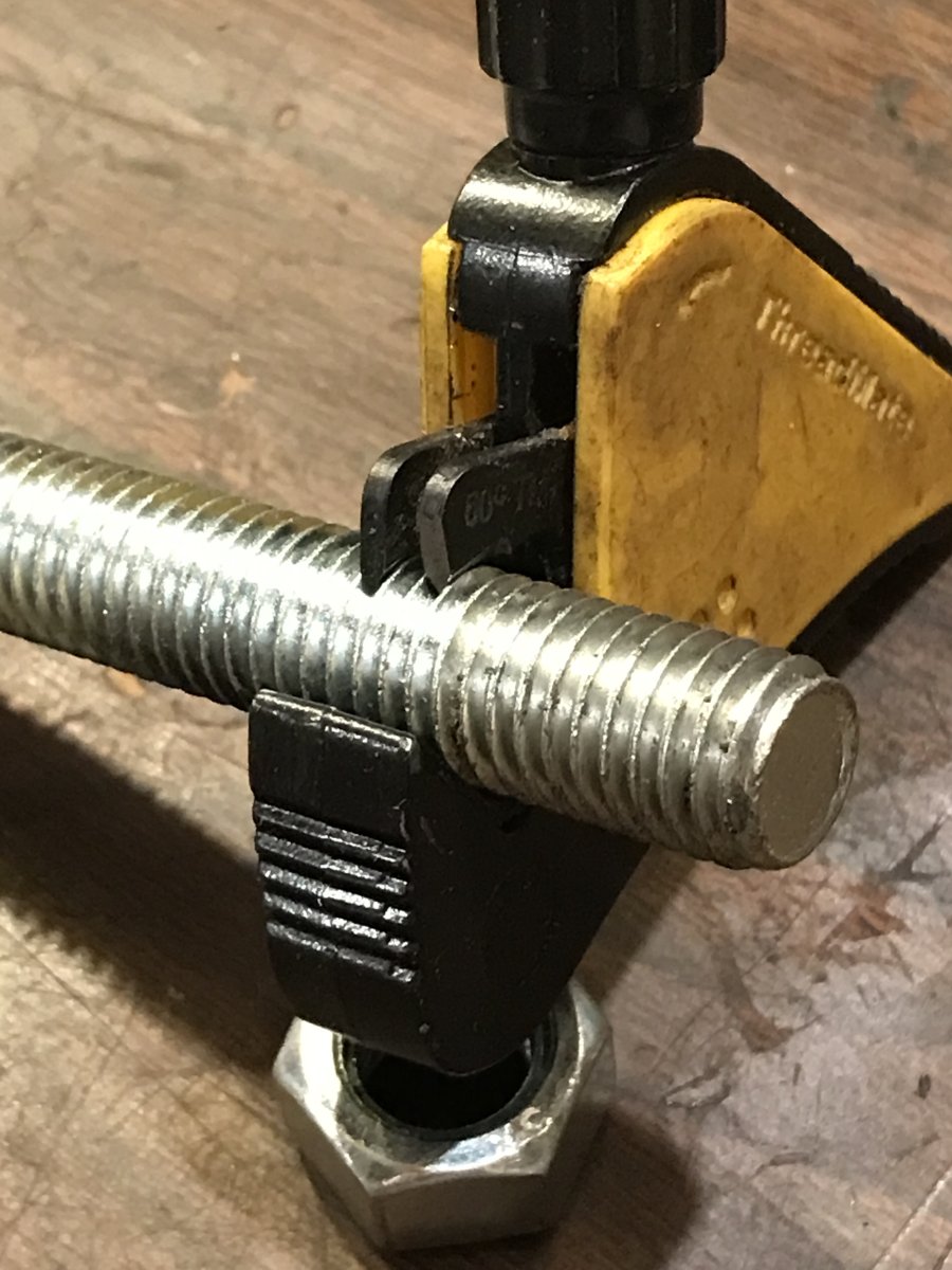

I use this gizmo for clearing & correcting threads. any thread up to 1/2" or 13mm.
