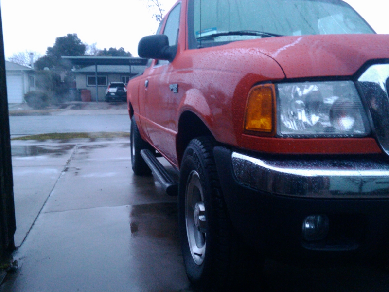

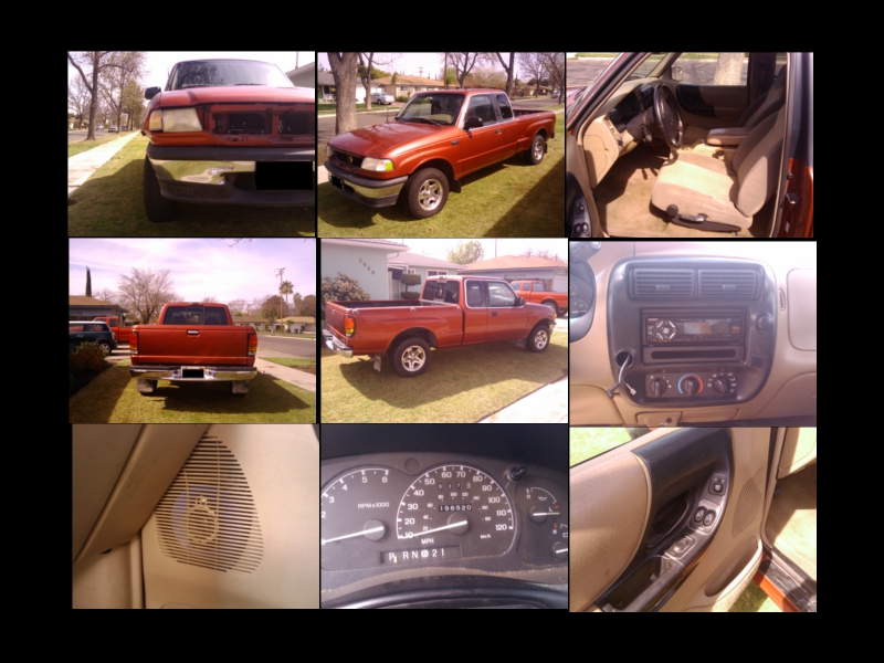

Crap...My Bad - Pics
Here you go:

Where are the pics. This thread is usless without pics, Bro!!!!
