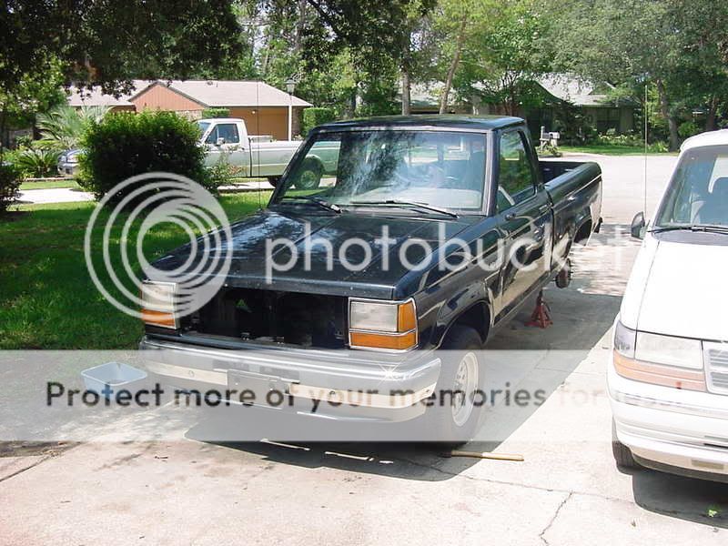

http://evalbum.com/type/FDMC
What are the specs on that motor? What did you plan on using for batteries? Speed? Range? I only looked at one other vehicle on that link, the Ranger on the top left. Top speed 65mph, ranger: 30 miles max? That's barely useful....

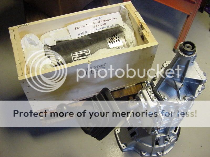

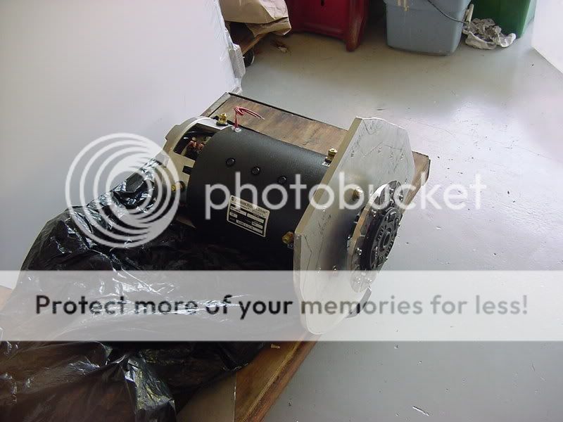

The Motor is an Advance FB4001A and compared to a gas engine the motor is about 125HP.

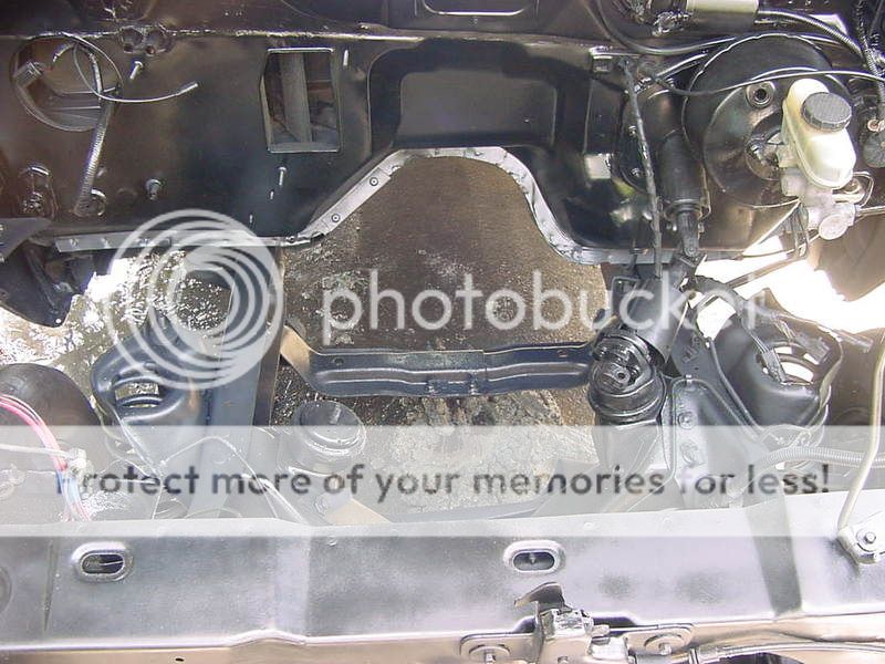

I'm gonna be using a 144V system with 24 deep cell 6 volt batteries. 4 in the front where the radiator used to be and 20 in the bed.
My expected range is around 50 miles on a charge which will get me back and forth to work (25-30 miles) and around town here and there.
Battery life and range depend on how its driven. Although It will probably do 80MPH flat out, the speed limit is only 45 between my house and work.
