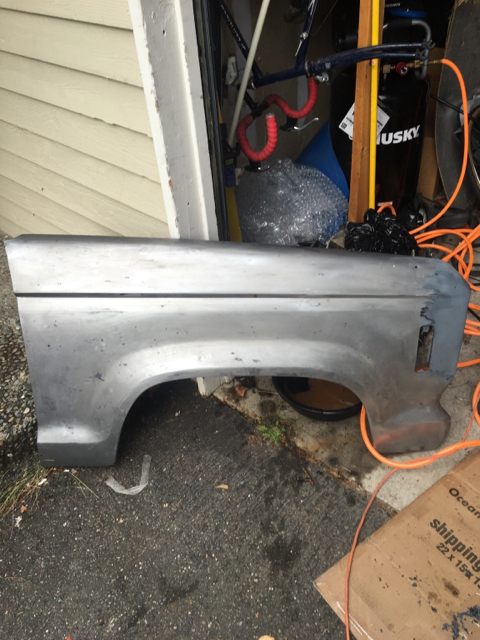

Since then I've just been preparing for paint. I pulled the fender off and started using aircraft paint stripper. Which totally worked terrifyingly fast.
