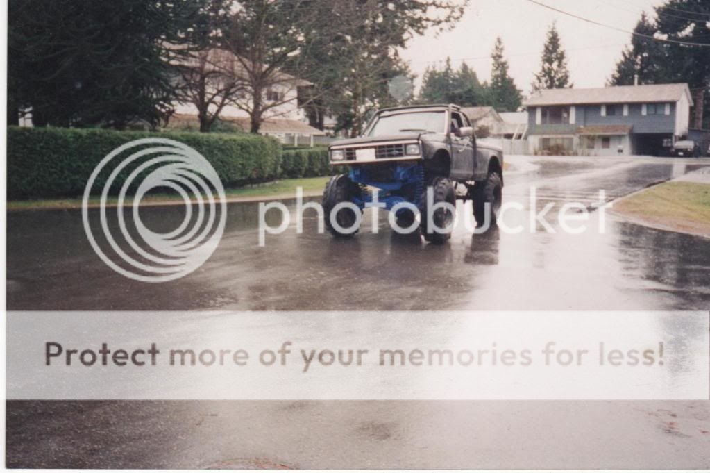

is this delta? the house that's just off shot to the right, and i'm pretty sure is the driveway you can just see, is it's address 8225 111b street delta? if so i used to live in that house!!!!!
the rest of the pics from the same time period look a lot like the same area!!!
nope....that's mission.i lived there for 14 years before coming up here.

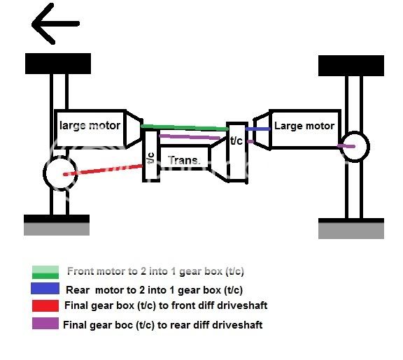

just curious, your first description of having the 205's facing forwards and backwards confused me and i was thinking 205cui motors, any thoughts about running 2 motors, one rear facing in the bed, and one forwards facing in the engine compartment, running into a transfercase's outputshaft (which would work as a 2:1 gear box) and then into a transmission from the input shaft, and then to another transfercase out of that to run the axles? kinda like this idea:
(i'll edit a pic in here in about 10 minutes once i draw it)
this was discussed in the gt thread,actually.
oh really? i didn't see that part of the gt thread...
the only problem i see with the dual transfercases is one of them would be 100% counter productive... as if you put it in low range, it would technically be super high range, as it's backwards, and the power should be fine, as long as the gears them selves are turning the opposite direction as normal... i haven't worked out the aveage speeds (highway) for the driveshaft on a normal vehicle, but i can't see it being that far out of spec of a motor, being most transmission's 5th/od gear is less than 1:1
this is the least of the problems.the bigger issue is that one of the motors would have to run backwards,since they are facing opposite directions.
wouldnt the 2 motors bind against each other? as they are facing in opposite directions. you would have to run it both in the same direction which just means another tcase in there
Should be a simple matter for you
face them both forward and run the rear engine from the front of the crank maybe
don't the 2 driveshafts in a normal truck turn opposite directions? then because the differentials are facing opposite directions, they both turn forwards? maybe i'm thinking this wrong...
this is what i've been considering for the past little while.
call it mind games,i design stupid stuff down to the last detail in my head while doing other things that don't require full attention.for some things this will go on for weeks or months.every now and then i build one of these things.
that's exactly it.since the diffs face opposite directions,the opposition in direction of the driveshafts(as viewed from the diff input)is corrected.
