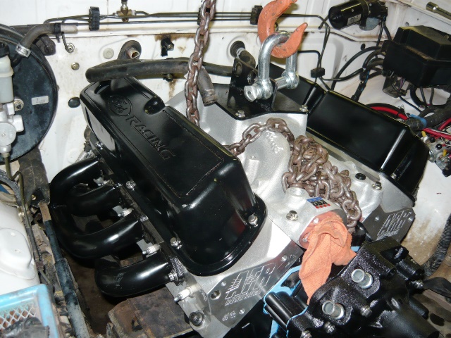

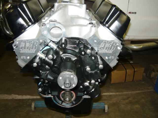

This baby is slowly moving forward.
Keith Black pistons and Eagle rods to floating pin done.
Crank and rotating assy balanced.
Now to have this little 302 installed in the right place:icon_welder:
The crank was crying teardrops just had to do it.

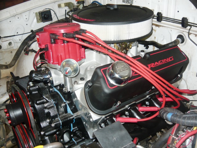

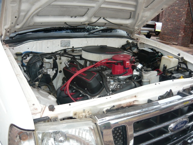

Ranger 2 up and running. Love that slick shifting T5.
Battling to keep the revs down for the run in.:D
Stock looks the only hint, the bigger rad.
