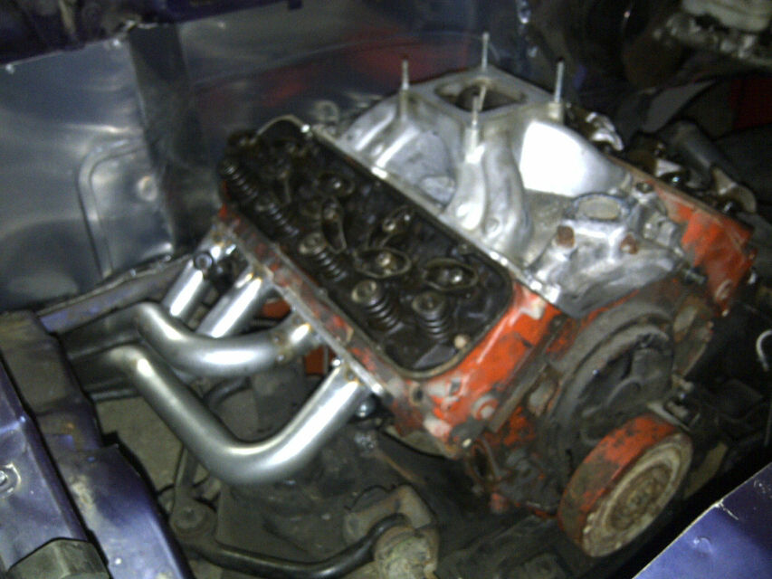

Update on the truck: The driveshaft is back together and installed. The new camshaft is in the running motor which should be going in this weekend. The headers are coming together as well. Have all the pipes tacked and some of the joints tigged fully. Need a couple more hours to finish welding these. Also I have been challenged by a few friends to have it ready by next saturday (9/27) to race at Grudge Wars in london ky. I leave no challenge unanswered so me and a buddy are busting ass and spending money like hell to get it ready. Lots of work still left to do but hopefully I will have the remaining parts tonight and out running test and tune next Friday (9/26). I probably wont have the time to swap in the 8.8 with 4.10's and a t-lock but I'm gonna weld the stock 7.5 with open 3.73's and hope I don't get a real hard hook lol.

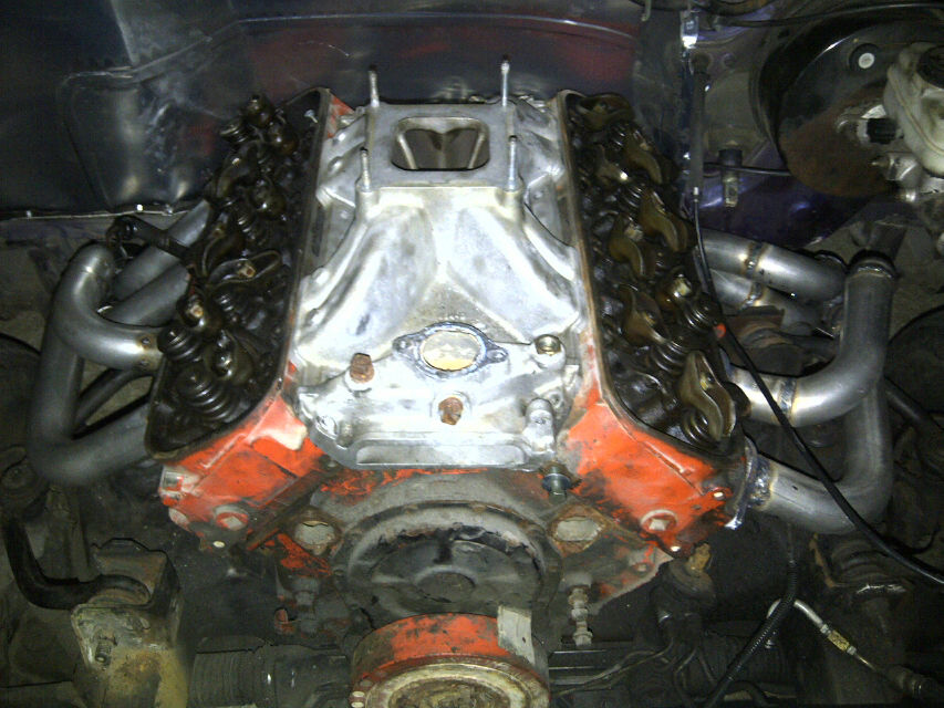

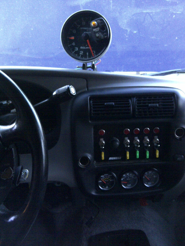

I do have a couple pics of the headers and intake mocked up from the other day. More has been done since. Also got my switch panel and gauges in where the radio and heater controls used to be. Looking good to be fired up on the race motor this weekend. :icon_thumby: And sorry for the crappy pictures.

Are you going to have to trim the hood bracing?
Don't believe I will, haven't test fitted the 850 holley on it yet but it looks like it will have plenty on top.
I used that intake on my 77 Z28 w/454 that I had and ended up with a hole in the hood. Had to buy cowl hood to fit properly. On a Ranger it will be close I'd bet.
I could always throw a big pro-stock hood scoop on it if it hits lol. Got a lot of work planned for tomorrow from assembling the top end of the race motor, shift kit in the transmission and as it turns out finding a new radiator. I was attempting to use the one out of the big block donor truck but the narrow frame rails got me again. Too wide to drop between and too tall to sit on top. Still hoping to get it fired late tomorrow without it. Some little odds and end to get sorted early next week and some street time about Wednesday or so.
