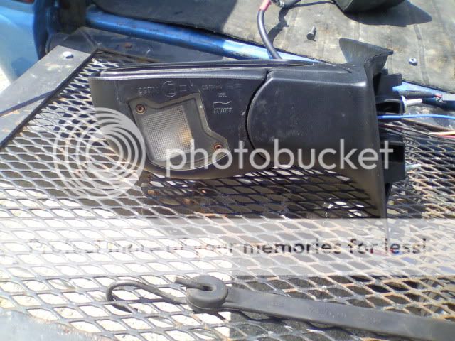

I swapped the outer housing and motors from an Exploder with puddle lights. I would have just swapped the whole deal, but the angle of the triangle peice is different between Expos and Rangers. I tapped into the door switch wiring, so they come on when ever the doors are open but not when the dome light is turned on from the dash switch.
With a firm hit from the bottom the outer housing will pop off the triangle shaped door bracket.
Stock Ranger mirror assembly
Expo outer housing popped on Ranger triangle door bracket

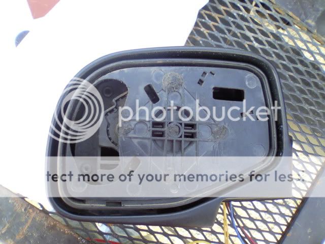

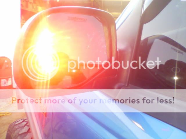

I also installed the mirror glass from a Thunderbolt edition Ranger with the LED turn signals behind the glass. I got them from Rousch Racing since they own all the rights and overstock parts for the Thundertbolt Ed. Ranger.
The plastic backing plate that the Signal mirror come with are made for like 03+ Rangers, so the pegs for the motors dont line up. The backing plate has to be heated with a heat gun to soften the glue, then carefully seperated and the glass must be clipped/glued onto the older backing plate. A hole has to be cut in the older backing plate to allow room for the LED indicator.
Heres the Expo housing with backing plate trimmed for LED indicator
Thunderbolt glass seperated from the backing plate
