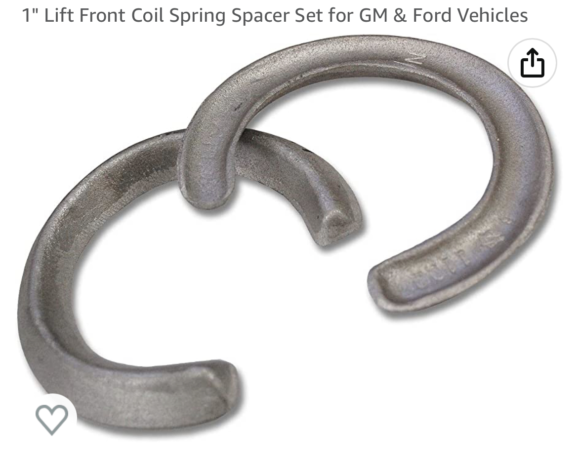

I guess I was just a bit confused on how the kit in the rear works if you were going to lower it 5”. So would you keep the stock shackles if you didn’t want to lift it back up 2 inches? I don’t want to do it because it’s sketchy I just thought that was how the kit worked. My main question I guess is can you run the different sides at different heights? With the DJM Shackles, there are two sets of holes, the one furthest away from the bushing is 3” and the one closest to the bushing is 4” (I think), so my thought was I could run the leaned side at 4” of drop, and the passenger side at 5”. I attached the photo of the coil spacer.

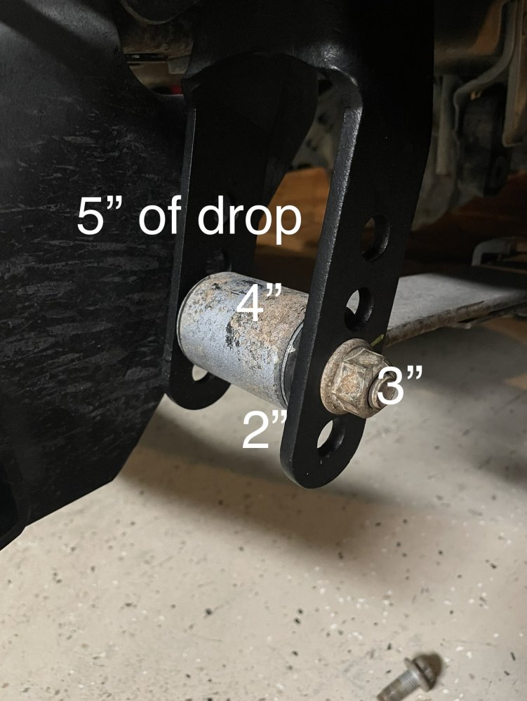

I was installing a rollpan on my truck today and I was looking at the leaf spring hangers and turns out the new DJM lift hangers have 4 settings, not 2 and I believe one of them is just stock height. Works out because my stock hangers are no good.

I've heard that the DJM shackles are shared with a full size Chevy kit. On the Chevy, they lower the rear and in a Ranger they lift the rear. The pic you posted is probably for a Chevy application (Hence the text about "drop"). Just something to keep in mind that was probably contributing to your confusion. The DJM shackles will provide lift in a Ranger, not drop.
