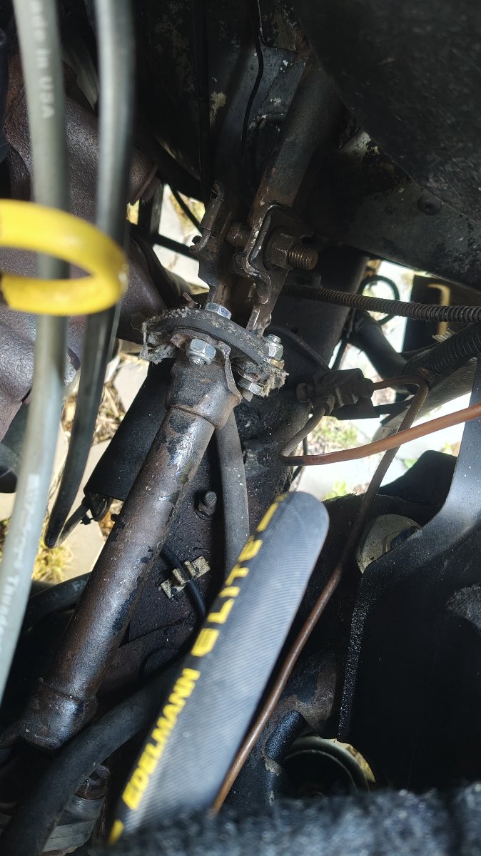

Hi,
This is the second rockauto rag joint I installed in my truck and after literally 150 miles it looks like this
Rag joint question
Did I screw the installation or this is just quality issue ? Can you point me to the place that sells online better quality one ? I'm kinda limited to the online buy because I live overseas.
Rgds,
Jerry
Maybe just me, but it looks like the 2 halves of that shaft are too close together.
Good question. Is there room for the 2 halves of the shaft to telescope together? Or is it all jammed up tight?
What else can you tell us about the truck? Any body mount changes? Is it all stock? Or have modifications been done to suspension, steering, body work?

To clarify: the truck is lowered with a DJM kit, but the body mounts are stock. The previous owner had installed both a suspension and a body lift, but I’ve since removed all of those mods. I don't see any aftermarket parts or obvious modifications to the steering column itself.
The original lift was a total hack job—the previous guy actually cut a slot in the firewall to make room for the steering column as it angled down. As it stands, the components are definitely jammed together more than I’d like.

When the PO did the body lift, he probably installed a longer intermediate steering shaft. That is why things are jammed up and wrecking rag joints. You need an OEM length intermediate shaft or figure out how to shorten what you have.
Personally, I’d look into getting a U-joint shaft. Those usually need cut down but there’s been a few people who have done it. The U-joint shaft eliminates that rag joint as a failure point. I only have one truck with a rag joint (my 88) and the truck has been torn apart for the past 10 years because I haven’t been able to get back to putting it together and haven’t addressed the steering yet so someone else will have to help you with getting the right part
I used a Borgeson lower shaft and u joint to replace the rag joint when I put the 351 into my Ranger because the rag joint was too close to the exhaust manifold. It took some fabrication, but it wasn't difficult. My 77 Mustang still has the original rag joint and it's still in good shape.
Thanks for advice guys! I will replace the rag joint but this time I will try to space two halves of the shaft a bit more. Also, can you suggest some part number for the u-joint that could fit even if some fabrication will be required ? Like I said, I'm mostly limited to rockauto/summit because these two shops can reliably deliver parts to Poland with decent delivery time.
I once used a rag joint from a 1968 Ford Torino to put in my 1990 Ranger. It wasn't exactly the same but it worked with just handtools to install. Just a suggestion to check other years, even decades apart.
