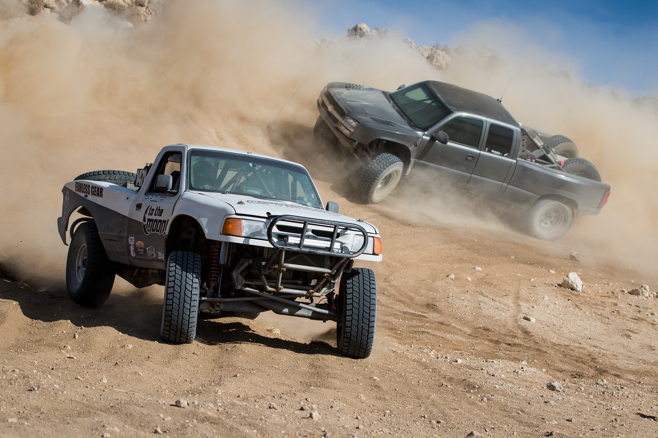

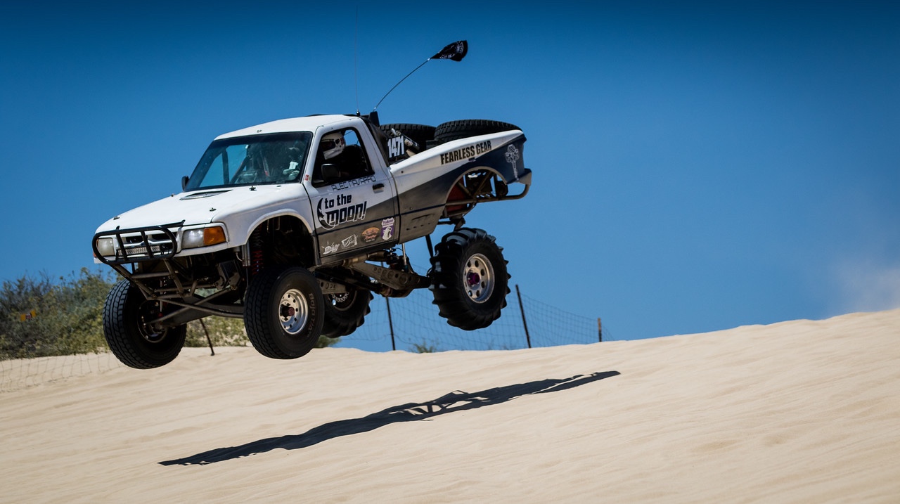

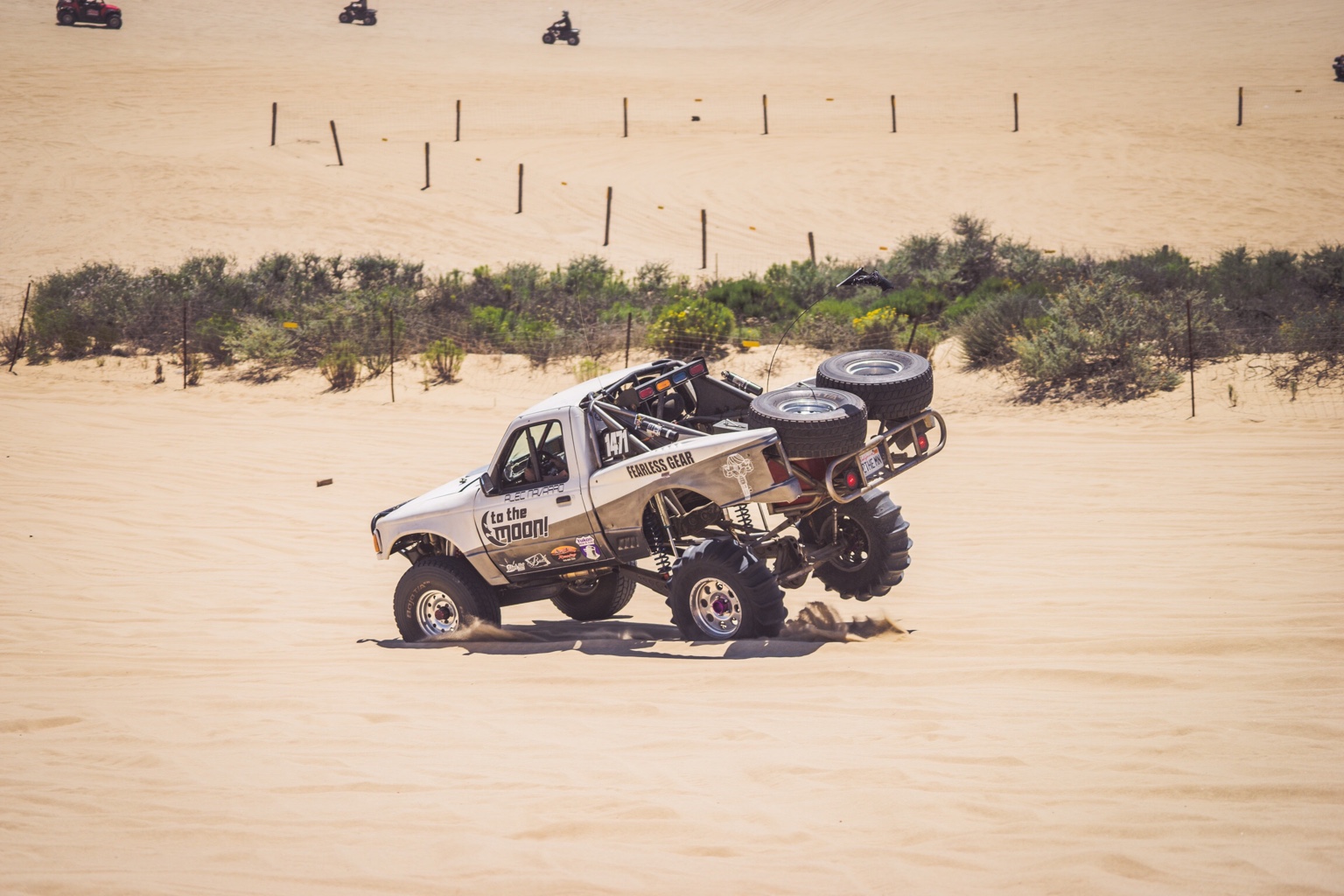

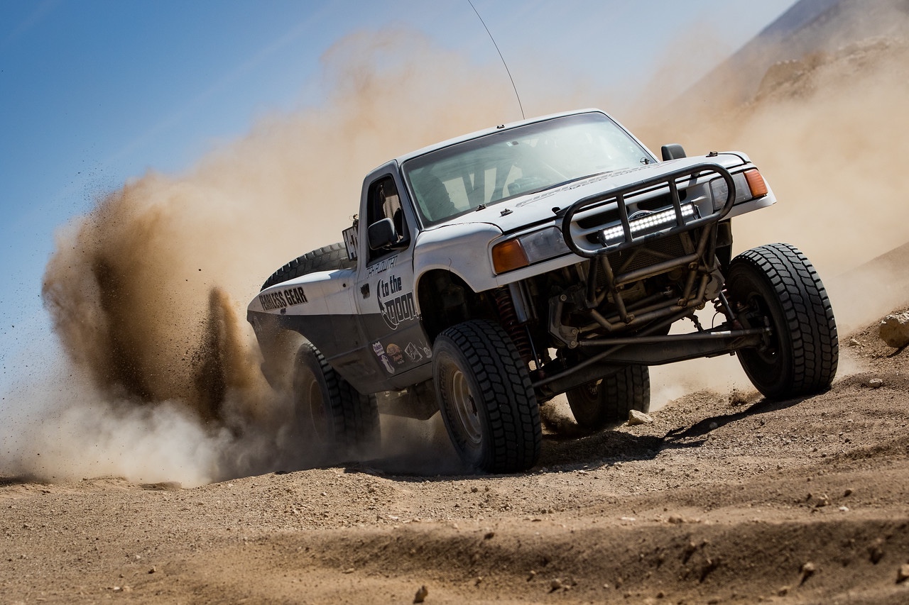

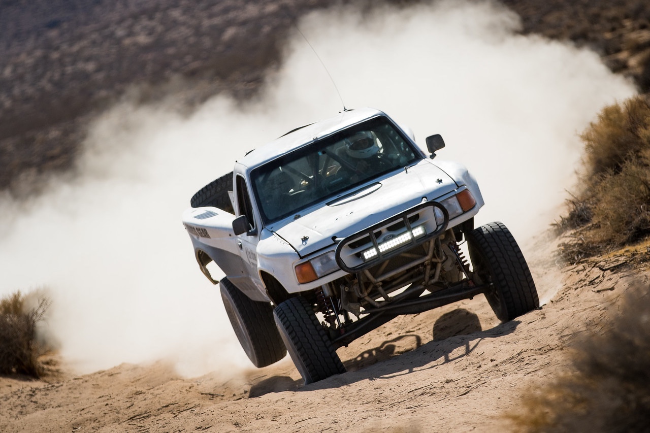

Broke a few minor things but still had fun out there.
RaceRangers Build
Dude you were rippin! That thing hauls ass
Thanks man, hurt the steering box early on so I had to drive conservatively most the day but we were jammin until then lol.

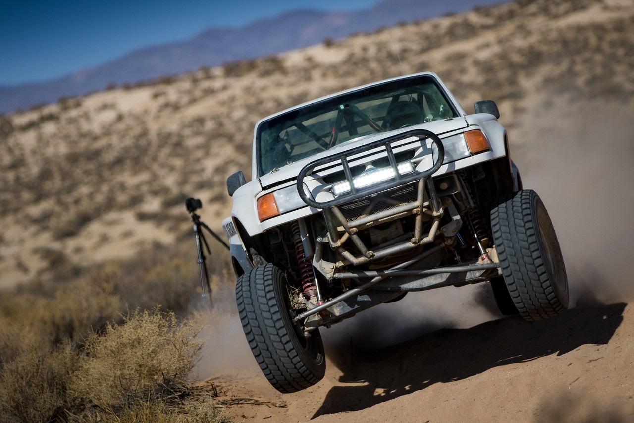

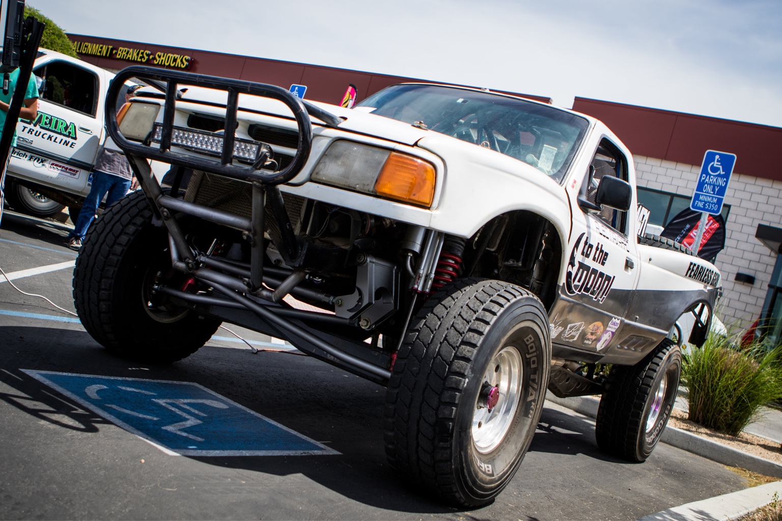

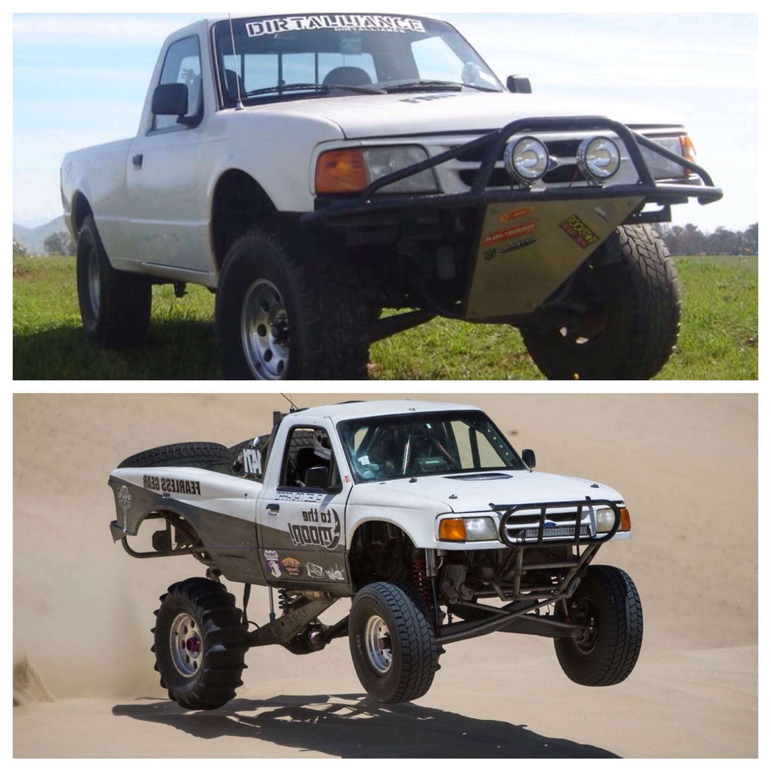

Hey alec, i reread through your whole build for some motivation on mine. I was wondering, what size heims did you use on your front beams and radius arms this last go around.
Also, look what i found going through my closet.
RaceRangers Build
Sent from my SM-G892A using Tapatalk
That’s awesome. My friend that made those shirts is going to put a bunch of his shirts back online soon if your’e Looking for more off-road apparel.
The heims on the the front suspension are 1-1/4”.
Good to know, ill be hitting him up for some in the future. On those beams, did you just build the caster into the radius arm and adjust accordingly afterwards?
Yes most of the caster is from the radius arms. Then have a +/-2* adjustment bushing in the upper ball joints.

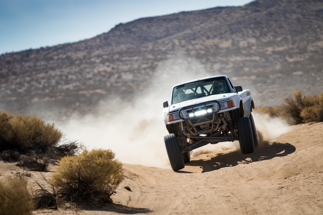

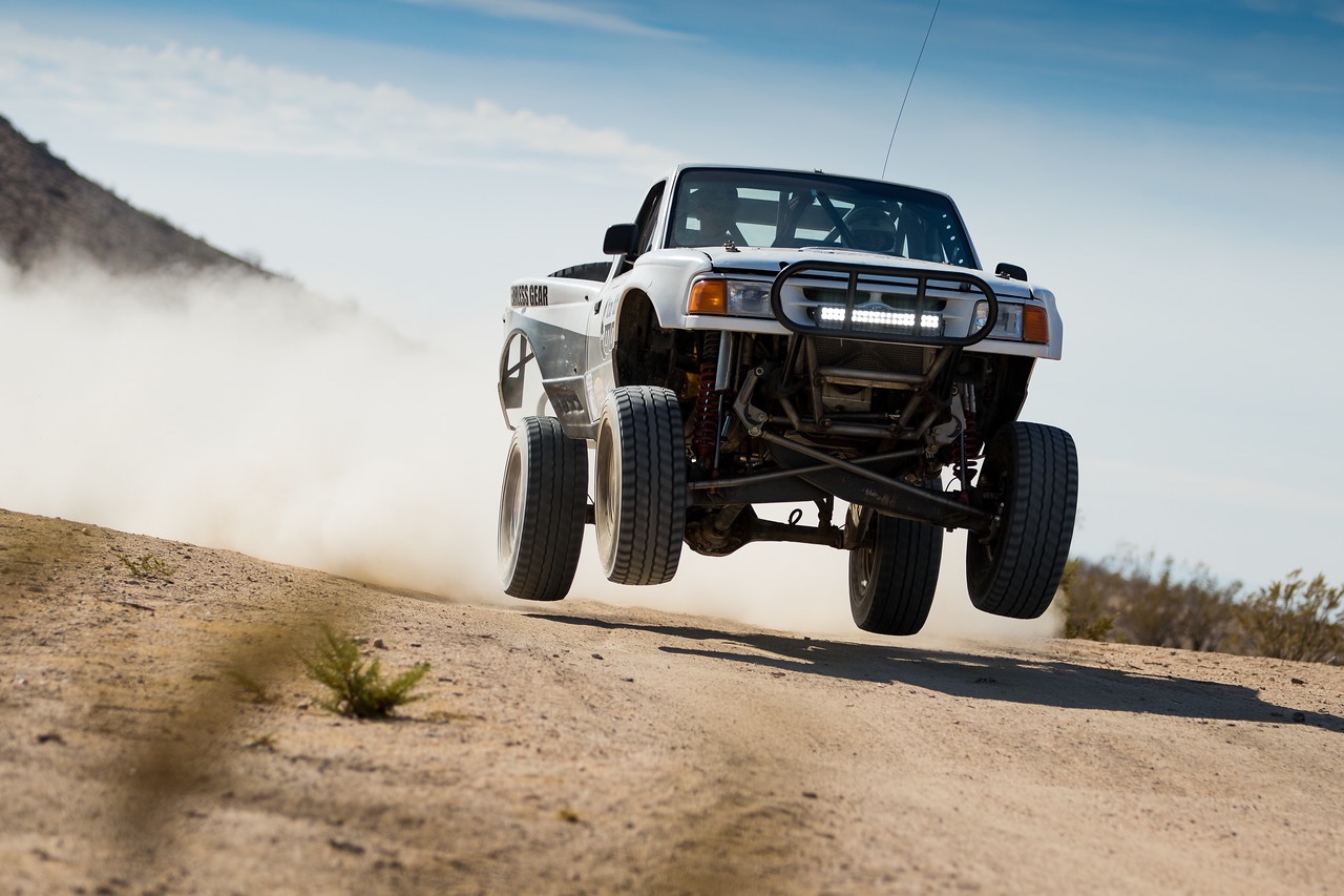

Took her to the desert
