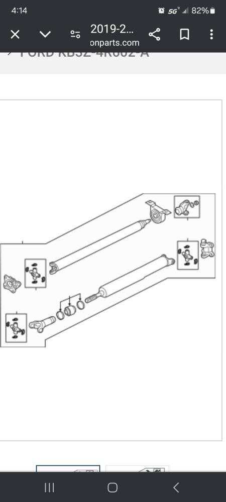

I frequent the Ford service department here locally. The Prevosts we build are a division of Volvo. So they share some electronics with Ford. So anyways. The service manager was outside when I pulled up yesterday. So he came over looking at my truck. So I got him to look at my carrier bearing (me knowing it's getting sloppy.) Long story short he can warranty part but not labor. So parts on the way. Said six weeks.
So researching looks like fairly easy afternoon job. My question is. Does the bearing have to be pressed on, or is it something I can just grease and slide on?

Don't know how similar they are. But I did the one on my Superduty pretty easily. No press needed fir that one.

I've also discovered while looking for an install video. Some guys are saying that the 2 drive shafts are 180° out of phase. Which is what's causing the bearing to wear and the slight vibration everyone is complaining about. So how would I check that?

Phase angle is the relative rotational position of each yoke on a driveshaft or coupling shaft. When the yoke ears are in line with each other, this is referred to as “in phase”. “Out of phase” shaft assemblies have lug ears that are not in alignment at both ends, but are offset by a prescribed angle.Sep 29, 2017
JOI-TEC-082 DRIVELINE PHASING SERVICE/TECHNICAL
If your shaft is 180* out of phase, remove one piece and rotate it 180*, making sure the yoke ears are aligned and take it for a test run. If it gets worse, undo what you just did. If it gets better, they were right.
If your shaft is 180* out of phase, remove one piece and rotate it 180*, making sure the yolk ears are aligned and take it for a test run. If it gets worse, undo what you just did. If it gets better, they were right.
You probably mean 90 degrees out of phase. 180 would still ne out of phase by 90 degrees.
These shafts may be out of phase by some strange amount due to a manufacturing flaw. They could be 13.7 degrees out if phase or 45 degrees or 26.9 degrees, or whatever. It would still be wrong. But you may not get it to line up just by rotating in increments of the splines in the slip joint. For example; if you have 20 splines, then rotating by one spline changes the relationship by 18 degrees. But if it's off 13.7 degrees, it's still not right. However, that might get the vibration down to imperceptible levels.

Man this my first time. I just saw it in the YouTube haha. I've never messed with a carrier bearing before. I do have a slight vibration around 73 to 75mph. But I hardly ever get up that fast. So I probably won't be messing with it. I'll check and make sure the yokes line up in the morning. But I've got 6 weeks to figure it out. If they are correct on back order time frame.
I've done Carrier bearing for Nissans sevearl times. they are much simpler than the Ranger set up. I just recently did My '87 D21 and it took a lot of the vibrations out. IF it only vibrates at 70-75 mph, I would look into tire balanceing also.
I marked mine off with a wood lumber chalk and put it back accordingly, don't recall anything being pressed.
I've pulled it now so many times I lost count but still use the same marks.
I drop the rear shaft bearing and all
