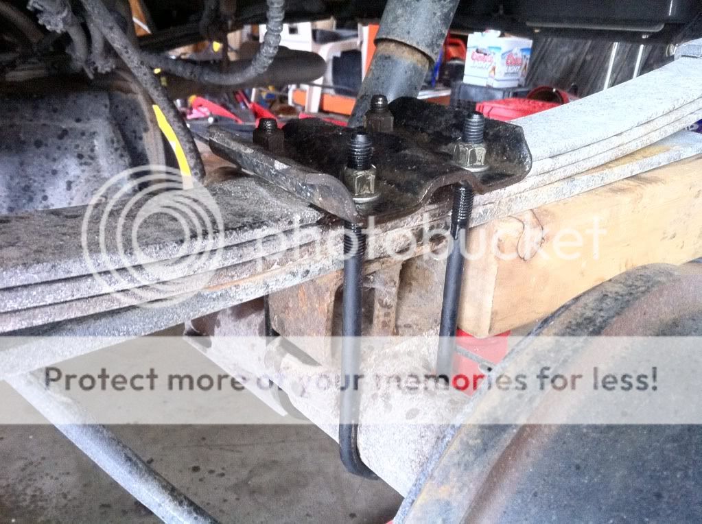

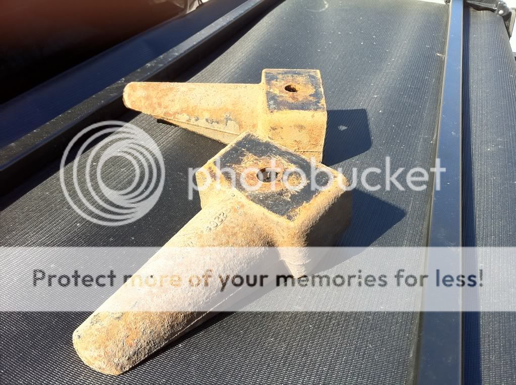

Also, I'm getting rid of my lift blocks, and putting the stock 2" blocks back under it. Anyone know what U-bolts will work? Or do I have to get them custom made? The u-bolts off the explorer, looked quite short, so I didn't pick them up.

some are narrower the others. im running a 92 axle from a ranger, its 3 inches narrower. theaxles are basicaly the same.
as for u bolts, go to ford and order 4x4 u bolts, as the 4x4 have those block in there.
Thanks dude. Ha ha. It's the simplest, and most common sense driven answer, yet, no one, including myself thought of it! Ha ha ha. Thanks again.
