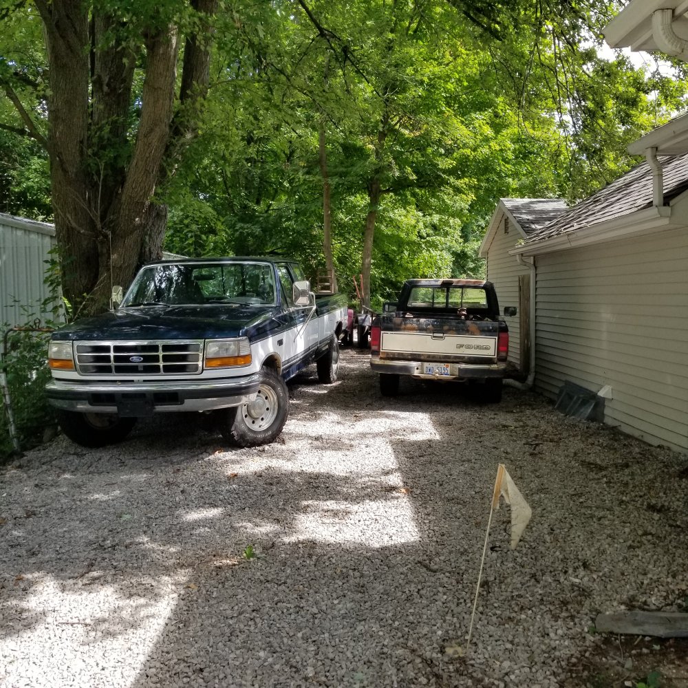

After i did some more looking and figuring y might just lop an extra foot or so off the pole. So it would be 10 ft above ground. Its going just to the left of the posthole diggers in this pic, as you can see the parking is tight but i have my 18ft equip trailer, my 6x10 utility trailer, F250 and ranger all parked back there and i can get them in and out without moving shit.
My not just mount the light on one of those trees, the side of the house, or what appears to be a sea container(on the left)?
Looks like you have a tree about the same diameter and position you want the pole installed already.
I thought about bolting it to the tree....but eh. Just me doing things the hardway.
That building to the left isnt mine, and if i put it on the shed it wouldnt shine where i really wanted it to.
