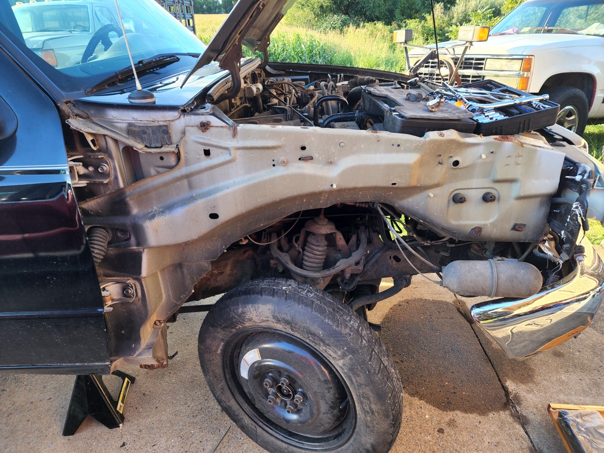

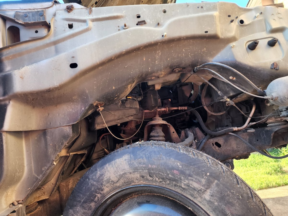

So, I took the fender off. No cab impact. Because this was a guardrail he hit, the damage is laser localized. If he had hit a truck, or ditch, the area of damage would be much worse. Hopefully the frame shop doesnt rape me too bad on this pull.
When I say the shop will have direct access, I mean direct. No cab or bad to work around, heck the tire barely has to come off. and now with the fender and inner fender off, they could have lunch in there.
There's some wrinkling on top of the apron, but the cab is pretty spotless.
See attached...

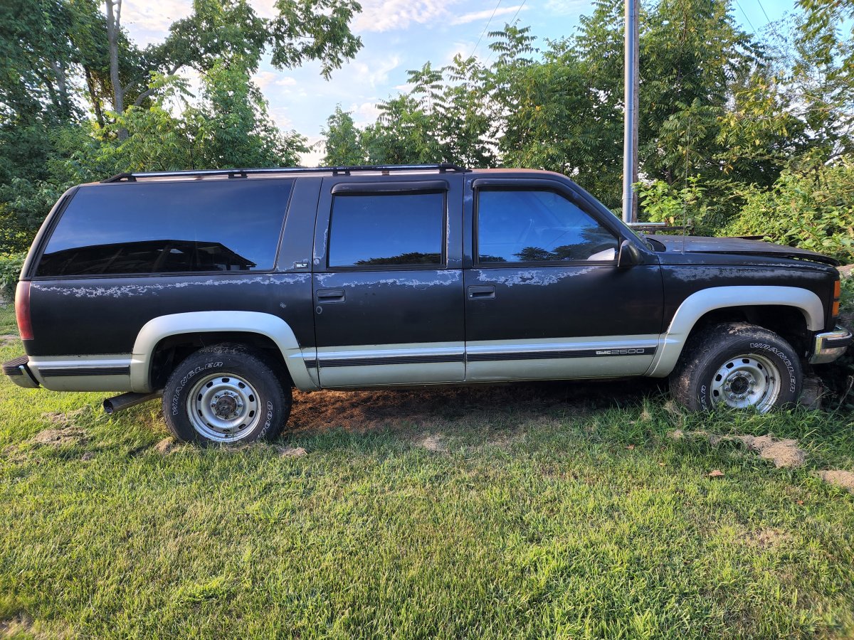

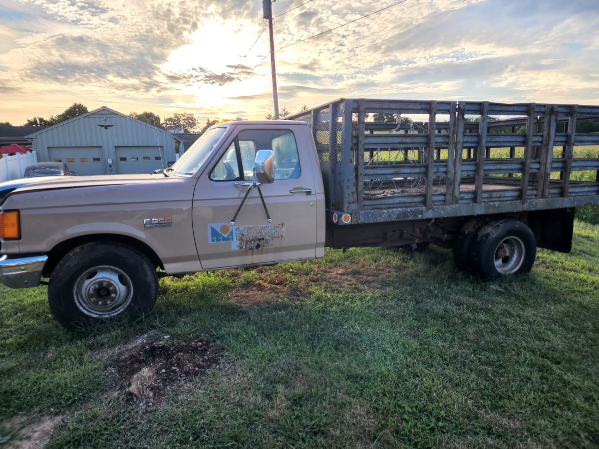

Haha. Like I said, I'm out of trees but I have a pretty large Ford anchor, and a 2500 Turbo Diesel 4x4 Suburban to pull with...
The anchor and the puller...
In all seriousness, I bet I'd just pull my flatbed sideways through the Ranger trying to straighten it. But if the prices are too high for me, I'll likely MacGyver something.

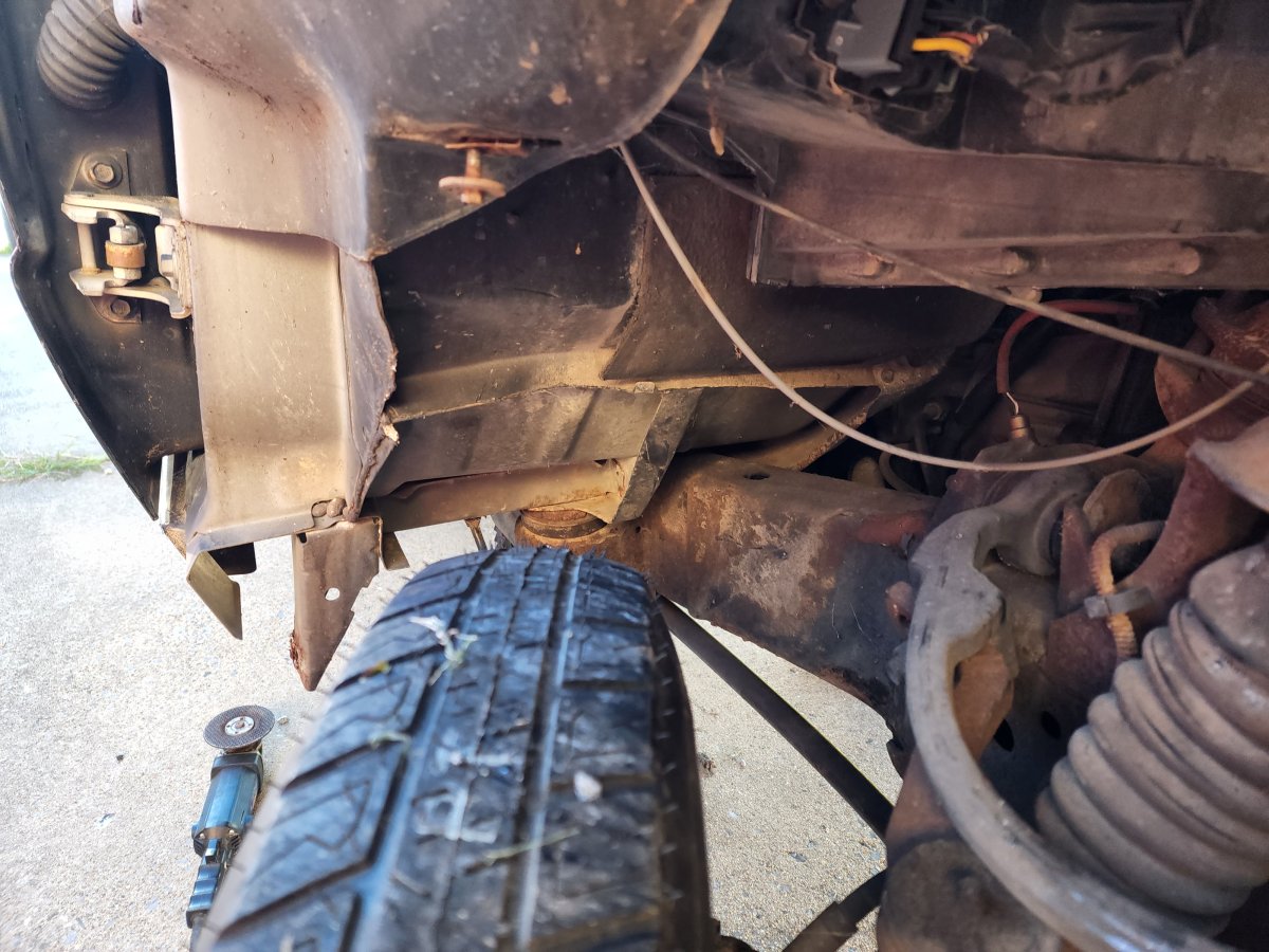

I'd like an interior fender picture to see if there's any damage to the sheet metal between the front clip and firewall.
If the truck was brand new, it would be 50/50 if they would total the truck or fix it. As it in a '99, its totalled. Just because it is possible, doesn't mean it it the right thing to do. You will note in the video, they give up trying to straighten some of the sheetmetal parts and just replace them...
Swapping frames is how I resolved this situation, and it is a ton of work - the truck better have sentimental value.
Apron picture attached as well as cab area. Amazingly great shape.

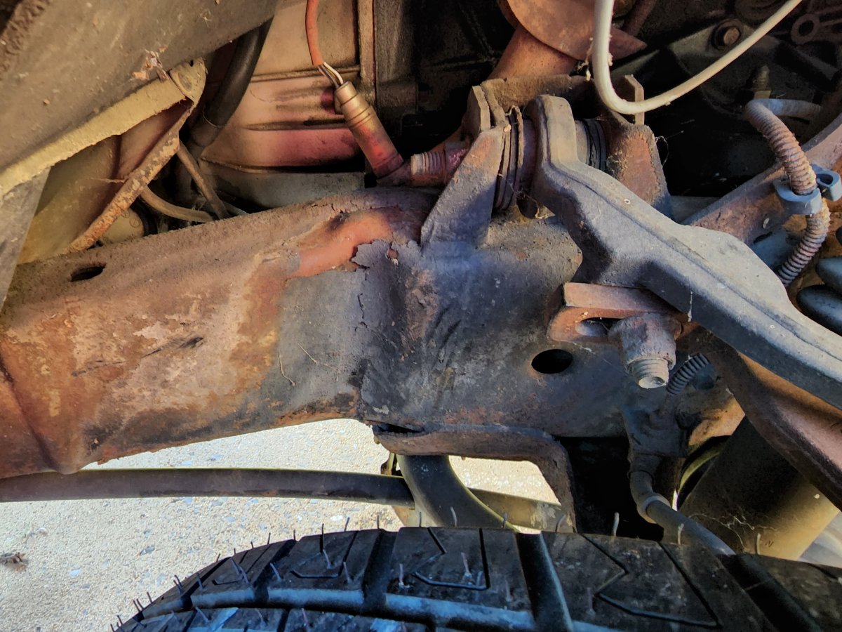

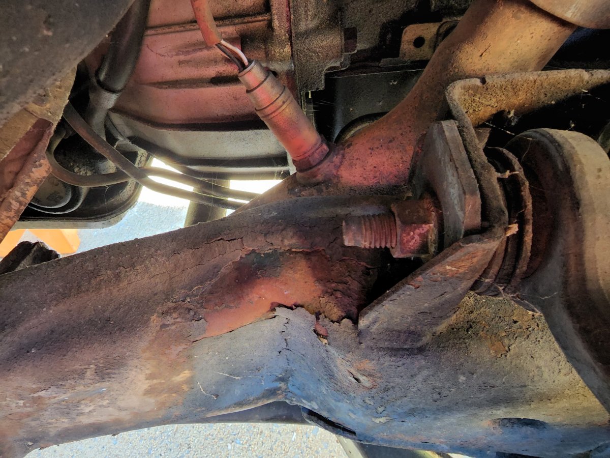

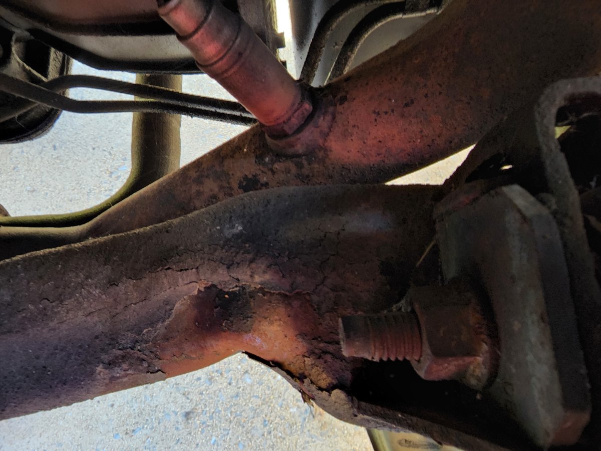

I see it was just paint that was cracked, not frame, so I am slight less concerned. (For the record, I still think swapping the front frame section in the proper solution).
Ranger frame is 1/8" thick, roughly 6" tall (plus some horizontal flanges) and made of 30 ksi steel. So, you will need north of 15 tons (probably more than 20) to straighten that kink. And you need to keep force localized - you don't want to flatten the hump over the rear axle instead of straightening this damage. Heat wrench can be of assistance, but comes with risk.

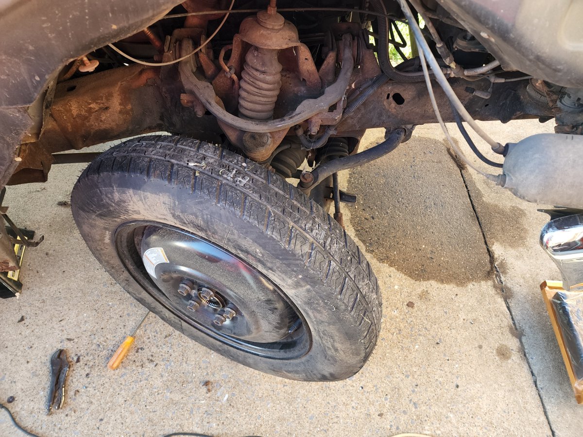

My soft plan is against trying to use vehicles to straighten it, as I'd have no finesse or fine tuning, and could possibly overpull, as you referenced. So, I've separated the tie rod end and the knuckle knub that was attached to it that broke off the knuckle because I've got to restore steering somewhat to move it around my yard, trailers, and wherever it goes to be straightened. So, I'll weld that piece back on, and reattach the tie rod end temporarily. I still may wrap a chain around the lower ball joint, and attempt to pull some of the distortion out of the lower control arm. This is because there is a lot of binding in the knuckle, and you literally have to kick the tire to get it to go left/right (with no tie rod end attached, so it should be freely turning). If I can pull an inch or two out of the LCA, that would go a long way to help align the UCA and LCA. Right now, I've got about a 4 inch variance between the upper and lower, hence the binding. Pulling out some of that stamped steel in the LCA will also help move the tire forward an inch or two, then the frame pull will do the rest.
