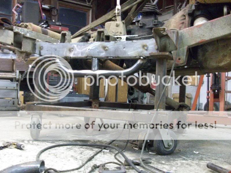

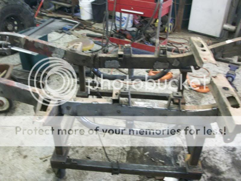

Finally got a chance to work on this thing again.

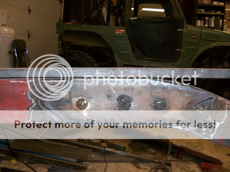

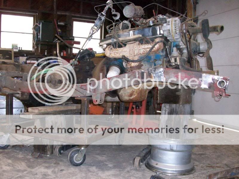

I got a couple plates made and welded on to reinforce around the motor mounts. We all know it's gonna need it. :icon_rofl:

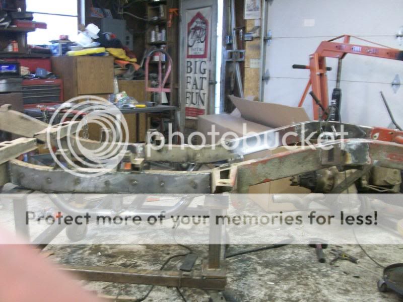

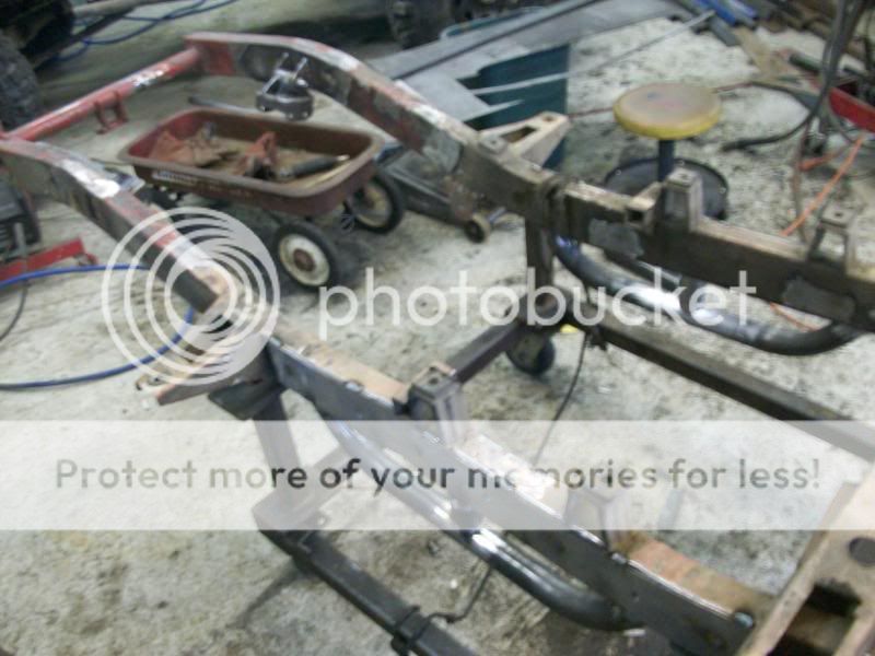

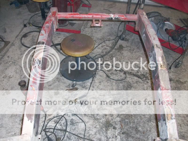

Had to cut off the old motor mounts and the bumpstop perches, and got the frame all cleaned up.
Project Mazzuki

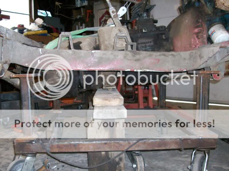

Made some 1/4" plates to reinforce.
Project Mazzuki
Project Mazzuki
Project Mazzuki
3/4" "strap" on the top?
Project Mazzuki
Project Mazzuki
Project Mazzuki
I'm gonna plate the outside and underside too, just need to round up some more steel.

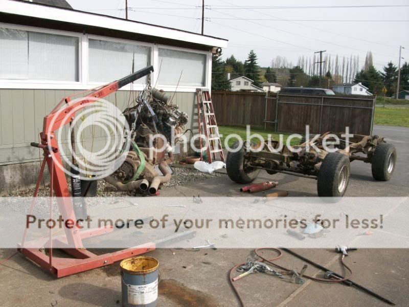

That's all for tonight, I'm gonna try and get the ramdatsun pulled up to the shop tomorrow, get the cab off, pull the motor/trans/tcase and get them set in the zuk frame so I can start making mounts. :icon_bounceblue:
Progress! :icon_hornsup: IT FITS! :icon_hornsup:

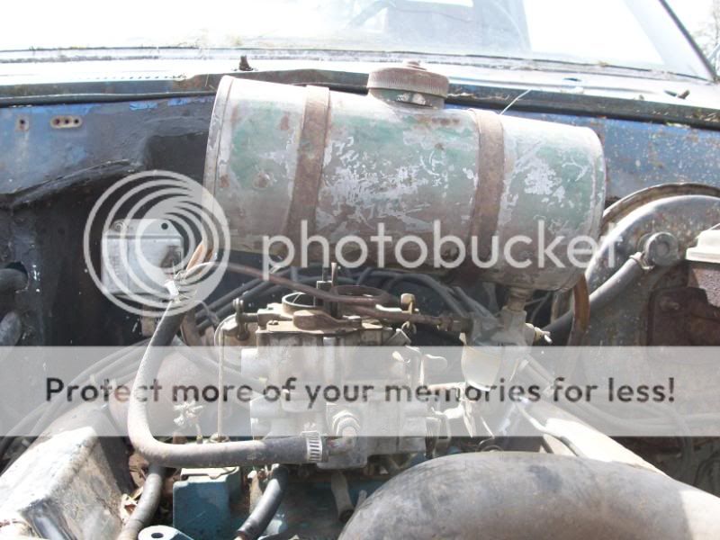

Started this morning by rigging up a different fuel tank, so I could drive it over to the shop.
Project Mazzuki

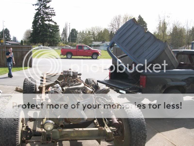

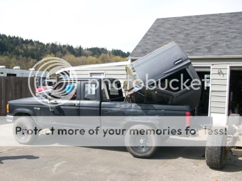

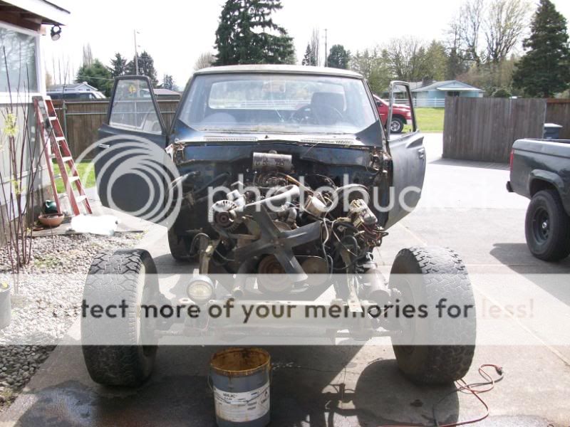

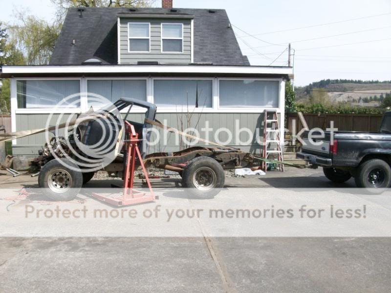

Got the front clip cut off, and went to town yarding the body off.

Making the ranger work for it's parking place.
Project Mazzuki
Project Mazzuki

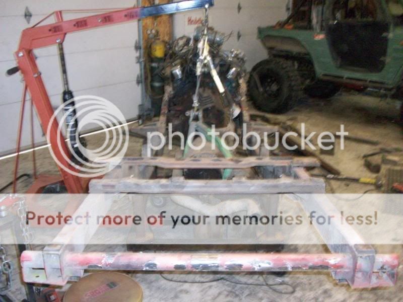

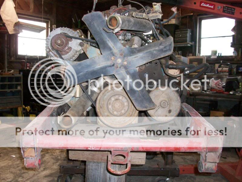

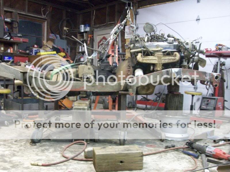

Motor/trans/tcase out.
Project Mazzuki

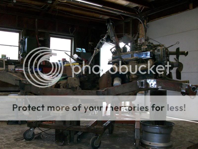

And it fits.....mostly....

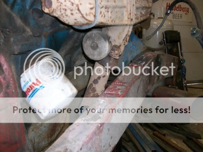

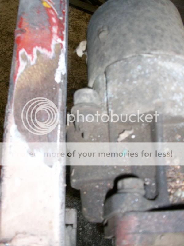

Need to notch the starter a little....:icon_twisted:
Project Mazzuki
And grind an 1/8th inch or so off the end of the clutch fork.

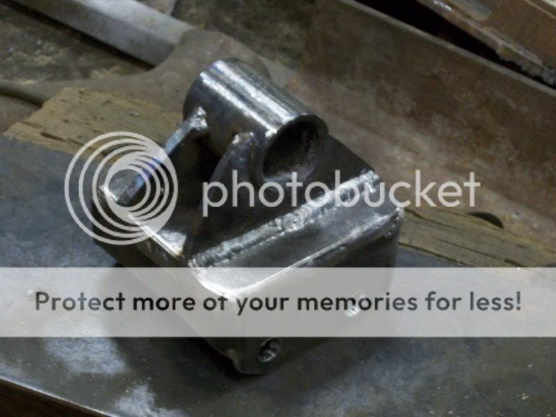

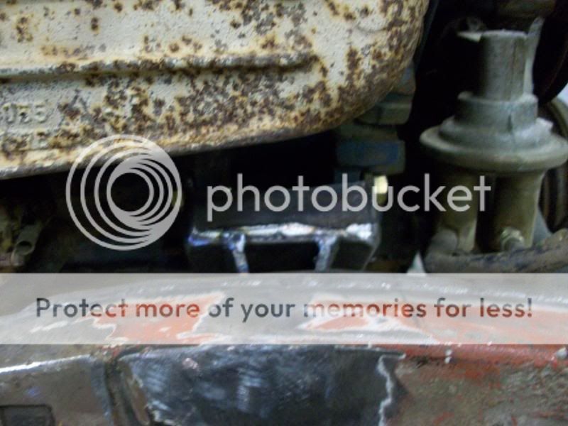

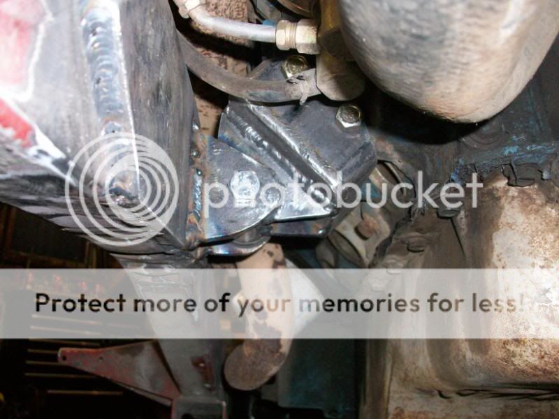

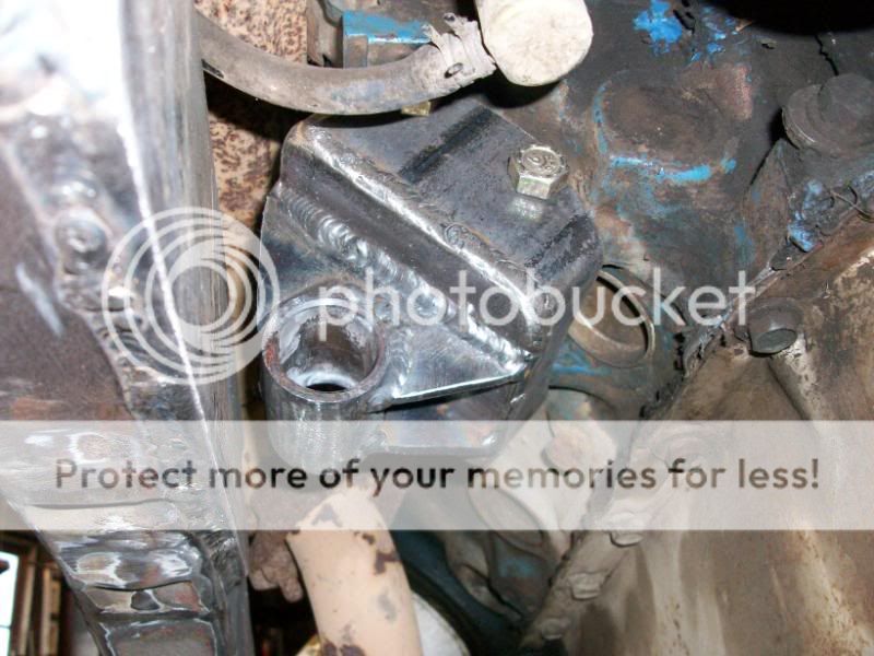

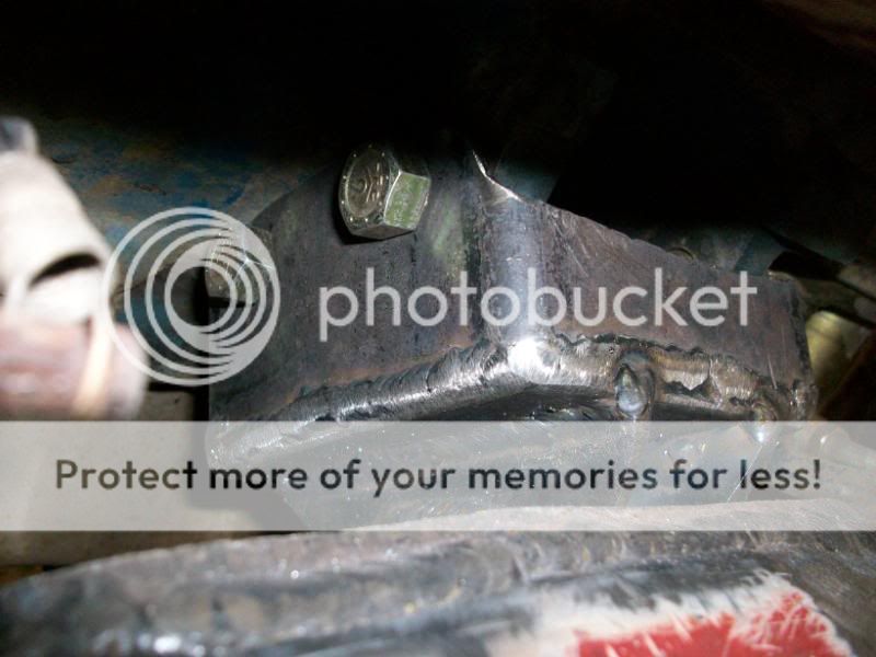

Ok, so I've been working on motor mounts, I was torn between hard mounting it, or rubber mounting it, and decided on rubber bushings.
Project Mazzuki
Project Mazzuki
Project Mazzuki
Project Mazzuki

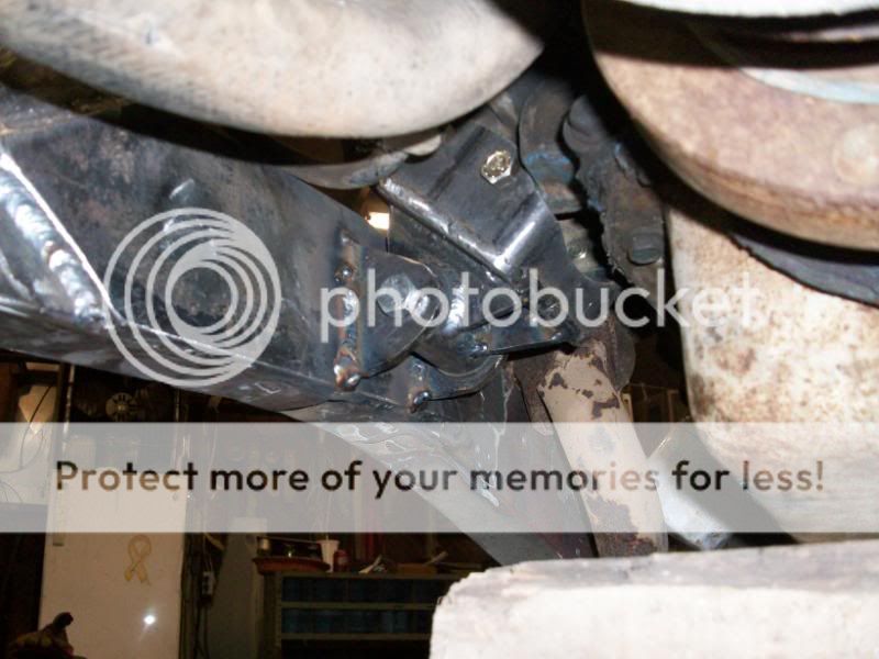

Now I just need to copy that for the drivers side, and make some tabs and gussets for the frame, and we'll have some motor mounts. I've been looking at ideas for the bellypan/crossmember, as well as a couple bolt in crossmembers around the engine/trans.

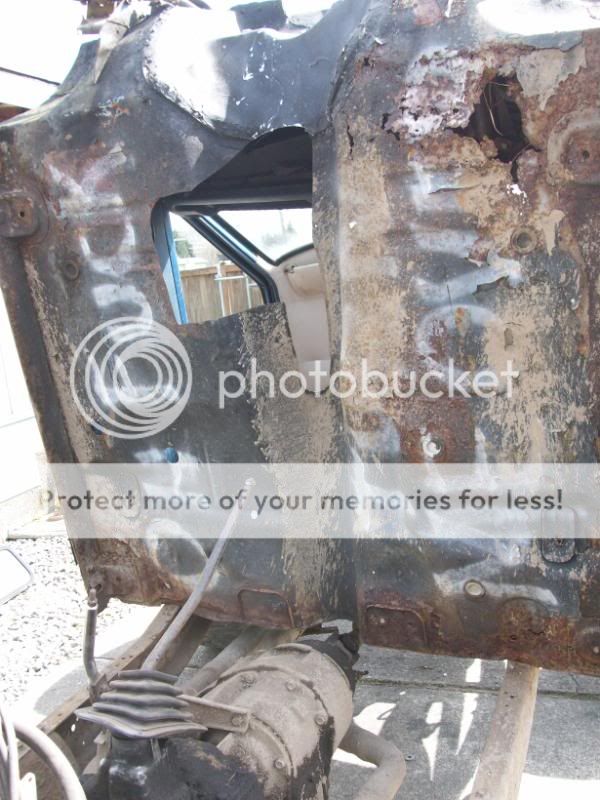

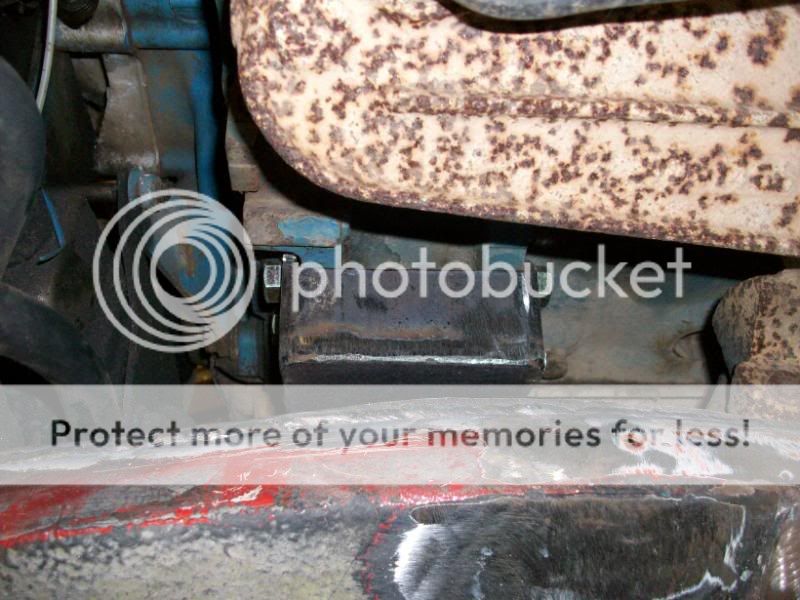

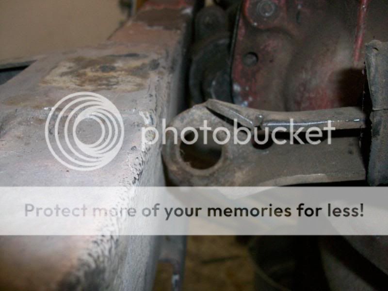

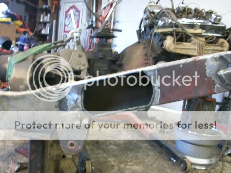

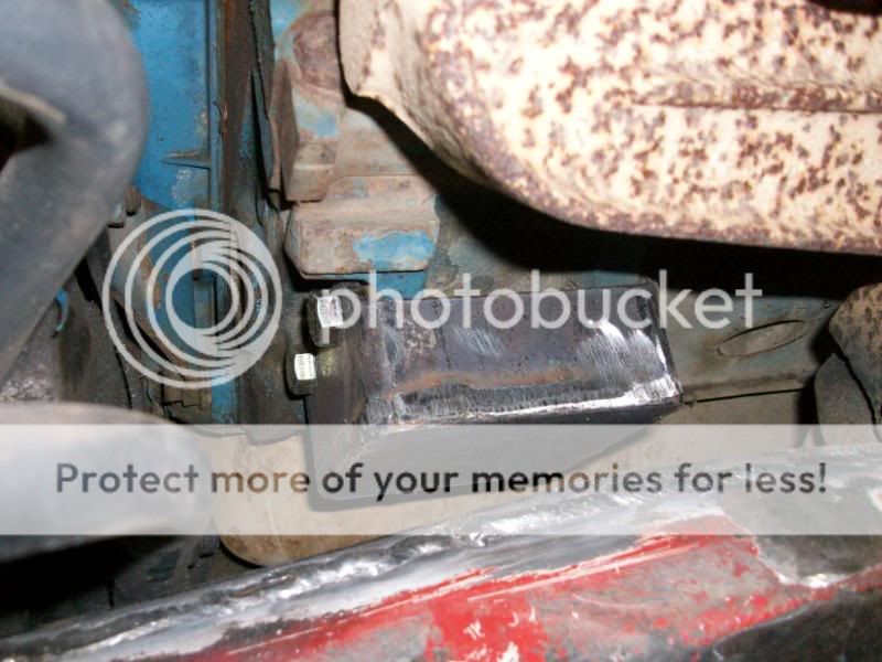

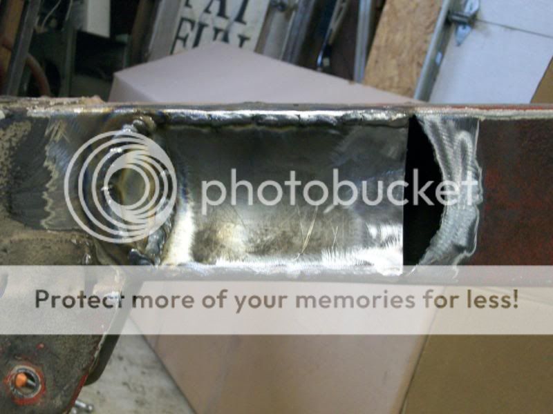

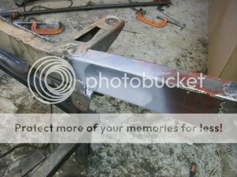

I ended up having to cut a window in the drivers side framerail, for starter clearance. The starter was resting against the framerail, and the positive cable at the solinoid was a little too close for comfort. I'll end up making a dished piece to fit in the hole, and plating the top, bottom, and outside anyways, so it should be plenty strong.
Project Mazzuki
Finished up the passenger motormount, and got a good start on the drivers side.

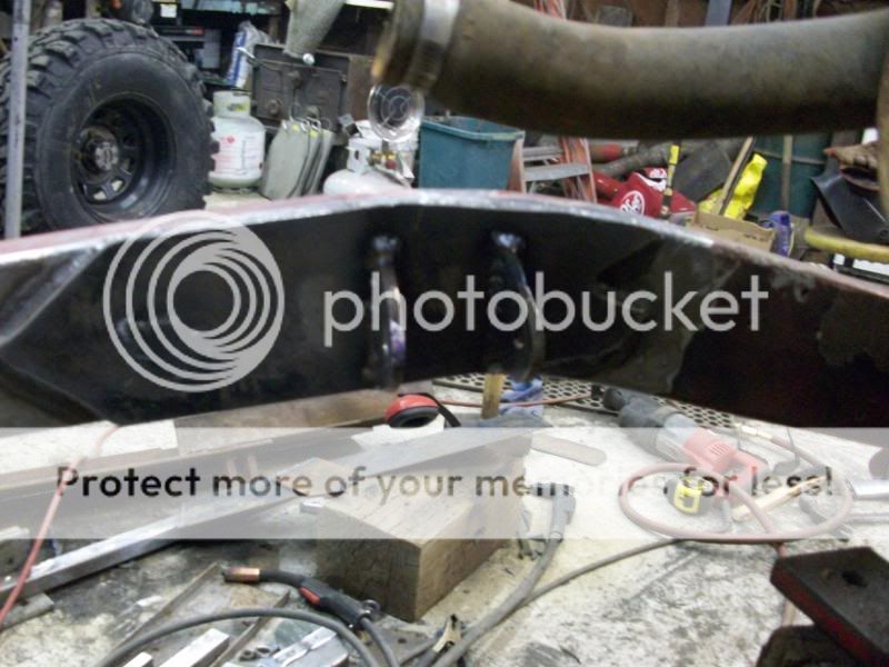

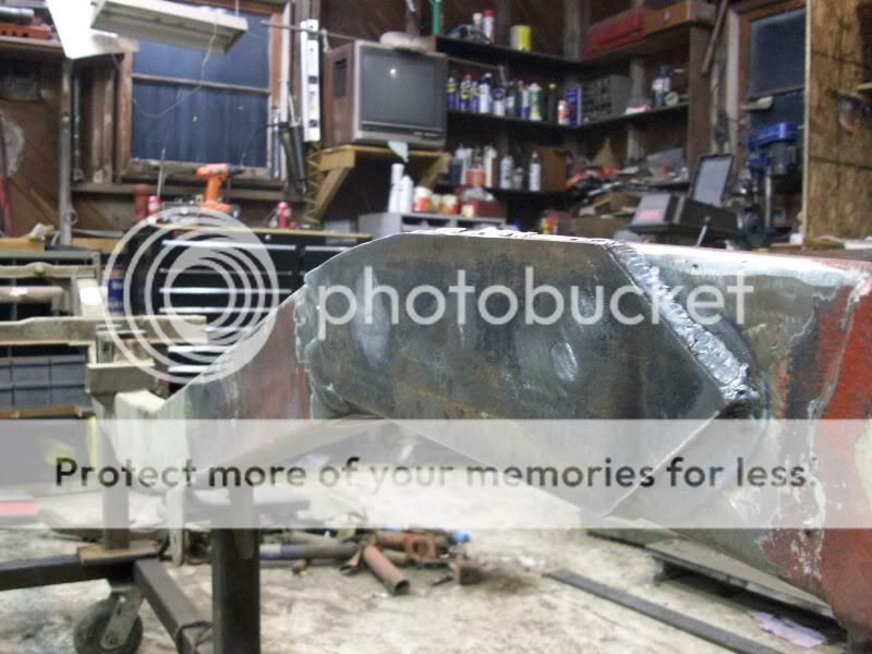

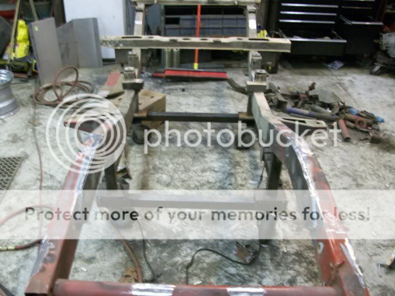

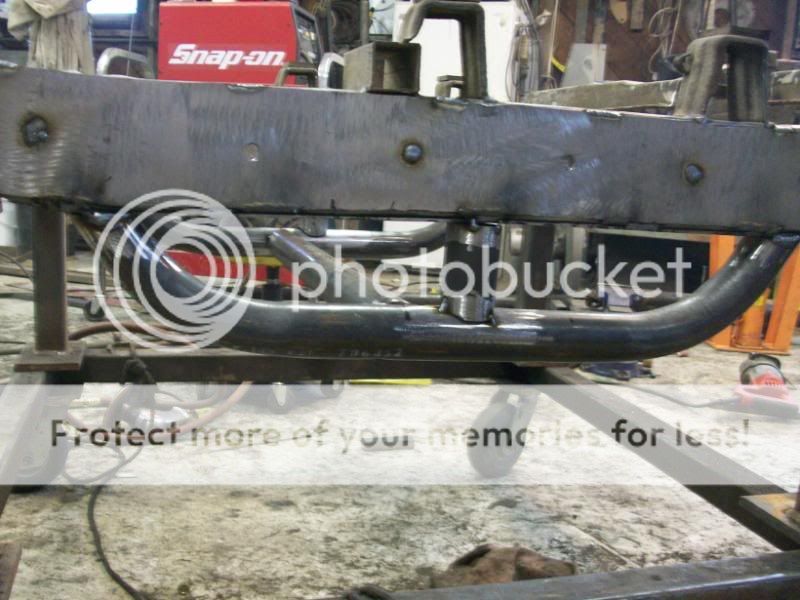

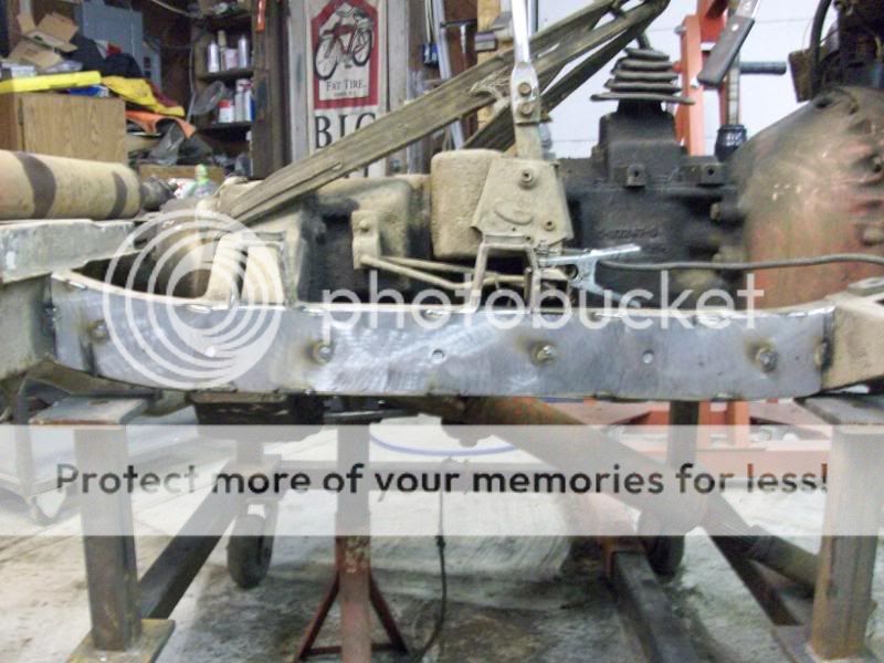

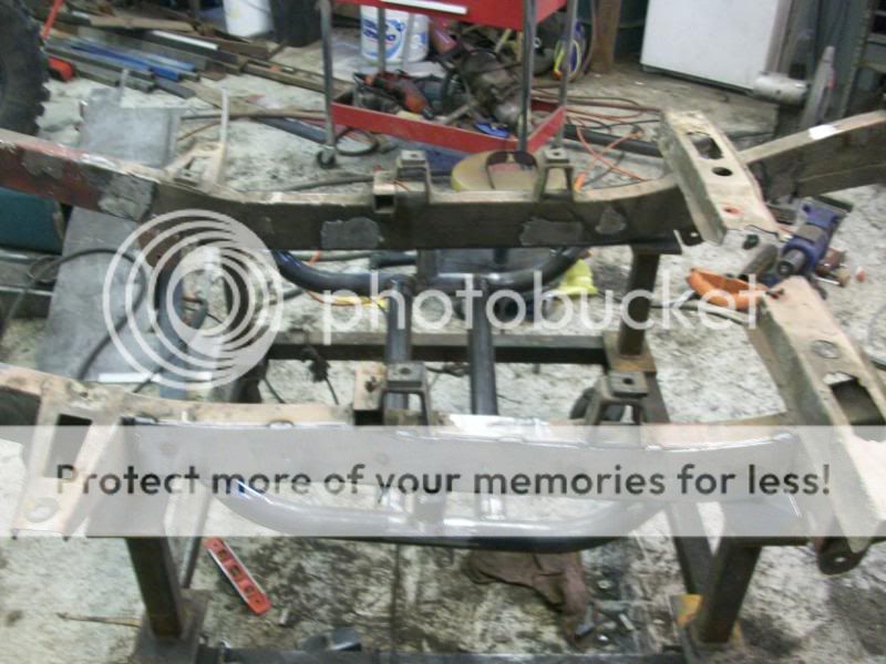

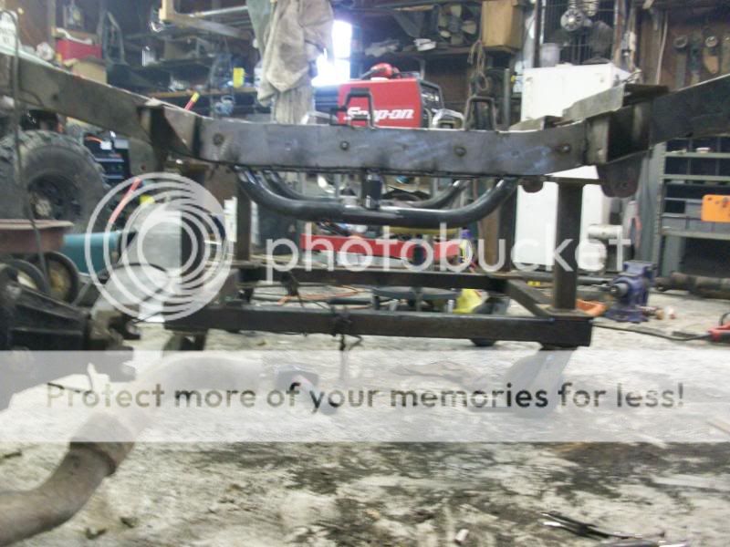

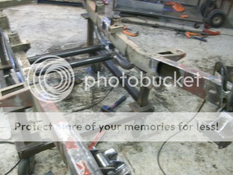

I started in on the cradle for the tranny and transfercase, wanting it to be a skidplate as well as a trans crossmember, also with the ability to add another mount in the future when I hang another case back there.

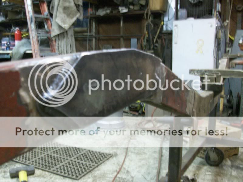

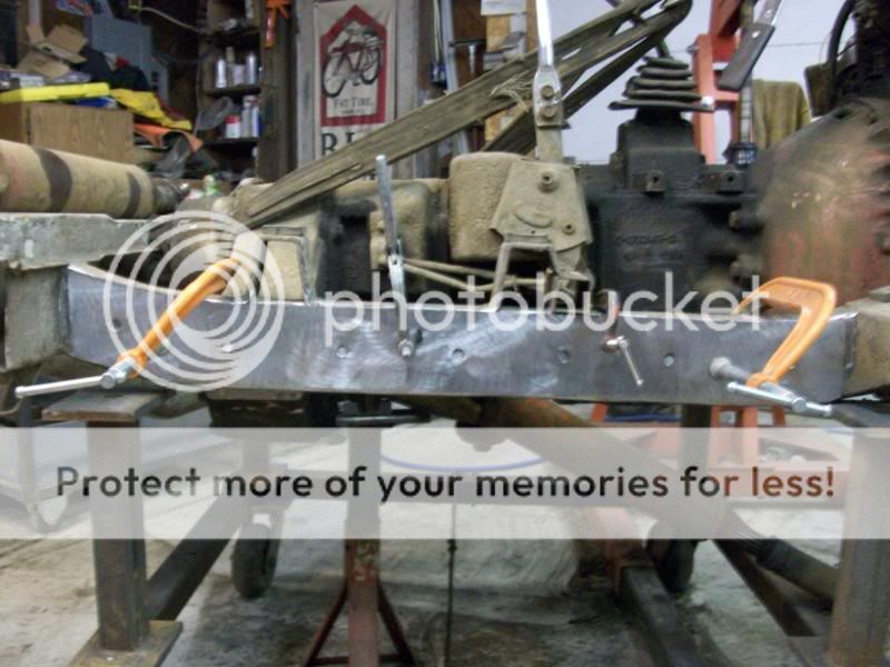

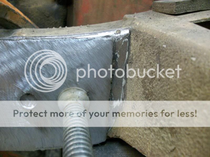

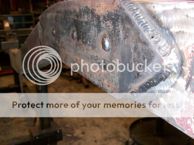

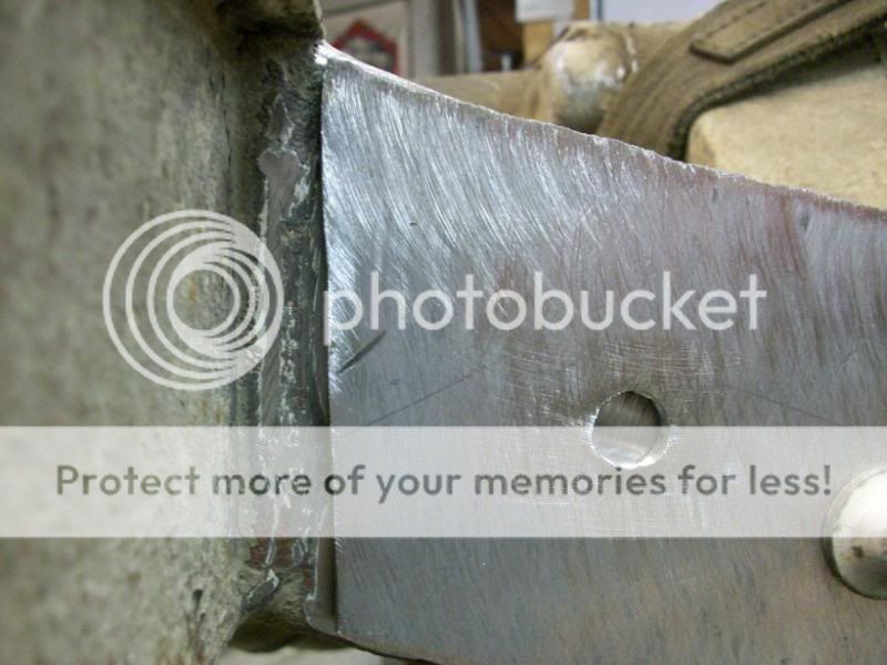

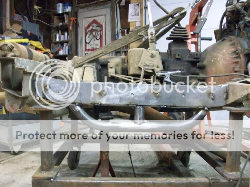

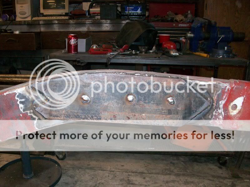

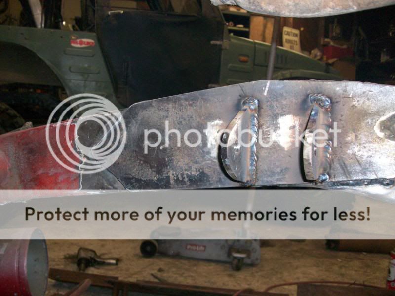

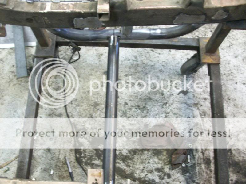

I had to start by reinforcing the frame, I used 1/8th inch steel, and plated the outside and underside. 1/2" rosette welds every 6 inches or so on both the outers and unders.

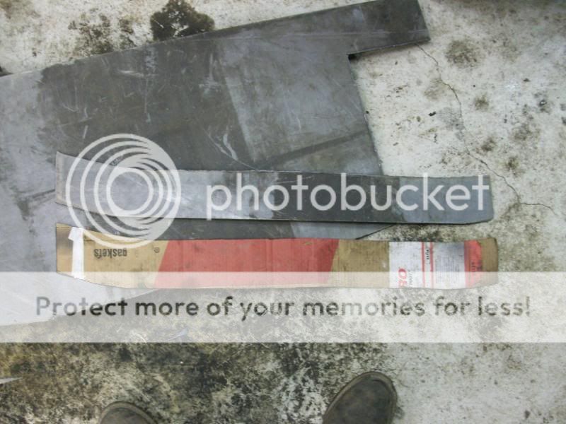

Using a template i made, I cut it out with the plasma.
Project Mazzuki
Drilled the holes, and made a bend in the plate where the frame bends, and clamped it up.

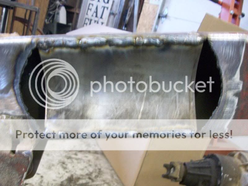

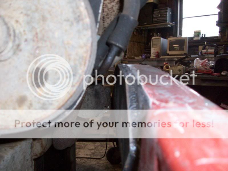

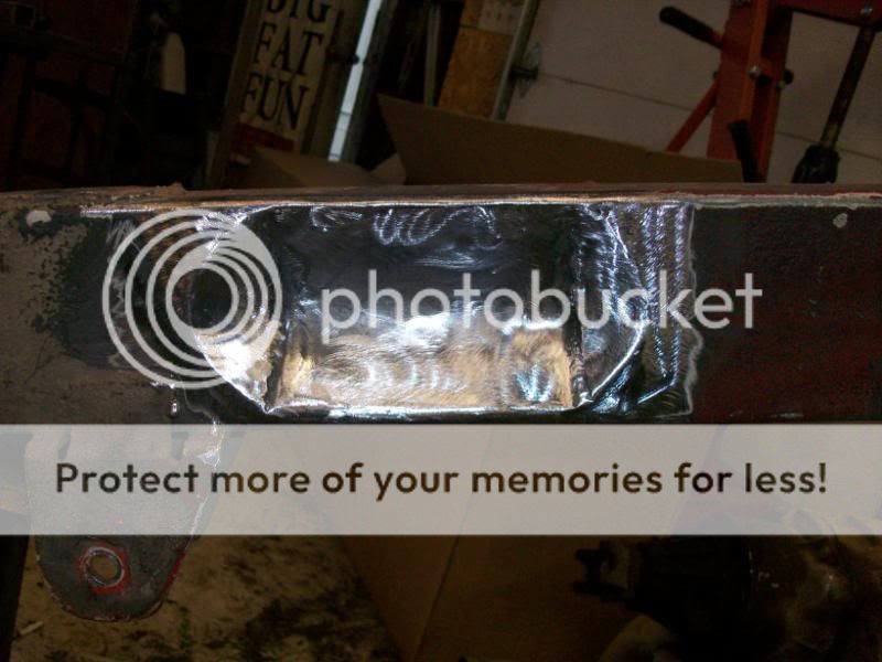

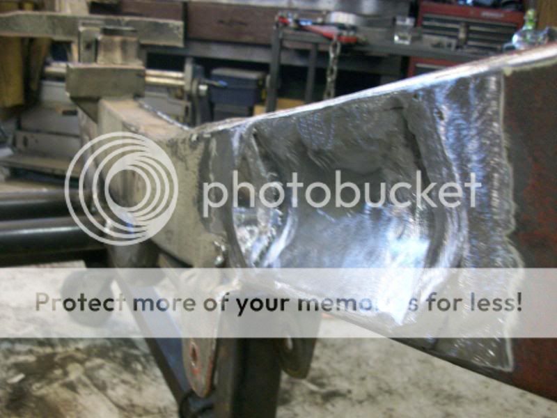

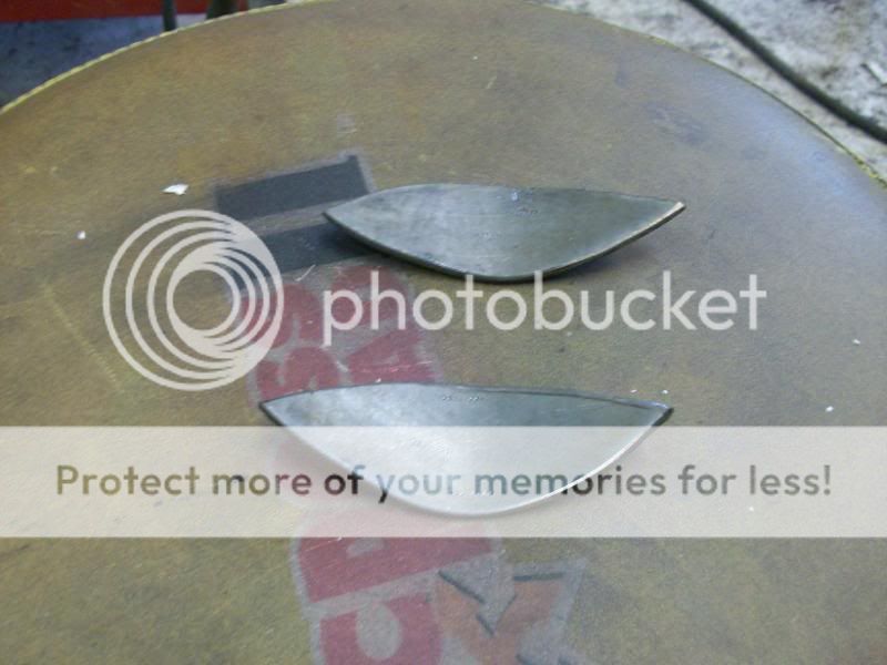

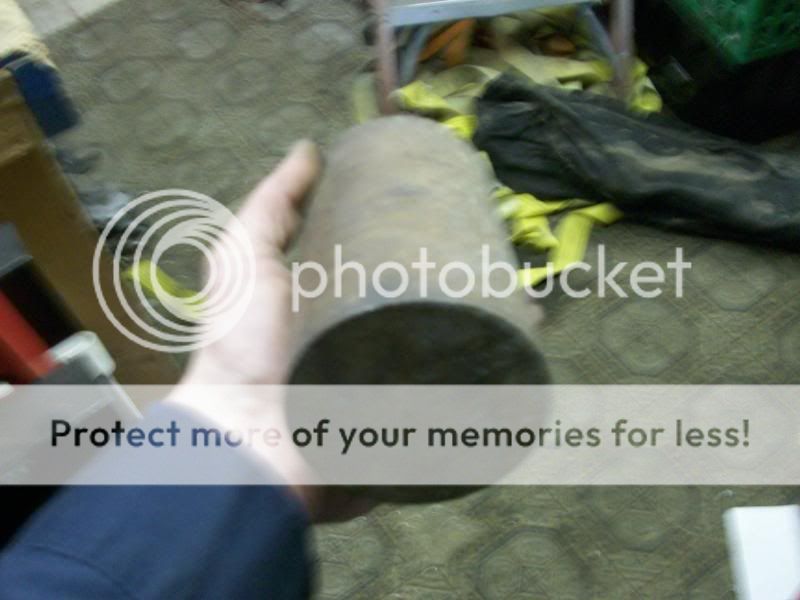

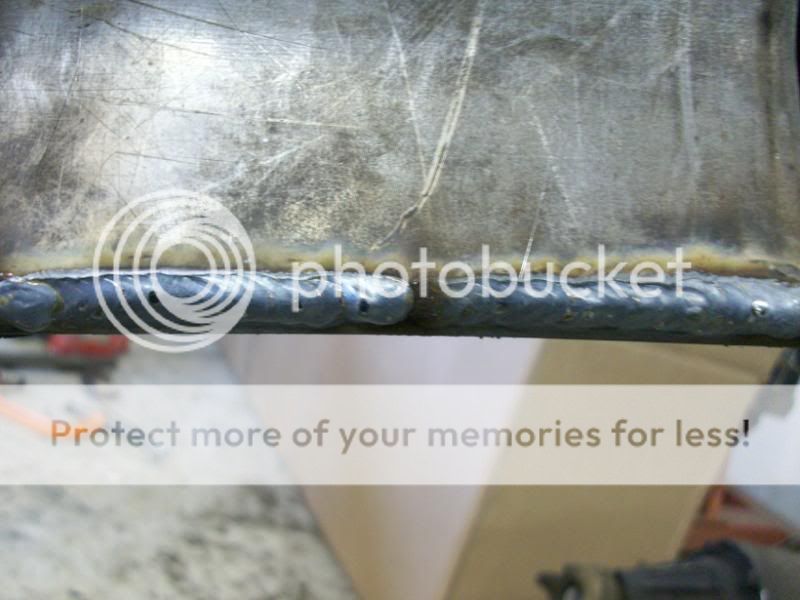

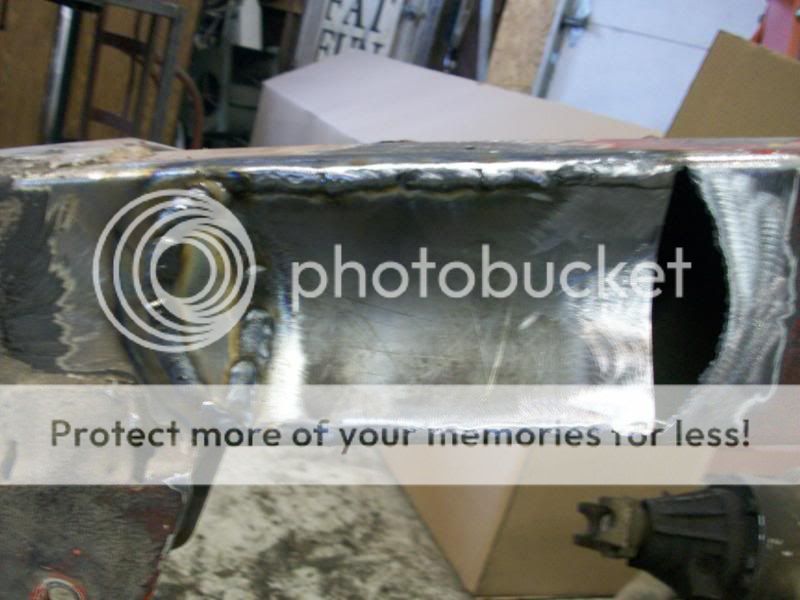

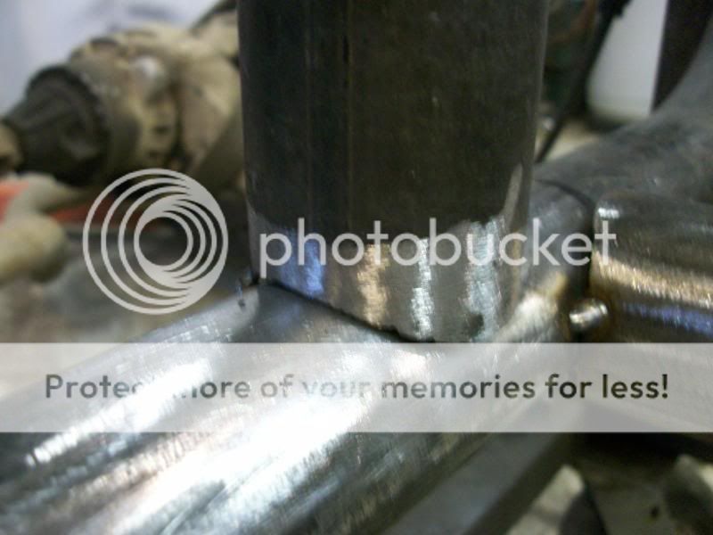

Well, no pictures tonight, just a bunch of welding. :icon_welder: I got the cradle and plating all welded up, and the start of the frame patch by the starter. I made a template out of cardboard, cut the piece out of 1/8th inch plate, and set it up in the press, with a 3" chunk of round billet steel as the top die, and chunk of steel on either side on the bottom, to give the piece the inward roll I needed. I got this piece welded in, I just need to cut a couple cat eyes and give them a little roll, and weld them in. :icon_thumby:
The starter recess is done. Well, I still need to add some plating around it, but the recess itself is done.
Project Mazzuki
Made the roll with this in the press.

If you can find a 90's model Nippondenso starter, its much smaller. You might actually be able to remove it without lifting one side of the engine up above the frame rail.:D
Its what I had to do to stuff the 318 off in my 69 Nissan Patrol.
