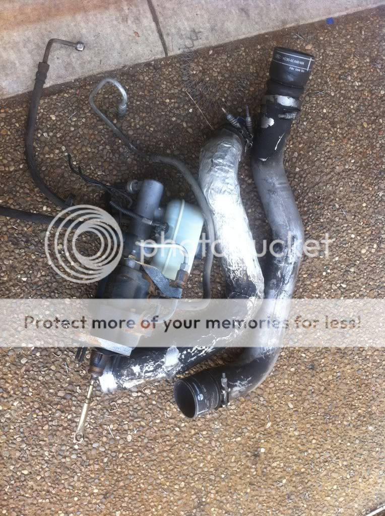

picked up a 2000 psd hydroboost setup and master cyl for $20 bucks and the aluminum intercooler tubing to redo my intake since i moved everything around under the hood for $10

Nice score. That ought to stop you good but dont ever turn the key off while braking lol
Looks just like the booster and MC that I got for mine...Look at my thread, all you have to do is knock out 2 studs and redrill them, and it will bolt right in...

Thanks, just have to figure out what to do about the PS pump now, something tells me I don't think it's got enough shit in it's britches to run the hydro boost and hydro assist.
I would recommend against running the hydroboost and hydro assist. Not a great idea, and you don't need the hydroboost.
hydro assist is already slow even with a good pump, when you are laying on the brakes on obstacles steering will almost be impossible. Just use vacuum brakes.
yea i wasnt sure about it, i knew i was going to use the master regardless and he didnt charge me for it so i just grabbed them both.

If you don't end up using the booster, I could use it if you want to get rid of it...

I would recommend against running the hydroboost and hydro assist. Not a great idea, and you don't need the hydroboost....
Ditto to that. And for what its worth, the setup I'm running ('99 Dodge 2500 Gasser MC and Stock Booster) works friggin awesome for stopping my junk.

i did some searching and with a good pump there are a few guys on pirate running both, but im not sure what im going to do.
the hydro boost has already been called if i dont end up using it.
