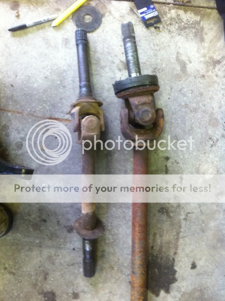

just incase your wondering why i went d60.
one is d44 other is 60, ill let you decide which :thefinger:
