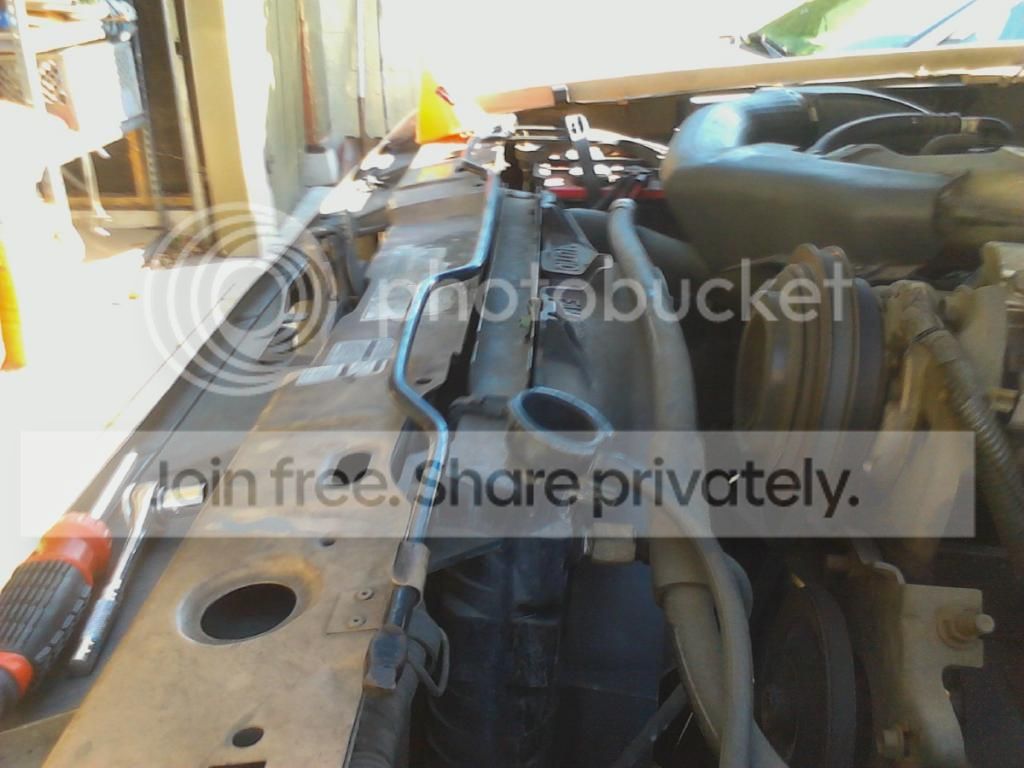

She finally ticked over =D. 200,000 miles and still running strong. So, that weekend I went ahead and changed the oil at work, and decided to top off the radiator while I was there. It was then that I noticed that it was leaking coolant out of the upper trans cooler fitting. Welp, I had been wanting to do a radiator swap for a long time, at that was my incentive.

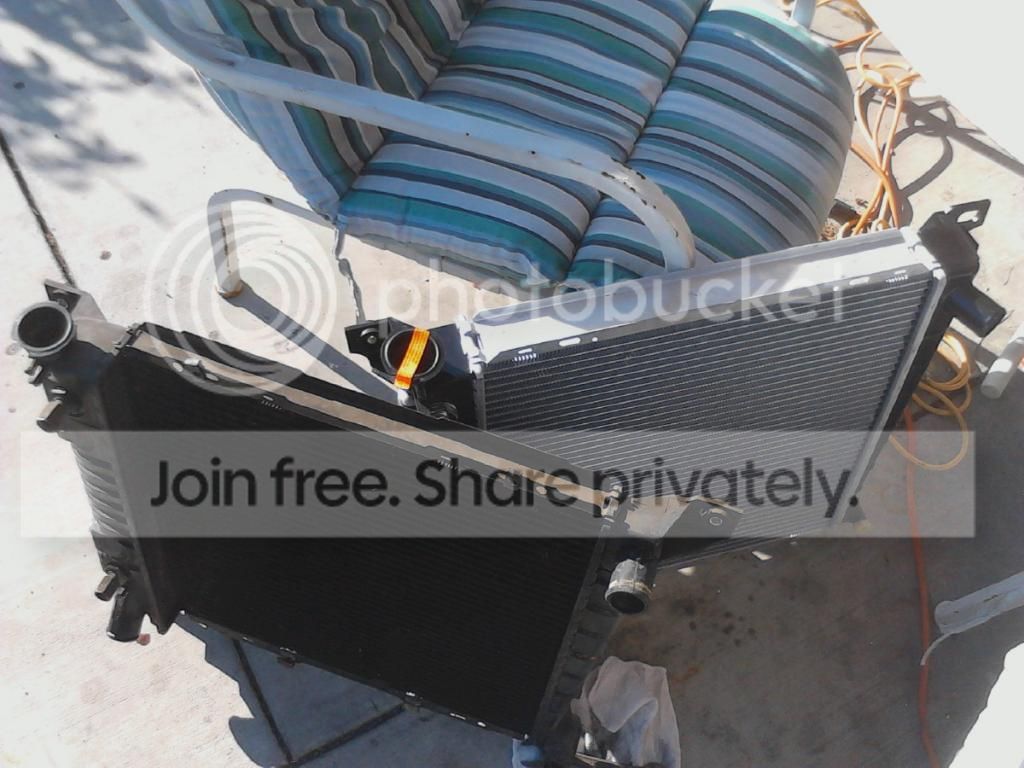

So, the following week when I got paid, I went ahead and ordered one:
That's the new one on the right next to my old one on the left. It's a dual core for a 94 Explorer. Dropped right in, but the clips that hold the bottom of the fan shroud in place don't sit in the same spot as on the old radiator, so I couldn't use those. No biggie, just set a few zip ties down there and it's nice and tight. Plus the transmission cooler lines also help hold it in place, anyway. Also, the upper hose outlet sticks out at an angle, compared to the Ranger's that sticks straight out, so after a few days I noticed the hose was too far back and was being cut slightly by the alternator blades. Just had to shorten the hose by about an inch, and now there's plenty of room.

It's a tight fit (the fan is completely hidden by the shroud now), but it was totally worth it. The truck cools much better, and I feel that we are ready for another boiling summer. If anyone decides they want to do this swap, make sure to add plenty of teflon/plumbers tape to the threads on the fittings. Just noticed that one of them is seeping a bit since I didn't bother to put any on before. Other than that, it's by far one of the easiest radiator replacements I've ever done. Plus it was only 98 bucks brand new, haha. Definitely worth the peace of mind knowing it cools far more efficiently than it needs to.
