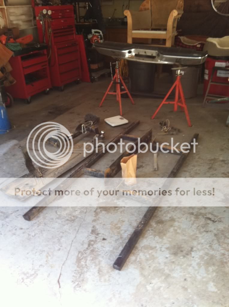

This is my prep for this weekend when I monsterline the rocker panels.
Wanna see what eliminating 175 pounds looks like? Removed the rear bumper, hitch, L and R sliders (and subsequently the gas skid too). I ended up with 2" of rake, a crappy ride, and lots of clearance. Also I wire wheeled the outside frame rails and primed and painted them with Rustoleum. I figure while the sliders are off, I won't put them back on without bracing them up with some cross links/gussest and repainted them. They need it! They have had 2 hard years of use. Also the rear bumper won't go back on in the chrome flavor. I will grind it down and paint black. FYI the brown bag has $90 in grade 8, 1/2" hardware that fixes the sliders to the frame in a semi permanent fashion.
Here:

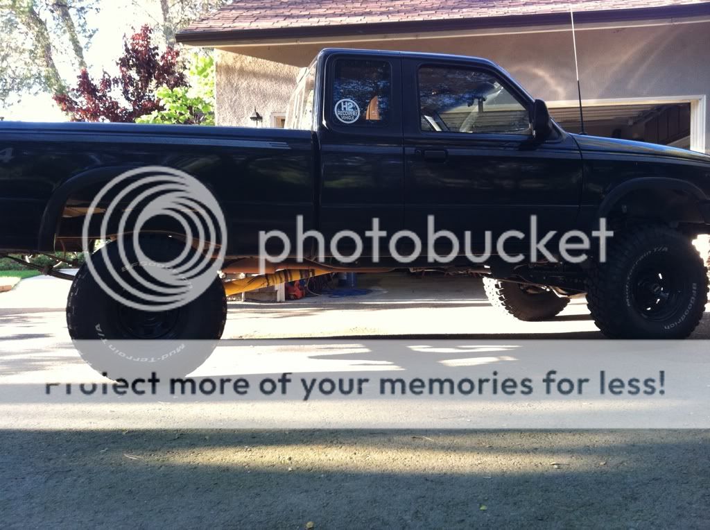

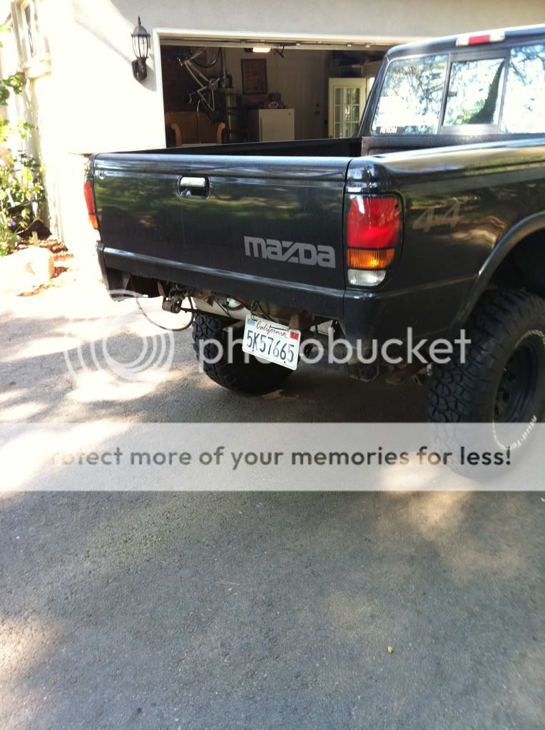

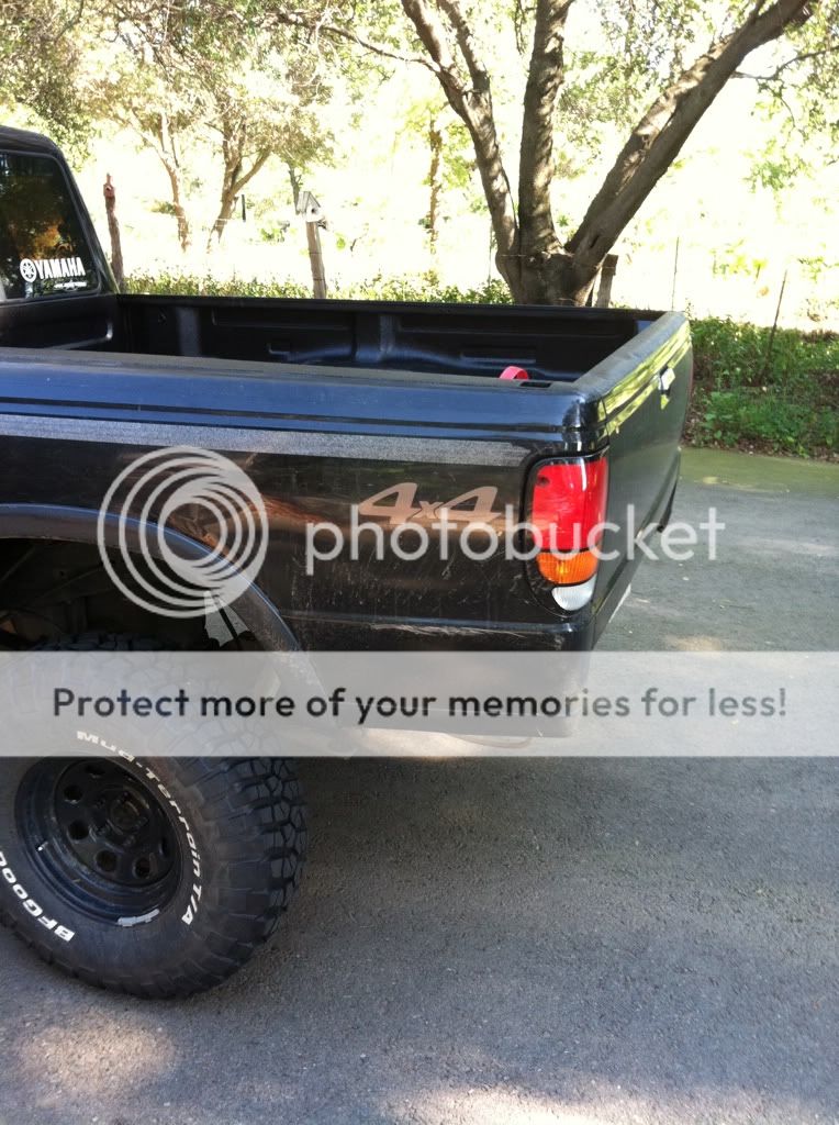

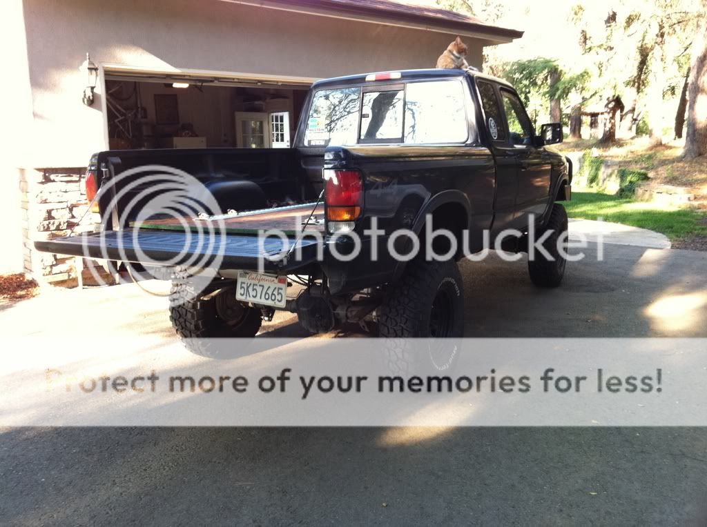

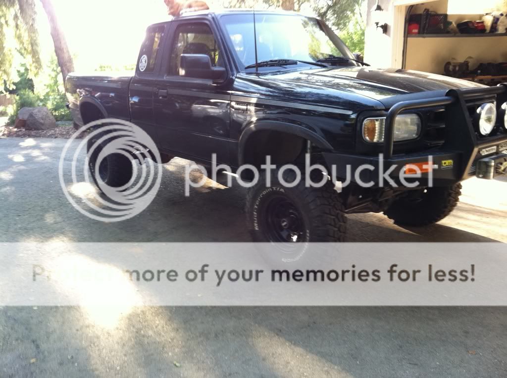

She's naked:
Project 4x4 Commuter Mazda
