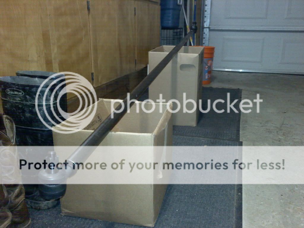

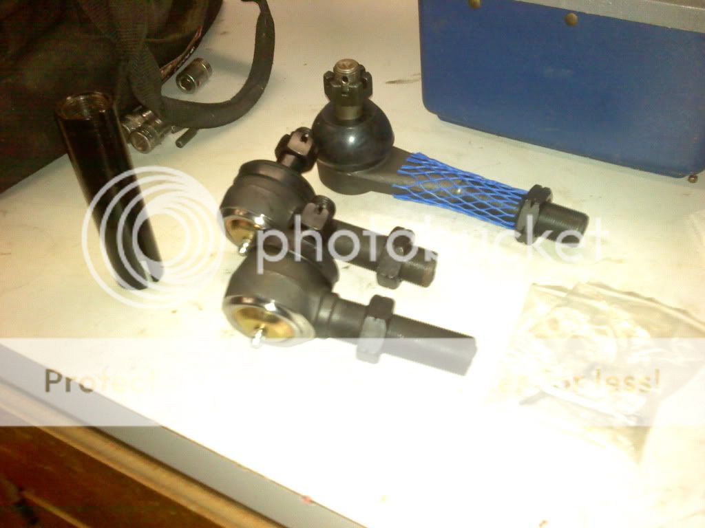

Next week (:icon_confused: hopefully) I'll be able to pick up the 3 TRE's, and tubing for my steering setup from WFO in Auburn. Within two weeks I hope to be driving around with a little less bumpsteer and a whole lot stronger of a steering setup that won't eat draglinks every 10K miles...

My 6' of tubing, going to be cut into two pieces.

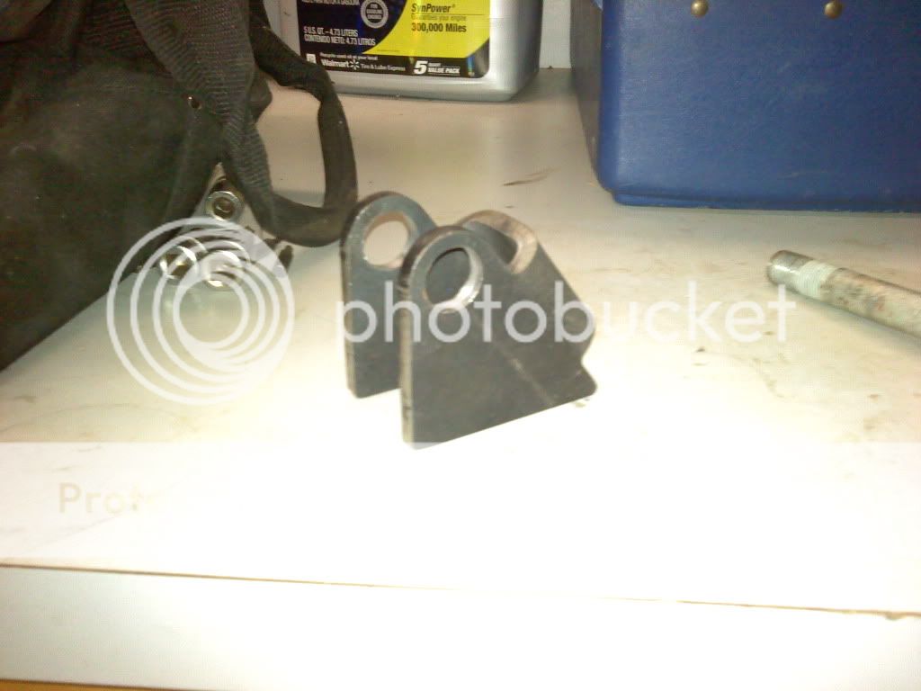

I have one last thing to buy, and that is the 1" bolt for the bracket/heim. With that my grand total is $360 or a little less, I'll know today.
$100 TRE's
$100 Tube, tapping
$25 bracket
$25 for heim/jam nut, weld in bung, spacers
$15 for the adjusting sleeve
$80 Xcut 1 ton chevy reamer
$15 (or less) for the pivot bolt.

why are you regular tie rod ends instead of heims?
