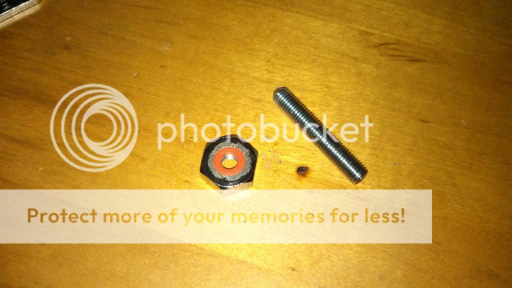

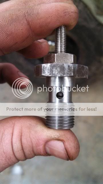

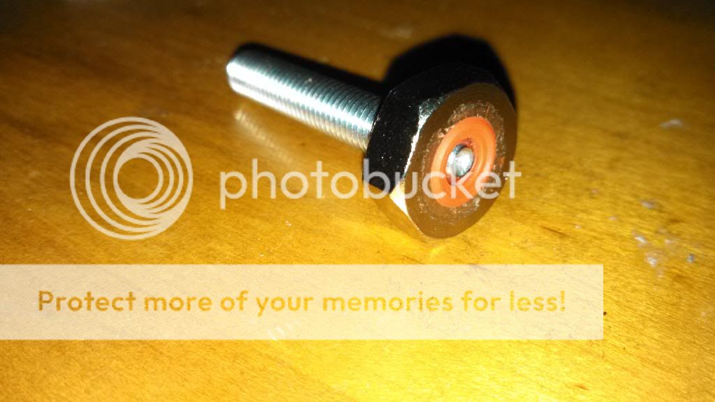

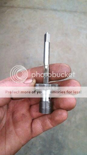

Still making some cavitation noise, so I made up my own way to adjust the flow.
Picked up a 1" long 5/16-24 set screw and a nut with a built in sealing washer. Then I drilled out the Banjo bolt and tapped it. This way I can meter the flow down by closing off the holes with the set screw.

Necked the flow down a hair and it quieted down a bit. Still a little whine at higher RPMs.
