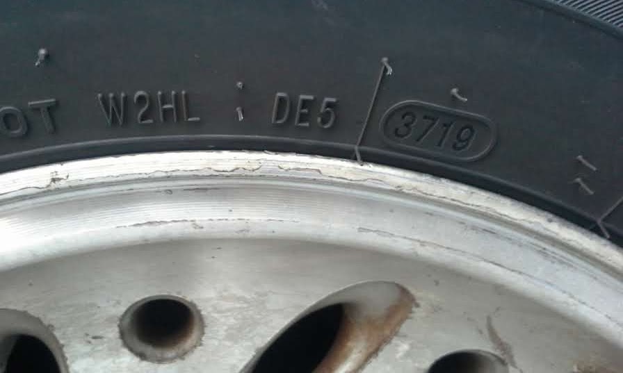

Having trouble w/ ancient Android and Photos, but the Load *Index* (not Range) is 108T...? NO letters at all after the P235/75 R15 text.
See pic for other markings:

The 3719 you show, says the tire were produce week 37 of 2019; not yet a year old.
