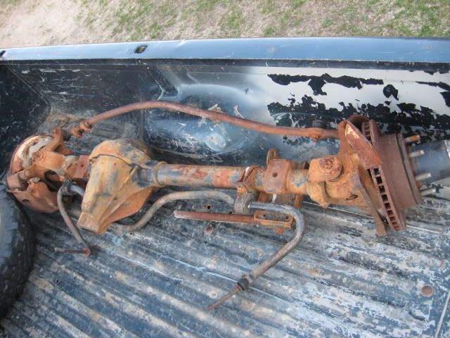

HP D44 out of a '79, F/S Bronco(pulled by Warrlord/Thumper113)

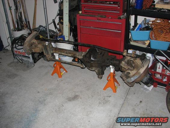

These will go into my Ranger( as soon as I'm convinced the 347 it right and I get off my lazy rear-end)

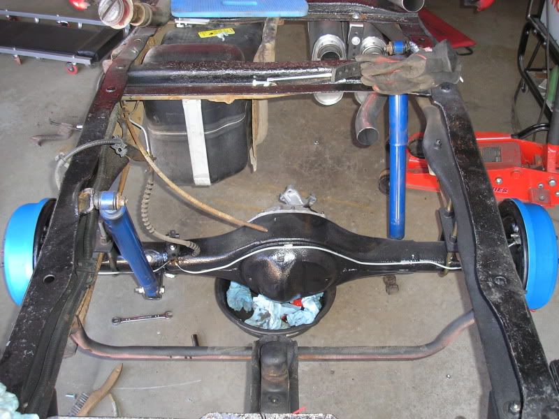

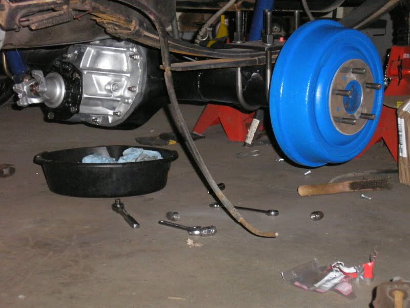

Ford 9"
shortened a total of 9"(4 1/2" each side), from a 1978 F-150, swapped the 2.75 gears for 3.89. New end flanges are from Quick Performance Racing. Ford Racing 11" drums(still get to keep the 5x4.5 wheel pattern). Drain hole was added as was the new shock mounts.
This was actually one of the easier setups that my brother and I tackled. As long as your math is right, everything should come out nicely.
No more weakness, no more c-clips or rear diff covers.:yahoo: Perfect!!!!:icon_thumby:

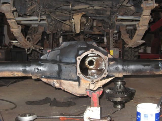

Here is a SRW 14 bolt (prior to 1988) that has been shaved 1.75"s ( the housing is upside down in the pic)

And bolted under with a modified Ruff Stuff diff cover

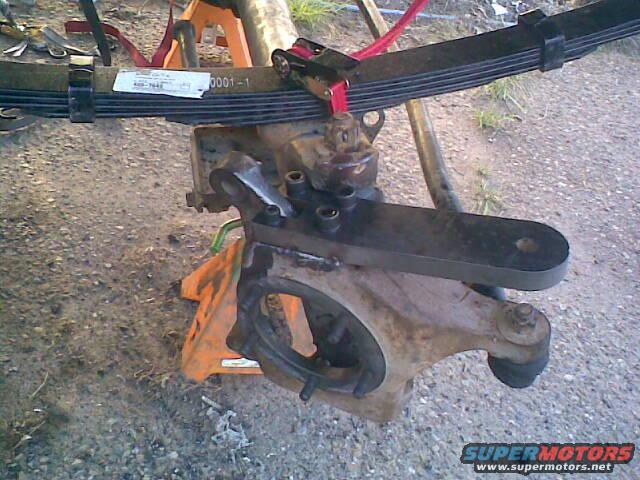

Home made hi-steer arms on the balljoint knuckles:

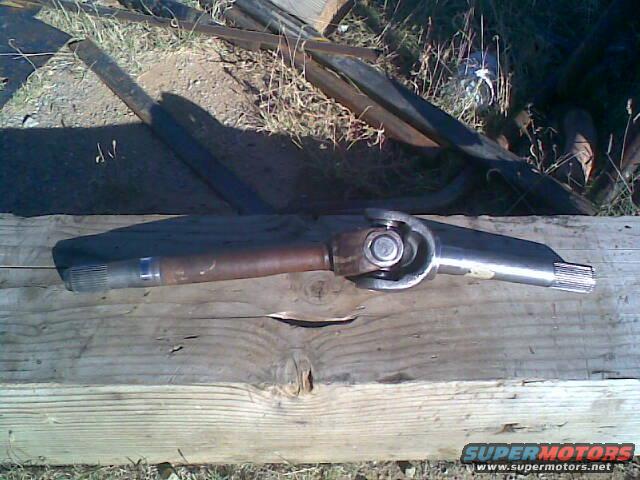

35spline pr0n:
