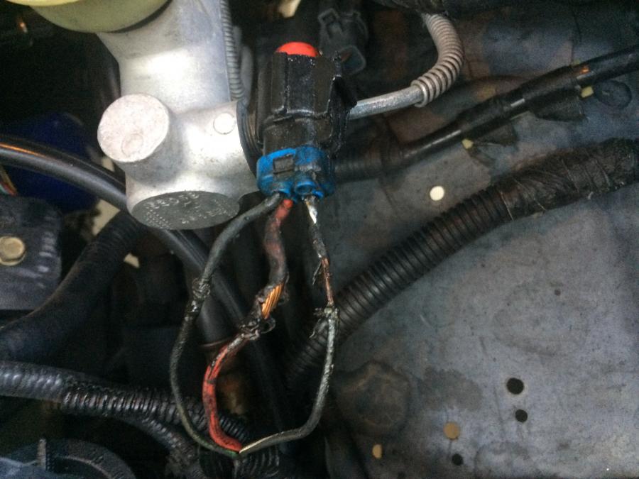

WOOOOOOHHHHOOOOOOO Found my shorted wire, not even sure what it's actually connected to but once I found her she started right up!!!
Man, that is/was ugly!!!
I think I would go over the rest of wiring. :popcorn:
I'm planning on going thru the entire harness to verify, found bare wires on the CKP connector when I changed that. 20yr old harness is the desert has stood up well but definitely giving in to the age and temp.
I did secure harness better throughout the engine bay to prevent anything in the mean time. This guy was wedged under the power steering pump and arcing on itself along with the hardline section of power steering hose.
This particular one was easy, was able to cut back wire, resolder and heatshrink. Tucked back into loom and electrical taped the loom. I'm sure I will find others too, just very thankful this was easy to find and repair, to be honest was dreading coming home and doing it.
