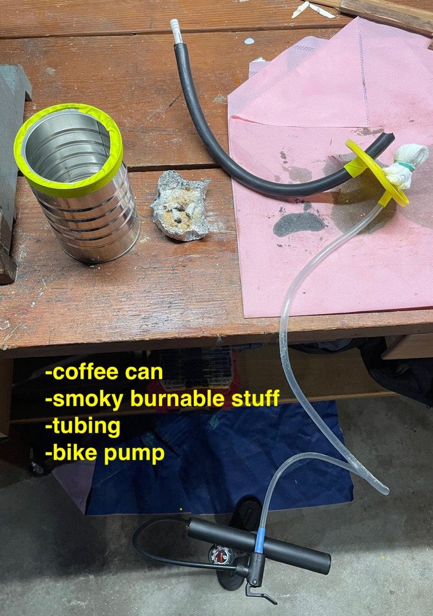

hey there, I don't have diagnostic advice but I just wanted to drop off an idea for a *super diy* smoke tester that helped me confirm a vac leak in my 4.0 recently. I know there are a bunch of tutorials out there but this was quick and dirty, didn't cost me anything, and could obviously be adapted to what you have on hand. not saying it'll work for everyone, but just in case...
it's basically just a coffee can, some tubing poked through the lid and superglued, and a bike pump (with a pressure gauge and changeable nozzles). there is gauze around the air inlet tube to diffuse air/catch moisture. gathered some random stuff to make the smoke. to light it, I dropped it in the can and used a torch to get it going and then smothered it quick. plenty of smoke. obviously not the cleanest but it took less than a minute to find the leak. (alot of videos suggest a cheap cigar.)
I disconnected the air intake from the filter box and blocked it with a nitrile glove, which also helps see the air pressure. disconnected vac line from the intake at the brake booster, and plugged smoker outlet into that line. inlet smoker hose to the bike pump. (you could use different kinds of pumps or probably just blow in it) ... then pump and watch. I had a drop cloth over the hood and used a flashlight, and it was easy to see the smoke finding its way out pretty quickly.
