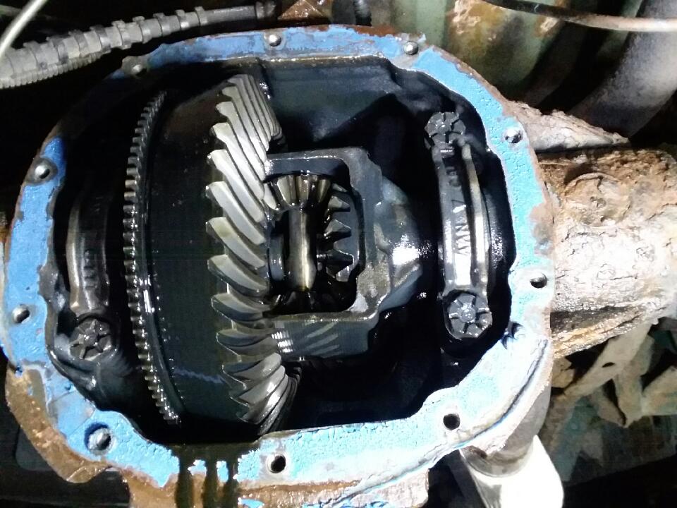

I know the pic isn't the greatest but the main gears looked perfect. No sharp edges, gouges or anything like that. My plan is to put the impact on the pinion nut again and see if that changes anything. If not, I've been trying to find a good rear end but haven't had too much luck other than ones that are $300 and up.

For what?
Its a colored ink the you spread on the gears. Turn the gears and you can see how the teeth interact. I've never got that far with gearing in mechanics so can't help any more than that.
I don't think it's going to tell you much. It's used for setting up gears, it would give you an idea of their contact pattern but it won't help find a bearing noise.
If the noise changes with throttle pressure it's probably pinion bearings, carrier bearings would change with speed and wheel bearings would change with speed and when swerving left to right to load the bearings. If it need any bearings change them all because they're all running in the same gear oil and metal particles from the failed bearing are floating in it, also thoroughly clean out the housing before reassembling. If you change only some of the bearings and have to take it apart again next month remember: I told you so.
