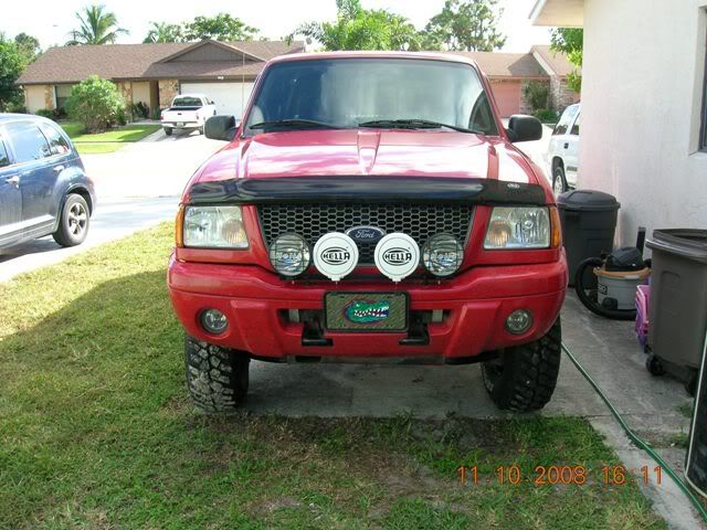

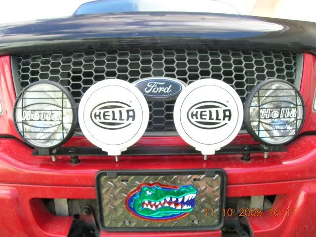

Universal light bar from JC Whitney for the front facing lights. The rear lights are just bolted through the roof.

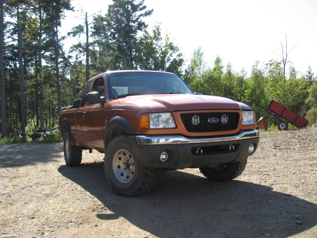

How well do the lights do behind the grill like that?

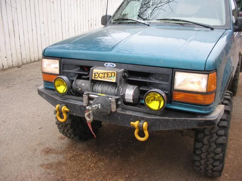

2 mounted on the safari bar, and 2 mounted to tabs bolted to the lower rad support.
you'd never notice the 6 tiny bars in front when there on, but you don't notice them so badly while there off. Just what I wanted.

On mine there were two existing holes behind the grill on each side. I took a piece of steel and went under neath the grill. That picture looks pretty close to what I did.
