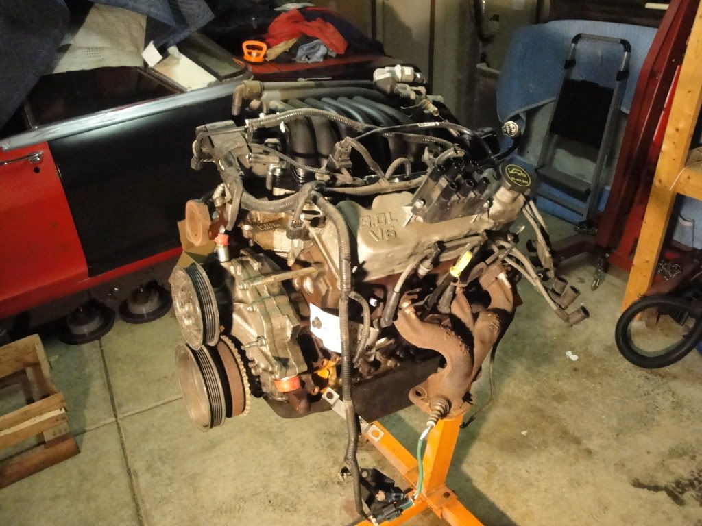

These pics are a couple weeks old now, but I haven't had time to take any more, so they'll have to do for now.
Donor

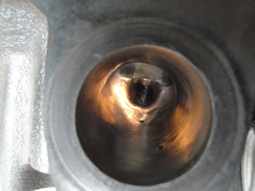

Cylinders after 96,000 miles

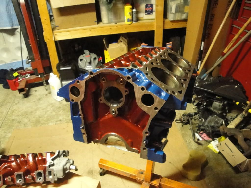

Got it torn down, cleaned up, and painted

The block and pan were both painted Ford blue.All of the surfaces that oil will touch, including the underside of the intake, lifter valley and inside of the timing cover were painted with an oil resisting, thermal paint called Glyptal to keep oil running back to the pan, and hopefully keep the intake charge a little cooler. I'll post more pics before the heads go to the machine shop!

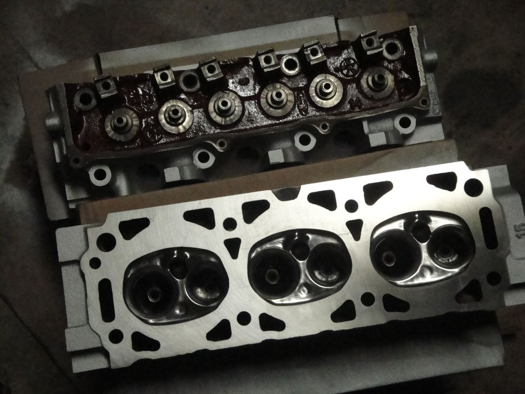

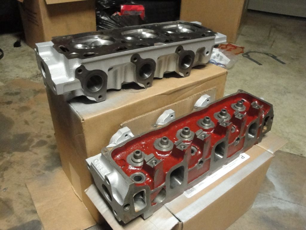

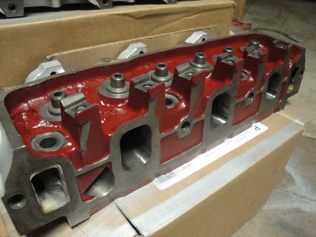

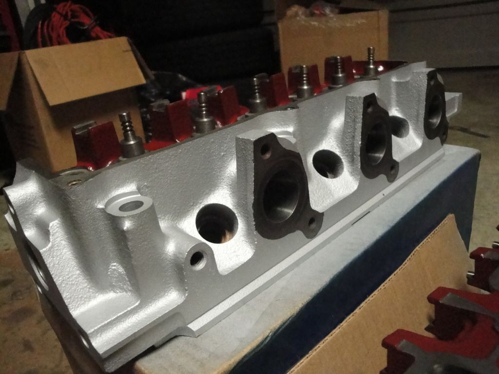

The heads are finally done!
Before and after pics of the heads:

After my P/P job:

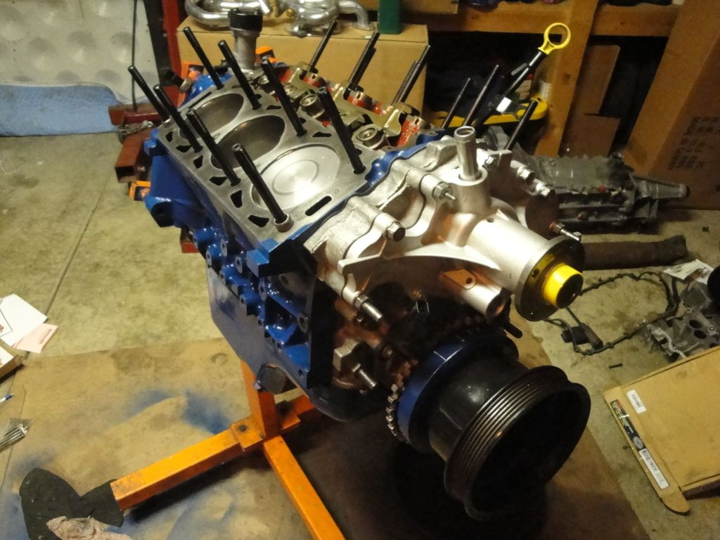

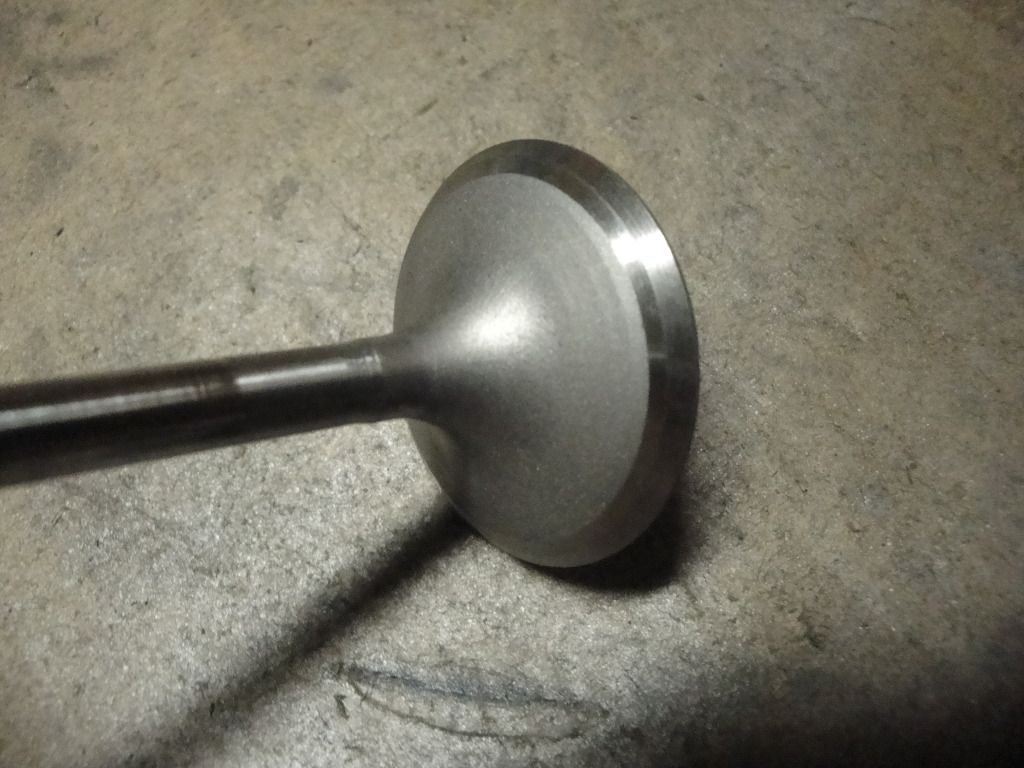

Sent them to the machine shop for a 5 angle valve job and back cut. Got them back a couple of days ago, and pretty'd them all up!

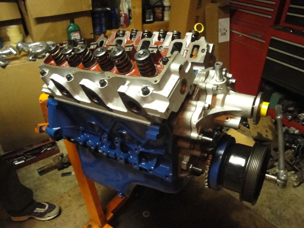

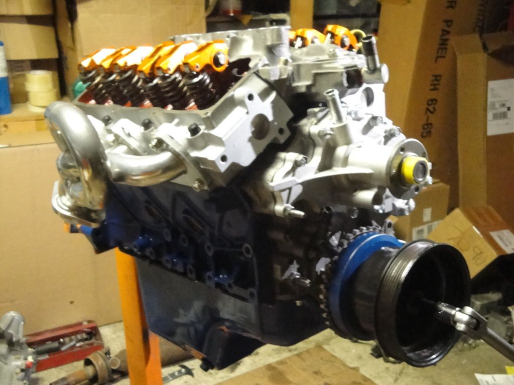

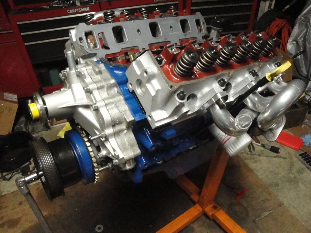

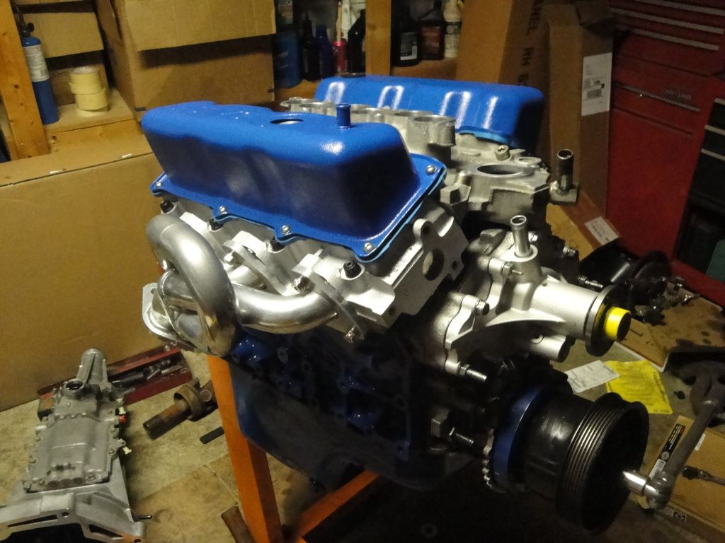

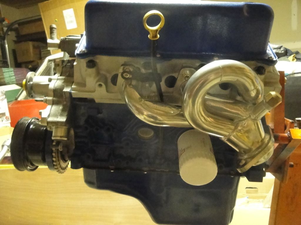

Started throwing parts together last night.
