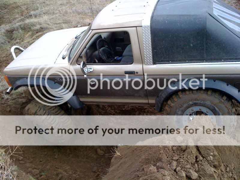

how is the d44 and 9" holding up to the 38s? where all do you go wheelin out of dayton?
axles are holding nicely. I have upgraded the shafts from the 70s metal to superiors in the rear and a warn long side and stock half ton short side and outers. sence the 4.0 and the doublers i have upgraded to 39.5 boggers.(twice the tire and well worth twice the price.)

i'd like to see more detailed pics of the soft top. Killer B2. I actually have a pic of it in my "B2 slide show" screen saver!

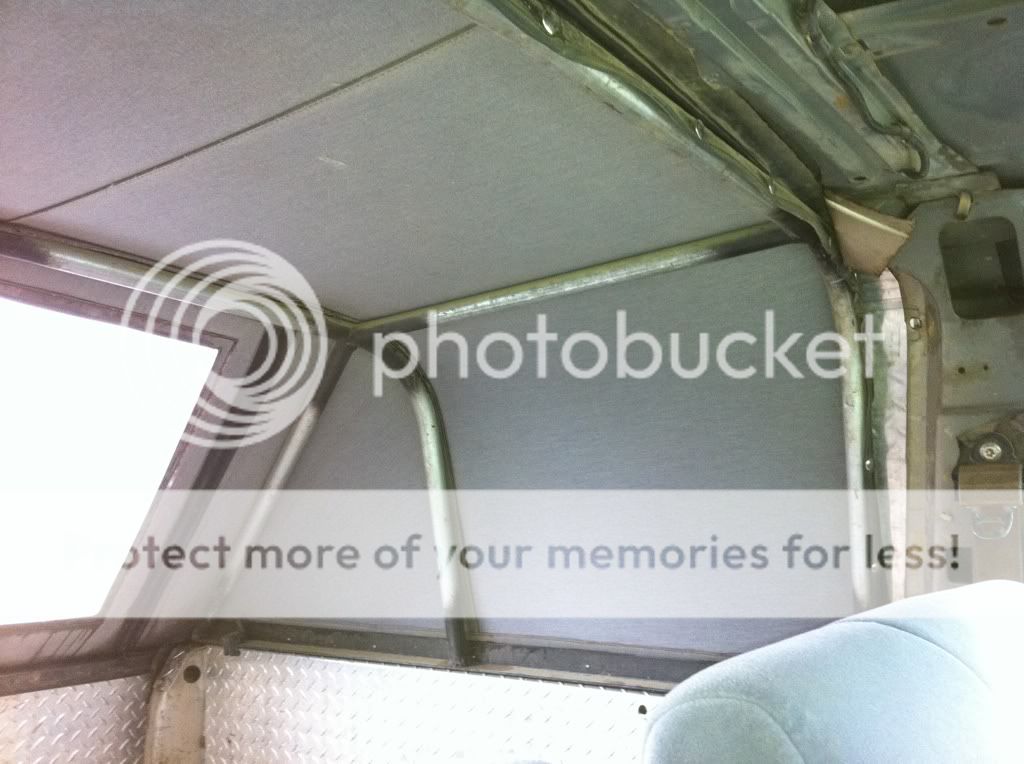

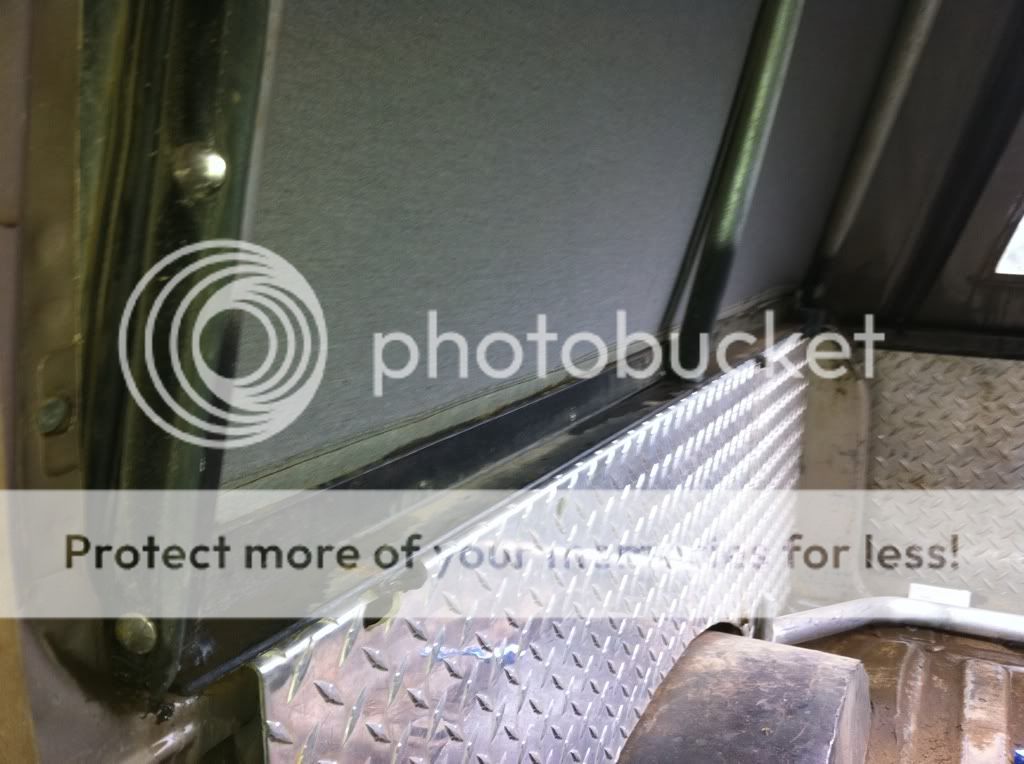

some inside pics of the soft top
the top tucks tight under the diamond plate
thanks for the pics. one of my all time favorite B2's.
