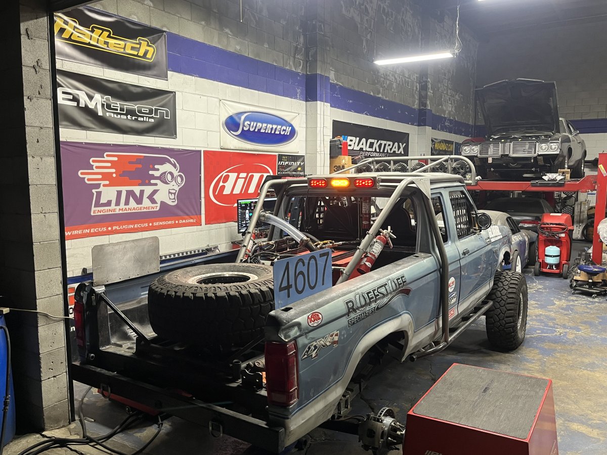

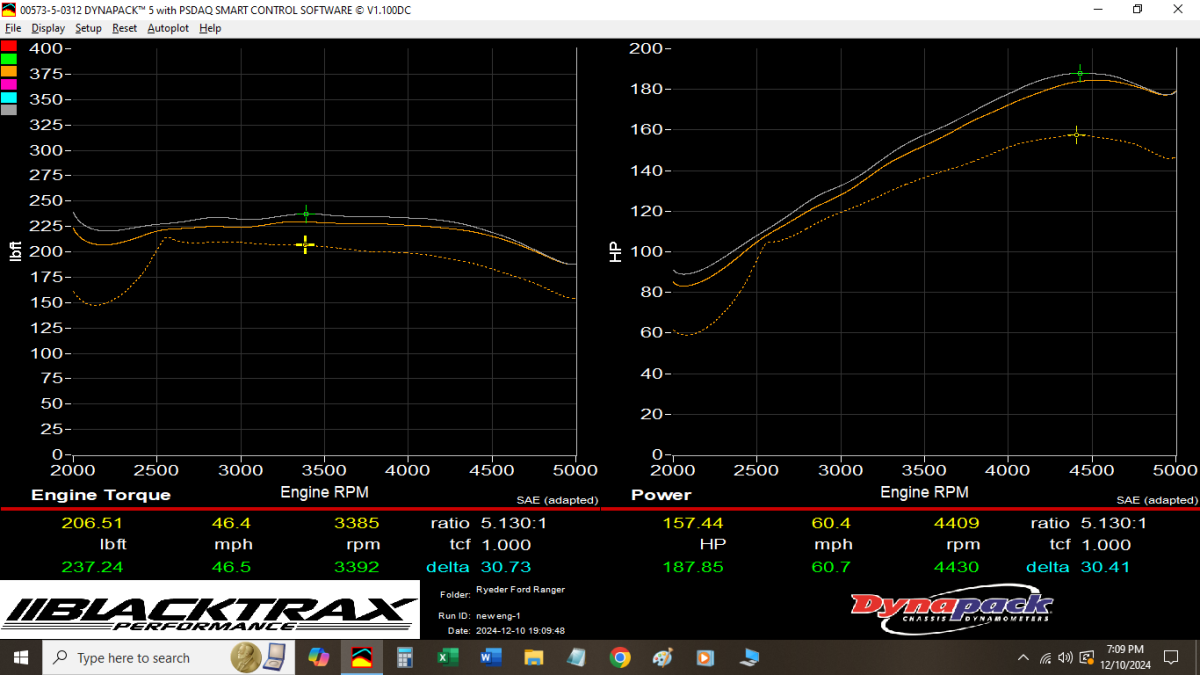

Engine is running, and we have results from the dyno! 187hp, 237tq at the rear wheels. There is a tiny bit more on the table but this should be about 240-250hp at the crank. The exhaust is too restrictive, moving from 2.5 to 3” will help this.
Im pretty happy with this especially considering this dyno result is on a hub dyno, and it’s a 4wd drive truck, a4ld, transfer case and a 9” rear axle. Was hoping for the 200-250 rwhp mentioned in the performance 4.0 build written years ago, but I bet this will feel like a rocket in the desert!

with a non slipping clutch and a manual it would be close to 200. very hard to crack....these engines are not very good at making power....but if you keep them cool they are tuff...
250 is about all these can do with sane money...

Are you saying 250 at the crank or wheel?
I’d be willing to bet with a 2wd manual trans and a factory 7.5 or 8” this engine would definitely be at 200. The 9” and the tcase have a decent amount a drag and the a4ld has a lot of loss. Tuner thinks a better/corrected intake tube (has a bit of a kink in the aluminum tubing he thinks is acting like a wall slowing down air flow) and 3” exhaust is going to put it at 190+ at the wheel.
