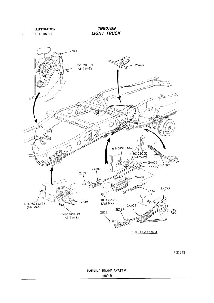

Hard to find much info on these mechanisms though. I did find this, but it's not much...

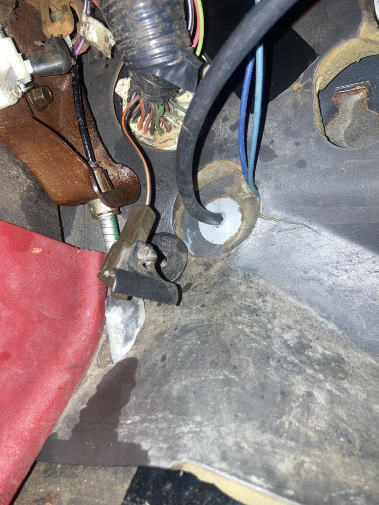

Well gosh I take that back...
Was taking a photo of this mystery black/orange wire with a loose connector dangling next to the assembly to figure out what it goes to, and in the photo I noticed that the cable end is now sitting right there in plain sight. Don't think it was like that before. It's just above that parking brake electronic switch connection.
Earlier today I pulled on the cable from under the truck so as to bring it all the way to the tensioner and hook it up. I successfully hooked it all together at the tensioner while the tensioner was at its loosest state. I was planning to put the nut onto the tensioner bolt tomorrow and try tensioning the system.
But I suppose this is way too slack, and that the cable end needs to be way up into the mechanism somewhere?
If so, I may as well get it back into position using the new cable instead.
This seems strange though, because it was pretty difficult to bring the end of this cable under the truck all the way to the tensioner bracket and hook it up. I can't imagine making this connection if this interior end is supposed to be like 6-8 more inches tucked up into the mechanism.

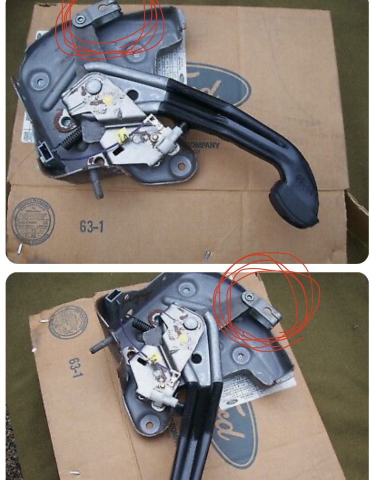

Ok, it really looks like my parking mechanism is easier than I realized.
I found good photos of a 90-97 Thunderbird Cougar mechanism (below) and they sure spell a better scenario. It looks like I have the same little hookup point for the cable end that this one in pics has. See those little hookups? Mine has that too if you look at the pic just posted. With the way that entry hole is designed for the end peg piece, and with the way it swivels as it’s pulled from the cable mount, it’s gotta be the spot the cable ends at. Mine is an 89.. maybe 83-88 all had the older mechanism that had the cable going way up into gears, and they simplified it at the 89 redesign? Mine isn’t exactly the same, like the electronic switch is in a different spot. But that swivel hookup looks like mine.
In any case, I’m going to run with the theory and go ahead and install the new cable this way and see how it goes with tensioning.

Finished the job. Installed the new cable up front. Wasn’t that easy getting old one removed from the hole at the body but got it out. Installing new one was fairly straight forward.
Underneath the truck it was challenging to bring the two connections together but only becuse there was a giant obstruction that I hadn’t realized was some aftermarket plate of metal for something or other. Had been there all along, was hanging from body mount, directly in the way of the parking brake wiring. Crazy to think that someone cares so little about having a parking brake that they added truck mods in the way of it. So I deleted it and then the hookup was easier. Huzzah! Brand new parking brake system including all new rear brakes which had already been done.
Btw the one just pictured is definitely how it works. So for others that find this thread and may be confused by the older version of e brake assembly.. take note of the dangling hookup and see if yours has it. Cable doesn’t go up and into gears like older versions.
